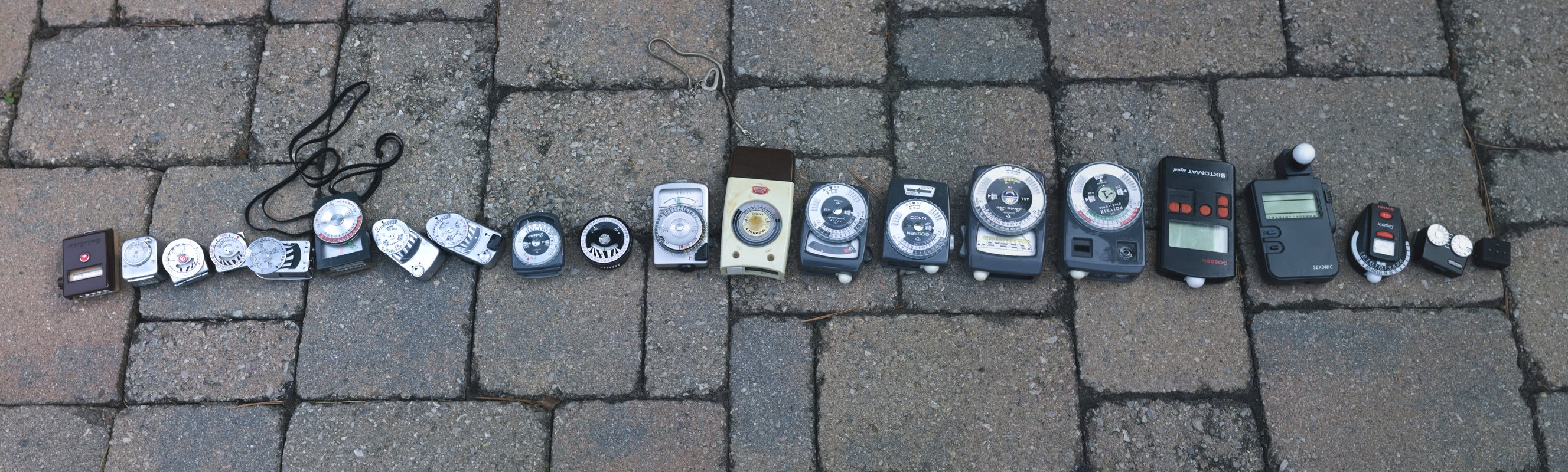

This thread had me look into my "working" meters which surprised me - maybe I have a problem here...
On the left are mostly selenium meters. all of which are working, and most are still calibrated!
The Zeiss Ikophot T was my father's, he bought it in the early '60s in Asia (oddly he bought most of his German cameras in Asia, but that is another story!). It still works perfectly, the entire dial lights up when the reading is correct, so you can read it in low light, where it is accurate.
The Sekonic L86 was the 1st meter I bought, it came with an underwater housing which I used when scuba-diving. It was not very useful as it's sensitivity was mediocre, and it gets dark at any appreciable depth.
Thee Gossen Sixtino is brilliant, small, simple, quick, still accurate. I came with a snap-in incident filter, which I've since lost. Good in daylight.
The Hasselblad knob meter is still used on my 500cx, it's made by Gossen and works perfectly.
The Gossen Luna-Pro is an industry standard. This one has been converted to silver oxide batteries, I have the spot attachments too.
The Gossen N100 and Polysix use a Wheatstone bridge circuit, so you can use any battery. The PolySix has reflected, incident, and variable angle spot meter built in with no attachments necessary.
The digital meters are the ones I use mostly now, you can see the Gossen Sixtomat digital has been through a lot. The Sekinic L318 shown is my second one, I also have the flash meter version, but unfortunately it failed (and I'm only showin working meters), but it porbably has been ny most used meter.
The Digisix is brilliant with Hasselblads (or any L-value shutter), except the battery is always dead. The functionality is great, but the small size makes reading the dial difficult in later years when you near sight does not match your far sight. The buttons are exposed, so if you carry your meter in your pocket, or in a camera bag, it's constantly turned on until the battery dies.
The Voigtlander VCII is exceptionally made, but I never really got along with it.
The Reveni is the lightest shoe mount around, but I've not had good consistency with it's readings, I think it's too sensitive to IR.
Missing is my Minolta III, which is excellent, it's a little on the larger side.
Digital meters are nice, because you can press a button and have the reading, you don't have to read/null a needle and transfer that to a dial, then read off that dial.
If I was buying a meter now, I'd probably get the Sekonic 308, small, light, reliable, no attachments needed (I'd rather not be fumbling and losing attachments), there is a reason it's still on the market after 30 years!
If I need a spot meter, the Pentax Digital is the one. Although I think the iPhone is just as good.

Nice collection! Where did you find a functioning Leicameter-M? All the ones I have seen in the last 5 or 10 years were kaput. Many (most?) of the Leicameter-MR4 CDS meters are ruined now, as well, because of leaking batteries and internal corrosion.
I agree that the Sekonic L318 is handy and easy to read. The clumsy part is you need to change the incident dome with a reflected unit if you change from one type of measurement to the other.

Where did you find a functioning Leicameter-M?.... <snip> .... Many (most?) of the Leicameter-MR4 CDS meters are ruined now, as well, because of leaking batteries and internal corrosion.
I'm sure my Leicameter-M is no longer accurate, I have not checked it in 10+ years. The intention was always to replace circuit with a silicon cell, but the MR4 is better (cleaned and converted to Silver-Oxide cells), and I don't have a camera that they fit on anymore.
Which exposure meter app do you use on the iPhone?
Been using this one for years
, but I have not checked for newer apps. I don't use a spot meter much, and this does everything I need (EV, color temp, etc....). If I used a spot meter more, I think I've would have bought the Pentax Digital by now.
