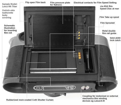

One thing I will say though, for those of us who bulk-load our film, unless we cut the film leader exactly the same way prepackaged film is cut, the load and take-up process for the Leica SUCKS. My Nikon and Canon cameras have zero problems taking my hand-cut leaders. Those same leaders in the Leica? Forget about it. What a pain.

After you load your film make sure that the rewind crank is turning as you crank the film advance. If it is, then the film is being advanced properly. If the rewind crank isn't turning then the film is not advancing properly.

Watch a couple Internet loading demonstrations .I fought it at first. Now I can just drop the film in the camera, follow the diagram. I drop the film in crank it just a wee bit to get tension on the film. Put the bottom on, crank it to make sure that the rewind crank is turning. Advance to zero and go. I don't fiddle with bulk loading any longer. The M6 series isn't fussy you just need to learn the tricks.

No tricks are required. Drop in the film cassette, pull enough film out so that the leader is wirhin the tulip (as shown in the diagram in the camera), reattach the baseplate and fire off a few frames until the rewind knob is turning. That's it. I've done this for years on my M4 and M-A, both of which have the same loading mechanism as the M6, and have never mis-loaded a roll.

Indeed, it's not so much about learning tricks as it is about reading the manufacturer's directions and very carefully following them....and then you just have to develop faith that the magic take-up spool thingy works (eg not dick around with the rewind knob at the beginning)...at least that's what helped me. I too had a devil of a time with loading the M6 starting out and still screw up once in a while but I've learned how to discover it before reaching frame #40. :smile:

Hand rewind your film first, then the rewind knob will start turning earlier. Most cameras require two frames minimum, but if you don't see the rewind knob turning you might not have confidence at that point. Some cameras have better loading systems than others.
Buy a leader template and the shape will always be correct and load correctly.
That's how it works with my M4-2, M5, M7, MP, MA, MdA...
But that is with regular production length film leaders. Perhaps it is different with roll your own bulk film? I know that if I trim the leader off I couldn't load it in my MP. (The film broke at the beginning in a different camera that was defective, so I unloaded it, cut off the broken bits, and tried to load it into the MP. No problems using it in a 'regular' camera).

Instead of tricks, I should have said, look at the diagram on the camera. Voila!
Not so fast, buddy! :happy:
I follow the diagram exactly for several reasons: 1. I am intelligent enough to follow simple directions (I am a senior technical writer at Square (formerly Microsoft) 2: I have great new glasses that let me see the diagram clearly 3: I have decent manual dexterity.
The fact is, the take up widget was designed for a very specifically shaped film leader. If a hand-cut leader isn't wide enough at the tongue or extend to the right length, or the end of the tongue doesn't have a slightly rounded edge, the spinning 3-armed creature in the camera cannot take up the film. In addition, if the cassette is loaded to the normal 36 exposure length, it's packed a bit more tightly than the commercial variety (don't ask me why) which results in additional tension within the cassette. The 3-armed beast doesn't have enough purchase to pull through. On the other hand, my Contax IIa RF, Voightlander Bessa RF, all my Nikon, Canon, and Pentax SLRs have an intelligent take up design which includes tighter insertion slots and cogs that engage the film. The Leica has none of that.

Actually, the Leica does have a sprocket that engages the sprocket holes in the film. I rarely think about it because following the loading procedure outlined in the camera's user manual (and shown in the diagram under the base plate) just 'works', but the sprocket is there. See the right side of the M6 image below...
