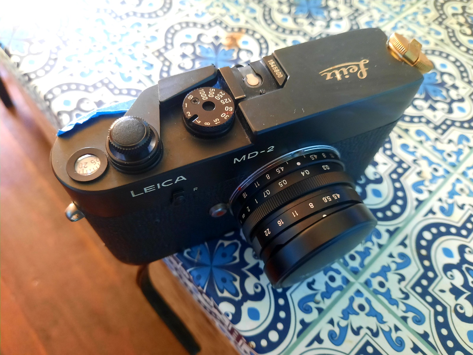

SchwinnParamount
SchwinnParamount
Nov 29, 2004
1,776
Tacoma, WA
I totally mostly fixed the M6 myself. After finally getting the set screw out (took a tiny tiny flathead from Lowes), I got the bent up rewind knob off so now I can load and advance film. I put a new knob on but there is no way in hell I can get the micro-tiny set screw in. This new set screw is an actual Philips head screw and I don't have a screw driver to fit. But the real problem is that my regular human male fingers cannot possibly manipulate the thing into the micro-tiny hole it goes in, let alone screw it in. I'm gunna have to find a special tool whose business end is too small for my 60 year old eyebones to see.
Nicholas Lindan
Advertiser
Advertiser
Sep 2, 2006
4,319
Cleveland, Ohio
... my regular human male fingers cannot possibly manipulate the thing into the micro-tiny hole it goes in, let alone screw it in.
Sometimes a slightly larger screw driver will grip the screw allowing you to guide it into the hole. A wee bit of well chewed gum on the head of the screw/blade of the driver can help grip the screw. Magnetizing the driver blade can let it hold the screw. And don't forget to work on a large fluffy white towel - finding an itty-bitty grub screw that fell of the edge of the table is a pretty hopeless task -- but sometimes a good magnet can find it..

Ha Im not the only one to have bent up the rewind knob. Did it on the first trip out. It was going to cost me about $200aud to get a second hand one, so I made my own.
I think on mine the grub screw was a flat blade, wasnt too hard, even with my shacky Don Knotts hands and sausage finger's. If you want hard try soldering the tiny wires in a phono cartridge on to the connection post without melting anything.

tokam
Nov 7, 2008
596
Sydney, Aust
Another tip for holding tiny screws onto the screw driver while positioning the screw is to dab the end of the screwdriver into a UHU type glue stick used for glueing paper. Just a tiny dab will hold the screw. Works very well for Philips head screws.
Sirius Glass
Jan 18, 2007
50,858
Southern California
There are screw drivers with grippers that hold the edges until the grippers are released.
