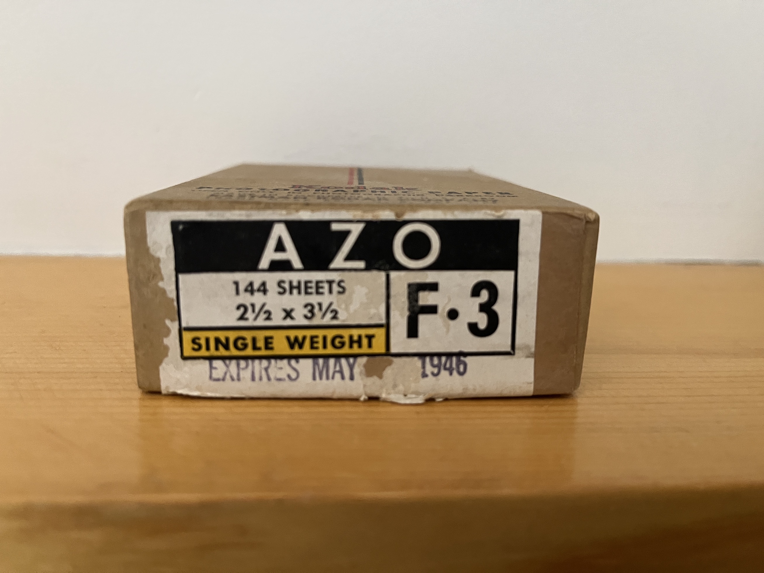

I still haven't tested out the box of 1940s vintage AZO pictured here :whistling:
