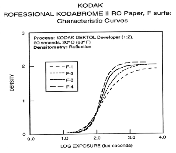

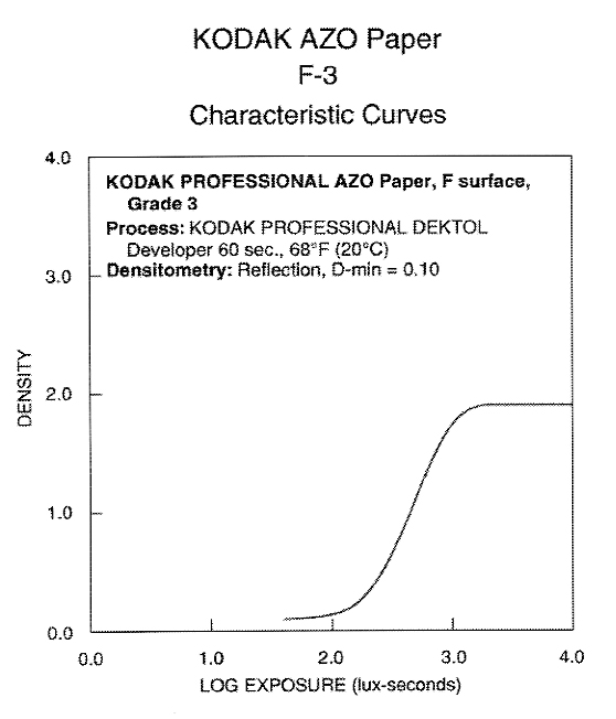

Comparisons of papers
Friends;
There is some difference of opinion over why and how Azo yields unique results. Well, over and above the fact that it is a contact paper and a chloride paper (not really, but yes for all practical purposes....) Here are the curves of Azo grade 2 and 3 compared to an old favorite of mine, Kodabromide.
These curves have been normalized as much as possible on both the X and Y axes so that when printed out, they can be overlain for comparison. If you do this, you will see that the Azo F3 is about like Kodabromide F2 but with a lower Dmax and the Azo has a softer toe and shoulder thus rendering more detail throughout the entire tone scale of the negative that it can capture.
There is no doubt in my mind that expert handling in the process and using Amidol developers with after rinses further enhance the tonality.
Now, I am not an Azo expert by any means when it comes to printing, but I am an expert in reading these sensitometric curves. Ilford MGIV and Kodak Polycontrast were similar to the Kodabromide. They are all quite different than Azo, and these differences go towards explaining all of the "mystery" here. It is no mystery to me. It is by design!

Nice information. I have compared curves of AZO 2 and AZO 3 with curves of a number of other silver papers and there is no question but that the toe and shoulder of AZO is quite different. As you say, there is no mystery to the look, one can see it in the curve if you know how to look.
So far I have not seen a Lodima curve. I did not buy any of the paper because at present I am only working with carbon transfer and other hand coated processes, and I still have quick a large supply of AZO 2 and AZO3. However, if Michael or someone else would send me a few sheets of the new paper I would be happy to test it and make the results available to the forum.
