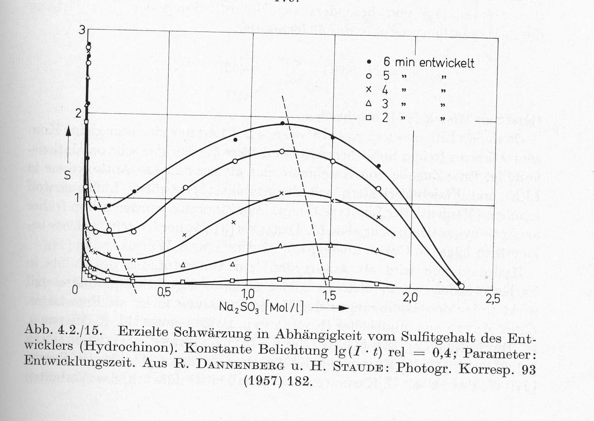

These 2g/l seem to come all from the same original source, but I have not been able to locate / read the publication by Karl Frank.
It would be good to properly analyse the assumptions and conditions under which this figure was originally published - and to what extent experimental testing and further research has been made.
One of the assumptions stated relates to Lith Film researched and not to a Lith effect on conventional photographic paper. Furthermore, I´d guess that a main design criterion was reproducibility at industrial standard, i.e. put film and developer in a black box and after a pre-set period of time take a finished product out, no inspection, snatch point or something similar. Furthermore, I´d guess that short development times were a requirement, too, and maybe the developer was also designed as one-shot product anyway?
Under the a.m. mentioned conditions (highly reactive, short development time to get to Dmax, one shot product, short tray live only), it makes sense to use a minimum sulphite HQ developer, i.e. nothing or almost nothing.
I have found some older research showing the relationship between Dmax and Sulphite content, clearly stating that after a steep decline in Dmax while slowly increasing Sulphite concentration, after a certain point the Dmax actually increases again together with the Sulphite before the developer eventually dies at a very high sulphite concentration. I will try to scan the graph and share tonight or tomorrow.
I had time to scan and upload the graph. Unfortunately, I only have a secondary source, too (from "Grundlagen der photographischen Prozesse mit Silberhalogeniden - Band 2 - Die photographische Emulsion und die Verarbeitung photographischer Schichten", page 895).
The Graph shows the Dmax measured (S like in "Schwärzung") depending on the modification of the sodium sulphite concentration in a HQ only developer with different development times (2 to 6 minutes).
You can clearly see that the highest densities can be achieved with no sodium sulphite at all, but that there is an "optimum" at a concentration of about 1,25 Mol/l (approx. 157 grams / l) of sodium sulphate. Unfortunately, the secondary source does not specify the composition of the HQ developer or material (film/paper) used.
Now I do not think that these results apply one-to-one to lith developers, but they are a strong indicator that the "more than 2 grams will kill the lith effect" is not universal either. Especially if HQ is used in significant excess (factor 2 or 3), there should be no interference.
