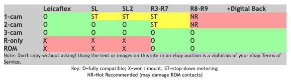

Resources from photoethnography.com
... there are some lenses that can't be used on the original Leicaflex and the Leicaflex SL because Leitz changed the mirror clearance distance with the SL2. The incompatible lenses are:
  • 15mm Elmar-R
  • 15mm Elmarit-R
  • 16mm Fisheye
  • 19mm Elamrit-R, current version (first version is OK)
  • 24mm Elmarit-R
  • 35mm Summilux-R
  • 50mm Summilux-R, current version (older versions OK)
  • 80-200mm f/4.5 Vario (don't confuse this with the current 80-200 f/4)
You should also not use ROM lenses with the Leicaflex series (original, SL, SL2) because the ROM contacts will get damaged by the Leicaflex cam follower. To prevent problems, R-only lenses and ROM lenses have a slightly different bayonet mount so they won't mount on Leicaflex cameras. Don't try to force them on.
  • 15mm Elmar-R
  • 15mm Elmarit-R
  • 16mm Fisheye
  • 24mm Elmarit-R
  • 35mm Summilux-R
Yes, I've seen that info, thanks.
However, the question is: Are there lenses that fit the SL2 but not the earlier Leicaflex models as the magazine article states?

Unless someone can show otherwise, I suspect this part is fiction:
"Leitz ... fail-safed the mount. by lengthening one of the three bayonet flanges on the new lenses. Consequently, lenses designed for the SL2 won't fit the SL or the early Leicaflex, however, all Leitz reflex lenses to date will mate with the SL2."
mrosenlof
Feb 25, 2010
627
Colorado
The ROM lenses and those with only the "R cam" will not mount on the Leicaflex SL2 or earlier. Any of the earlier versions than those two will mount on all bodies. The 1 and 2 cam lenses are Not Recommended on the R8 or R9.
Here's my reference: http://photoethnography.com/ClassicCameras/Lens-R.html
Yes, I know.
Oh, well. I tried. Maybe someday someone here will actually READ my posts and answer the question that was actually asked. Until then ...
