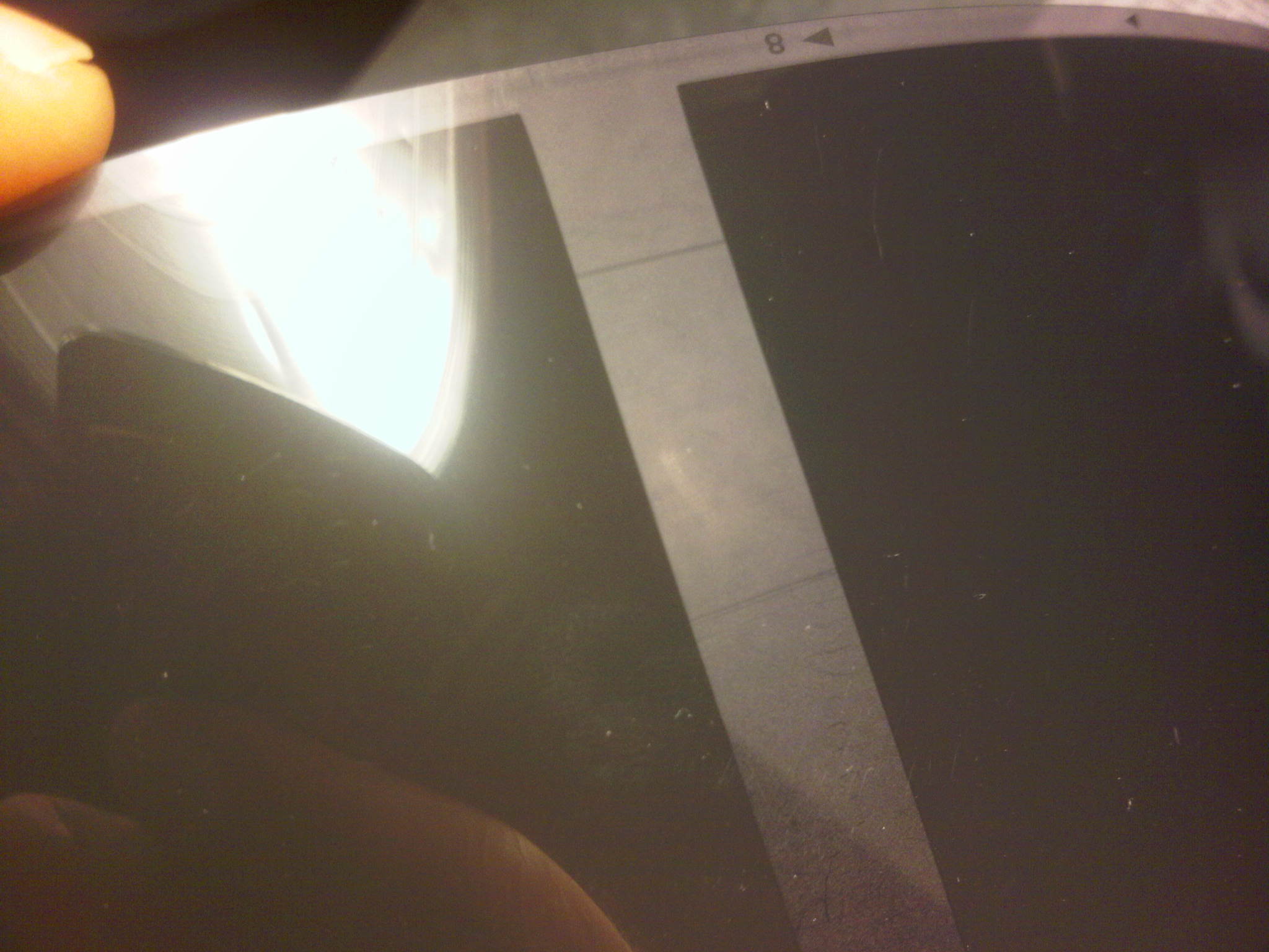

Okay, I did what should have been obvious before and I pulled the film off the light box, if you look at it from an angle the lines are really more visible. You can see it in the first attached picture here.

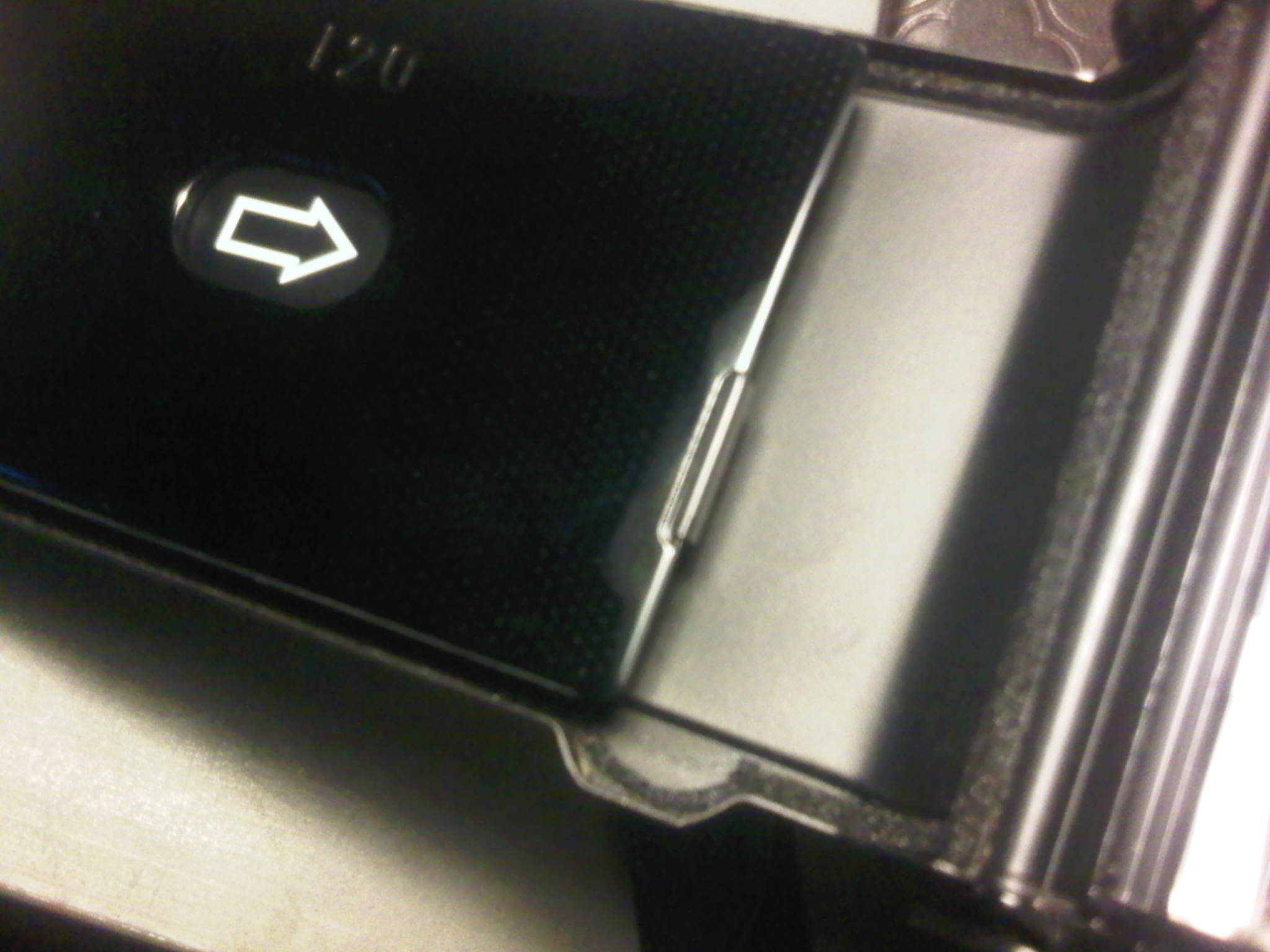

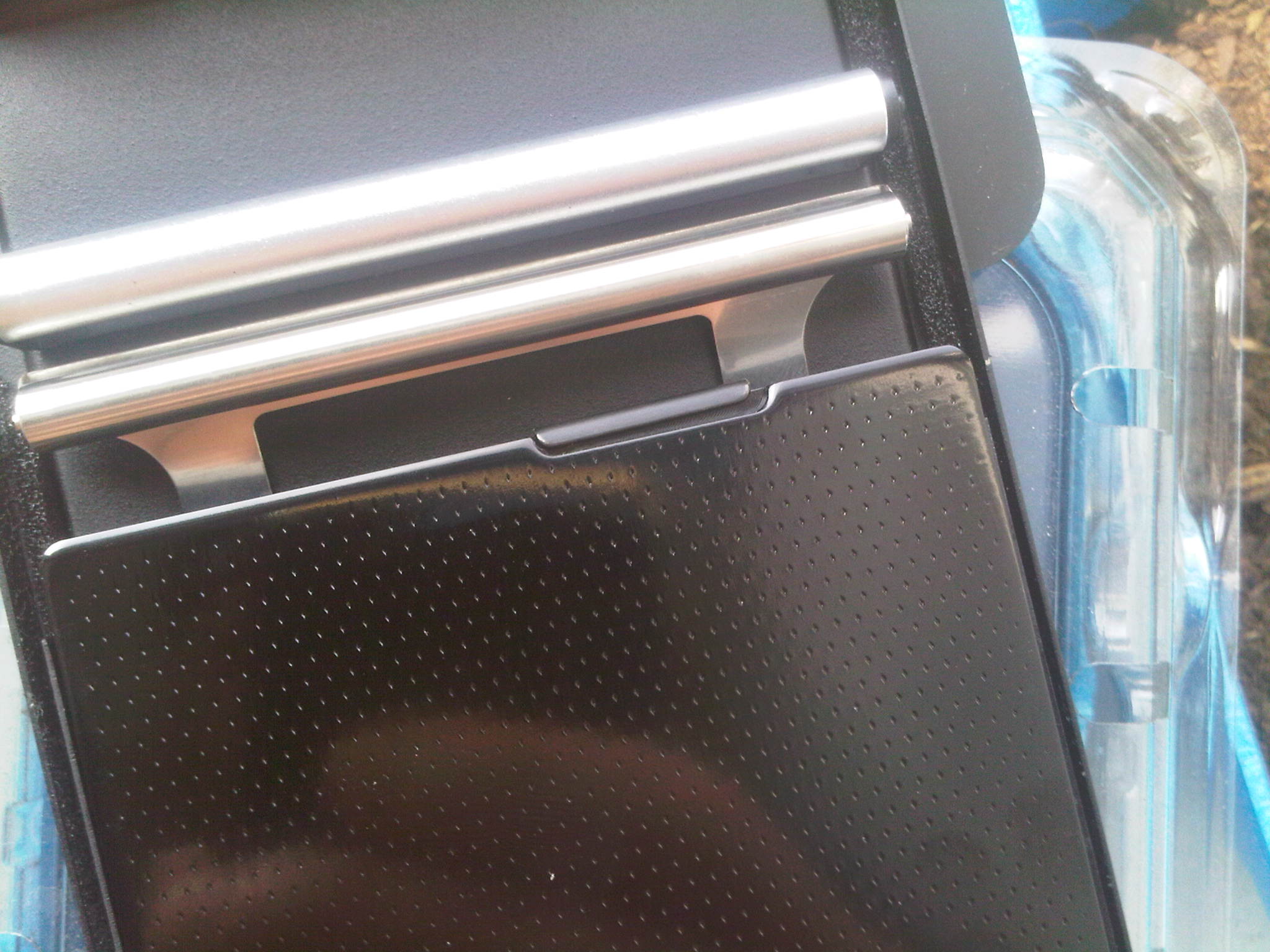

So this made it more obvious, and I looked in the camera and the edge of the pressure plates in these fujis have these little notches. See second attached pic. Which, of course line up right on w/ the lines.
I mean, could that be it? And the wavering of it??? Well, if I grip the camera tight I can see the back flex in, so maybe I'm gripping and loosening as I wind and it's making it move like that?
Maybe it's now more of a question specific to Fuji GW and GSW III rangefinders.

I think the scratch is on the emulsion side. Look at the third image you attached to your first post. See the tiny, curlycue shaped pieces of dust, lying along the line of the scratch? Those are little bits of emulsion that were scraped from the surface as it passed over some foreign object.
I think the scratch happened while the film was moving left to right with respect to the images you have posted.
Since the image is upside down in the camera gate, that probably means that they were created as the film was advanced to the next frame.
I'm not 100% certain how the film path of this camera works. I'm only guessing from my own experience.
This could possibly be the reason why they are wavy. The film moves, gets scratched then stops. The process repeats each time you crank the film forward.

It's def not the scanner. Look at the last set of pictures of the actual film I posted on pg 3. You can see how defined the lines are at spots if held to the light at an angle.

David, it's REALLY strange. But it's an angle thing. If I look at them straight on a light box I see thin hard lines, clear, less density. Usually. Sometimes though, when pronounced it takes on a thicker charachteristic that looks like more density. Then it changes if you hold the film up under a light and look it's almost like the base is rubbed off, but if you tilt it it takes on more density and is much easier to see.
I think it's gotta be the pressure plate. I think it's a mix of scratching and pressure exposing the film more. These notches on the edge of the pressure plate are weird. They're sharp on the corner. And the one that lines up w/ my scratch is pulled out a tiny bit. My thought is maybe it was damaged when someone was flipping from 120 to 220.
Still weird as all get out how wavy it is. Almost like the film is totally loose in the back. Or it wavers from one edge of that notch to the other end. Maybe the film is kinking in there? And that's causing a wavering pressure...and then it scratching at times on top of that...

When you open your camera's do you see the little notches I'm referring to on the edges of pressure plate?
The line/scratch/marks are always within the confines of one of those. I'll attach the pic of the one that looks wanky. There's even some visual signs of rubbing on it.
Is yours like that?
The part that I guess would just amount to bad luck is that I bought two cameras w/ the same problem.

Could be, but I don't get the wavering part, or if it is a scratch on the base how that happens through the paper backing. You could take the pressure plate out completely or swap them between the cameras to see if there is a change, that could narrow it down.
I see a scenario where the pressure plate is only operating on th e right hand side leaving slack film to the left which is dragged back into place when you adva nice the film...........maybe:tongue:
That "could be" refers to your post prior to your last. My plates do not look like that, it does look like something has gone out of adjustment or gotten bent on the one in your photo. Does seem suspect for sure. Looks like a fairly easy fix, though.
David, that might make sense in conjunction w/ the fact that the big cameras plastic back flexes when I squeeze it. So say I'm gripping and winding the right side, it would in theory push the right side of the plate harder and lift the left side.
