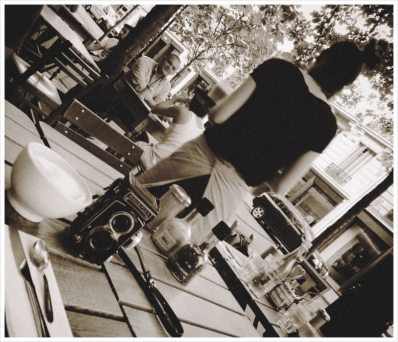

Or perhaps a TLR, you can get a very nice Rolleicord with a Xenar or Tessar lens for a modest price, or splash out for a Rolleiflex with a Planar lens?

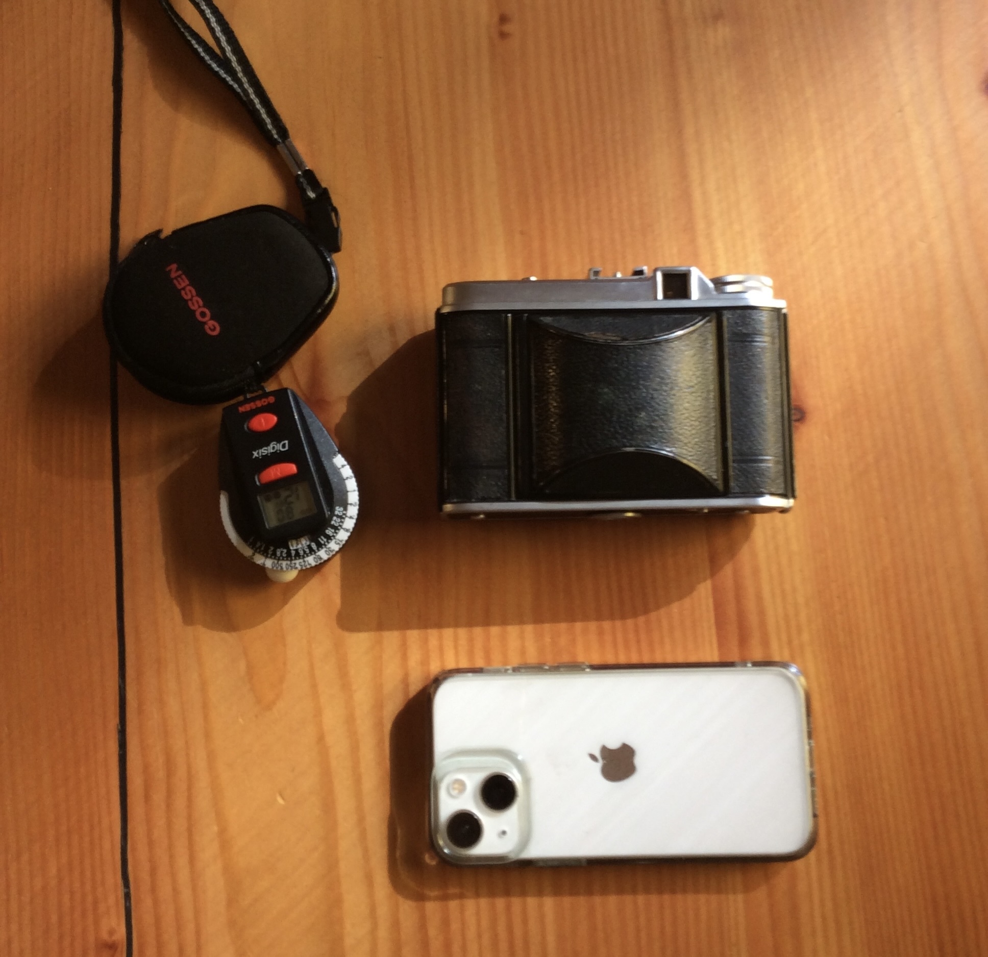

I have travelled with several 6x6 Ikontas, a 6x4.5 Super Ikonta and a 6x9 Voigtlander Bessa 1. They all were light, easy to carry, and provided quality negatives, whether with Novar, Tessar, or Color Skopar lenses.
Inexpensive MF camera with fixed lens, focal length <= 50mm? Dream on.
I travel all the time with folders, occasionally with a Rolleiflex, always in a carry-on backpack (with a bunch of other stuff). However, folders won’t take 35mm adapters (no exceptions that I know of, but maybe there are some surprises out there), and there are few fixed-lens cameras with wide-angles (there’s the Rolleiwide, but it’ll cost a pretty penny).

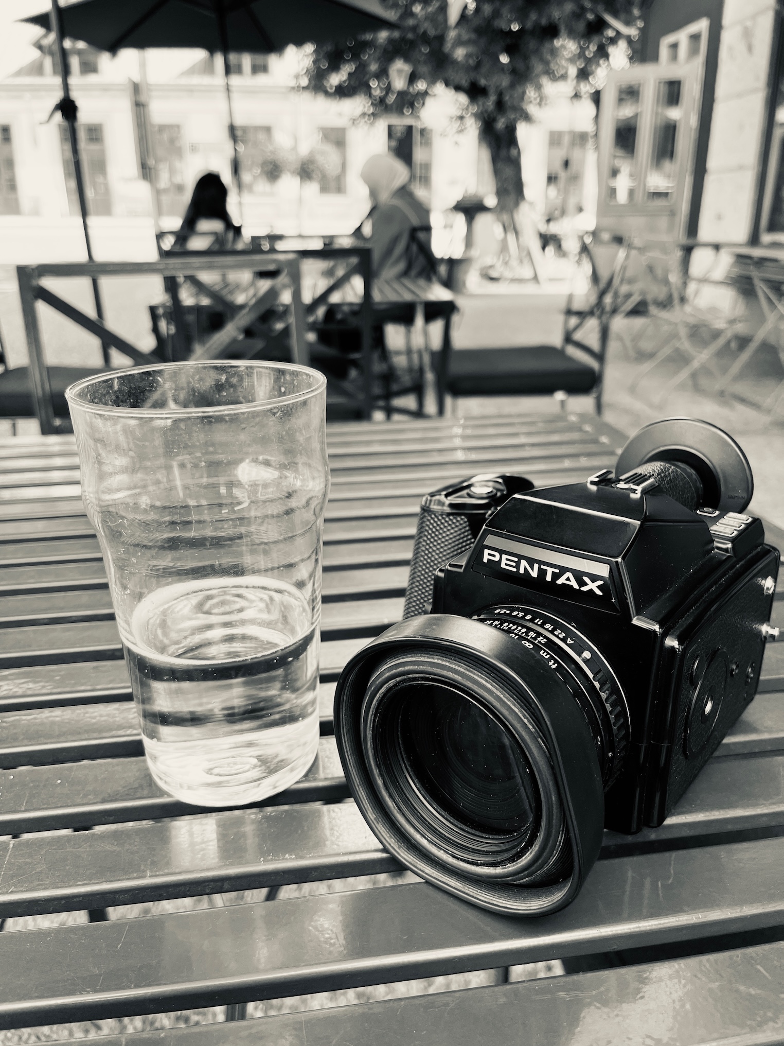

The downside of the Mamiya & Pentax 645 is they're not that small. It seems the OP is also carrying 35mm. So i guess it depends on how/where you're travelling.
A couple of years ago I had the use of a P645 when i visited the Chamonix Valley. I needed some long lens stretch so the Rolleiflex wouldn't do. The P645 w 3 lenses was a hefty Pelican case load. Thankfully for me a colleague couriered it to my hotel and when i travelled on i couriered it back. Great results and terrific lenses....but not exactly svelte.
