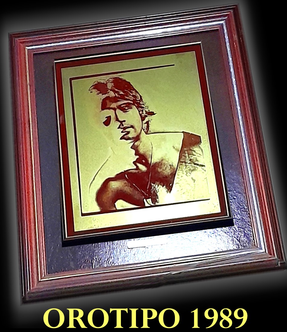

above is attached one of my "OROTIPOS", Some of these works were first seen in the Museum of Art of Costa Rica in 1989.
It is a permanent pigment image made on glass and backed by gold leafs. It can now be done a lot easier and faster with:

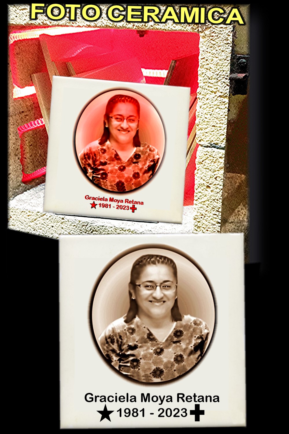

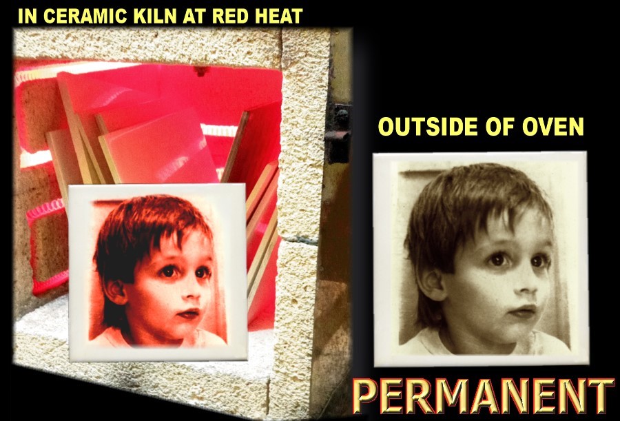

Also attached is: PHOTO-CERAMIC, imperishable photos that I have been making since 1980 for grave yards.
It can also be made now with LIGHT SENSITIVE COFFEE PROCESS,
in this way:
I will add o the coffee light sensitive emulsion finely powdered glass, a metallic oxide as a pigment and a flux like Borax to reduce the fusing point of the powdered glass.
After exposure under a negative, the paper can be transferred to glaze ceramic tile and developed with water there on, after drying it can be fired in a ceramic kiln.
The coffee and any organic matter will carbonize an disappear in a gas between 400-500 degrees C,
the glass in he image will fuse at 900c, leaving in its body the refractory metallic oxides as pigments, all of the mass will combine at red heat and cement to the glaze of the ceramic tile.
On cooling the image is a hard as glass and it will never be affected by fire, water or light for centuries.

Instead of carbon, my ligh sensitive coffee of latest CAFEGRAFIA can be made, instead of coffee, with absolutely permanent metalics oxides as explained below for photoceramics via silver salts, unquestionably surpassing the permanency of all inkjet printers under the accion of light
above a raw photograph not altered by computer technology.
It shows one my absolutely permanent pictures kept under sun and rain. This large format peace will last many centuries in exteriors.
This permanency can not be accomplished in any way with DIGITAL INKS, for the reasons explained before in this thread.
Neither can its stability be equaled by using carbon as a pigment.

After developing the image on the glass I dried it without dissolving the remaining unused silver (FIXING)
I covered the whole silver image with a mixture of a liquid emulsion made of of the metallic oxides mentioned above, finely powdered glass ceramic glaze of low fusing point and emulsified in gelatin.
After drying I then immersed for a few minutes the glass bearing the image under a bleaching bath made of copper chloride and ordinary kitchen salt.
(THINK: the step above MAYBE ANOTHER METHOD OF FIXING SILVER IMAGES WITHOUT THIOSULPHATE)
Then I dissolved the unused silveras well as the pigmented gelatin in hot water to obtain a positive relief on the glass composed of black metallic silver covered with gelatin,
metallic oxides
and a colorless glaze of glass dust.
After drying I carefully placed the large glass inside one of my ceramic ovens, face up and laying flat leveled on a bed feldspar so the glass would not deformed or stick on softening by heat.
I gradually and slowly applied heat to reach in about 4 hours a temperature of 760c.
The gelatin will completely disappear, also the black metallic silver leaving a pale stain of yellow silver oxide giving a more warm tone to the sepia mixture of metallic pigments.
The glaze of he composition will fuse and cement to the glass carrying with it the oxide pigments.
The result on cooling:
A SEPIA A PICTURE MADE OF GLASS ON FUSED FLAT GLASS .
The remaining YELLOW silver oxide will fade overtime, as I said before because of its small particle size,
but who cares ?
The remaining black and red oxides will remain to defy time and whether for centuries.
