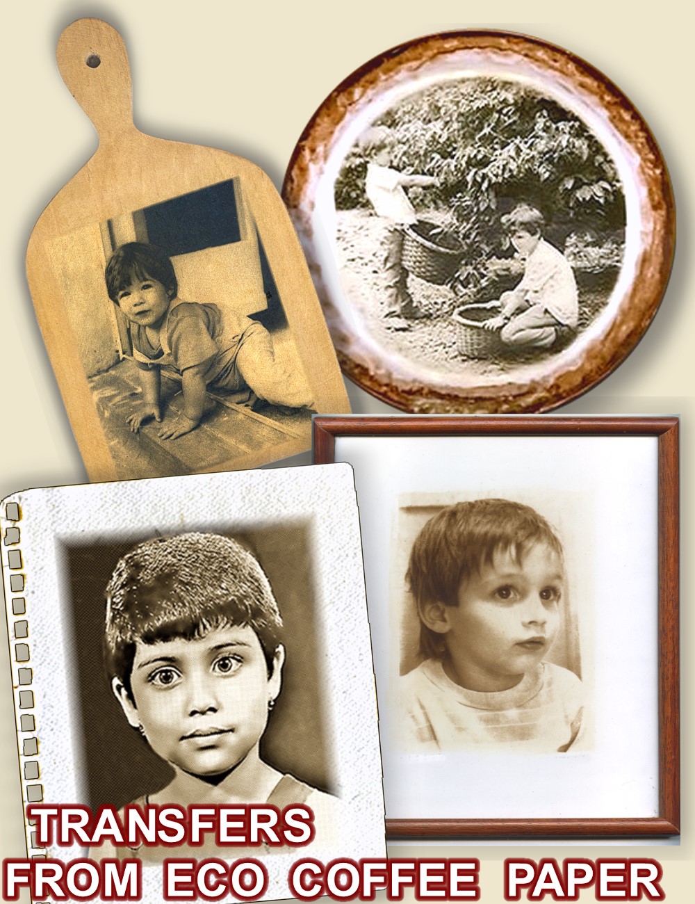

My light sensitive coffee "ECO-PAPER" is "MULTI-USE" as shown in the following examples.
EXAMPLE 1
IMAGE DEVELOPED DIRECTLY ON THE PAPER:
if the image is developed and fixed directly on the LIGHT SENSITIVE paper as it comes, its so easy and un-complicated that children ages of 6 years and above can use it, have a permanent pictures in 2 minutes developing in pure water with no toxic chemicals at all.
This image will not be affected by water or light and will last as long as the "fiber" paper it is developed on will last. Of course the paper being combustible will be destroyed by fire.
EXAMPLE 2
IMAGE DEVELOPED ON OTHER SUPPORTS:
The light sensitive coffee "ECO-PAPER" after exposure to light under a negative, instead of developing the image in pure water directly on paper itself as in EXAMPLE: 1;
In this example: 2, the exposed sensitive side is transferred faced down by pressure on to any other insoluble not absorbent support, like glass, metal, plastics, ceramics, varnished wood or resin coated paper, painting canvases.
Immediately after transferring on any of the above mentioned supports, the combination of the exposed paper adhered by simple pressure to the support; it is then immerse under water, the paper will come off the support and it is discarded,
the light sensitive coffee emulsion will be left evenly on the insoluble support and is further washed with water until the full image appears AND is shown with its long scales, details and the highlights, middle tones and strong shadow just like in the carbon process.
Naturally if the image is transferred and developed on refractory material like clay, glass and ceramics, these substrates will not be burned by fire and the final image is more permanent.
In interiors under roof will last unaltered for many many centuries.
As said before this "ECO-PAPER" is "MULTI-USE" example:2
however is not as easy for children under 6 years old. But the following example 3, it is.
EXAMPLE: 3
IMAGE OF PAPER EXPOSED pressed in contact on self adhesive
plastic Sheet.
The exposed paper is just made wet and placed in contact with the adhesive side of the plastic sheet. Then the exposed paper adhered of the plastic sheet is immersed under water, the paper comes off by itself and further washed with water until the image corresponding to the negative fully appears on the plastic sheet itself.
The image It will be seen by transmitted light like a transparency, and after drying the areas corresponding to the whites or transparent parts where ther is no image, will regain its stickiness and can be glued by itself to any solid support like a normal sticker.
If the plastic sheet is made of Vinyl, polyester, acrylic , PVC,
or else, then it will not biodegrade in 400 years.

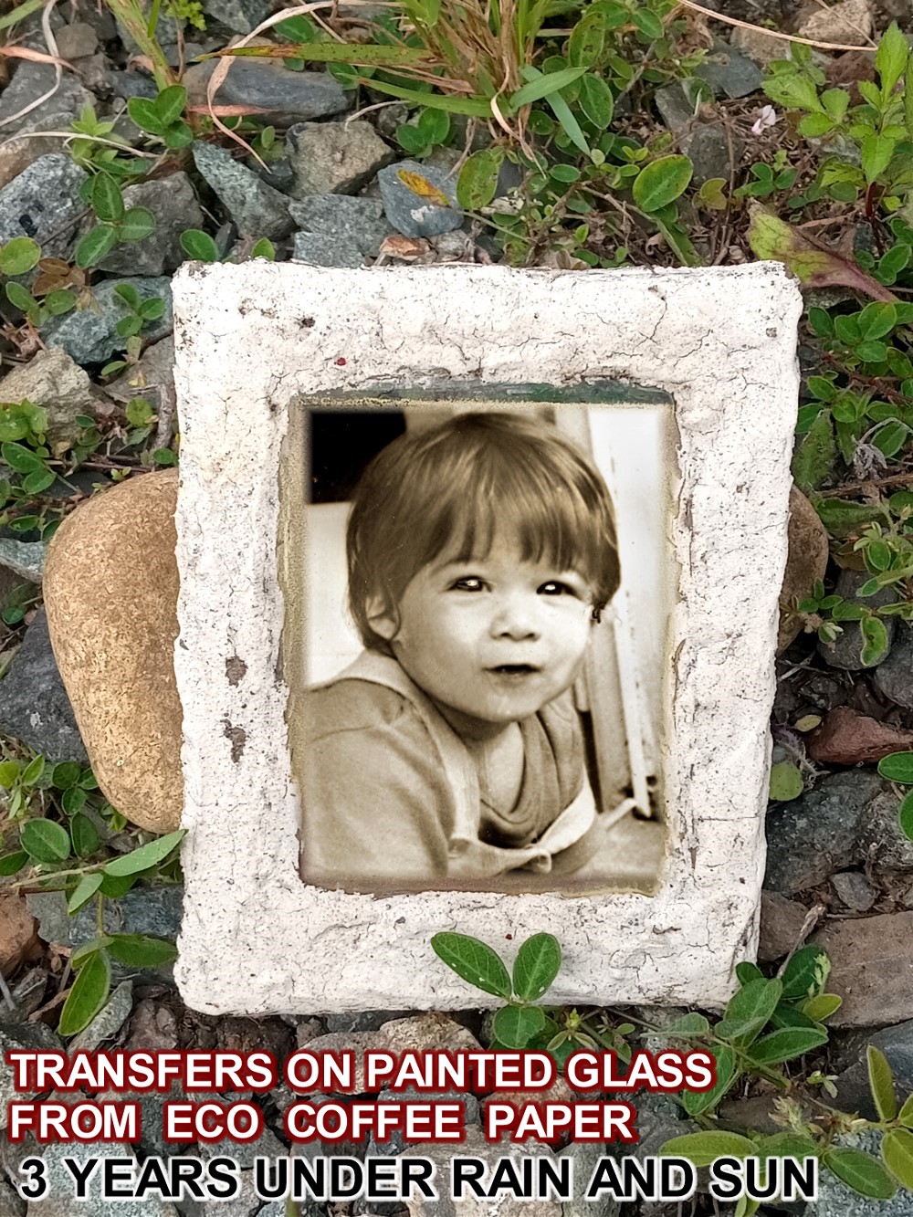

YOU ASK:
Can I ask about the permanency of 200 years? Has this been tested? Obviously your papers have not bee around for 200 years but have they been subject to a scientific accelerated ageing process and if so what was this ageing test
MY ANSWER:
See the picture attached:
It was transferred to glass as in EXAMPLE 2.
After developing and drying the image was painted white and backed with another glass. So it is protected from the front and the back with 6 mm thick glass.
Its edges were sealed with silicon, and on the silicon edged also with construction cement.
I have kept it for 3 years out side under sun and tropical rain for 3 years.
It is as good as fresh, if rain water entered its edges it will not look good but it will not affect the image and the water leaked will disappear as soon it takes some hours of sun heat because the vapor will scape by the same way the water entered.
This is a severe test. I am convinced of its permanency.

"LIGHT SENSITIVE COFFEE"
non toxic, ecological Permanent Pictures
"in 1 Step" which requires for the user only one resource available in all households: "WATER".
Friendly to children and senior citizen that are the most vulnerable people of the planet.
