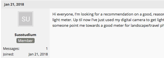

65 post thread....I don't think he is following any more...
He disappeared on 31 Jan 2018 with only his opening post. You could say that at least he stayed around long enough to digest the first set of answers and we can be grateful that his subject matter did not result in the break-up of any beautiful friendships and withdrawal of anyone else from Photrio :D
pentaxuser
It seems in many cases, these initial posts are just springboards so the 'regulars' can discuss (or argue!) a topic. Isn't this the whole idea of a 'forum?'
My post was to poke fun at you guys (myself included) for carrying on for 65 posts :smile:

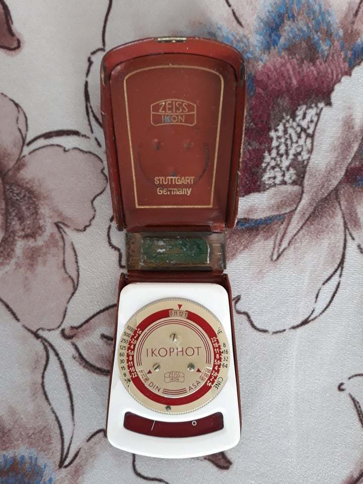

I have a bunch of light meters. Yes I have a fetish for them lol. However the ones I use on a regular basis are the Sekonic 558 and an old Zeiss pictured below. The image is not mine I snagged it off epray. My Zeiss meter came from my dad and is still in great physical shape and still very accurate. s-l1600.jpg
