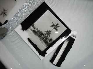

Thank you Denise for the tutorial! My first hand coated sheet is now in the wash. I messed up with the directions a bit (forgot to add Everclear), but I still got an image. Yay!!!! I'm hooked now.
Eugene.
Sent from my iPad using Tapatalk HD
