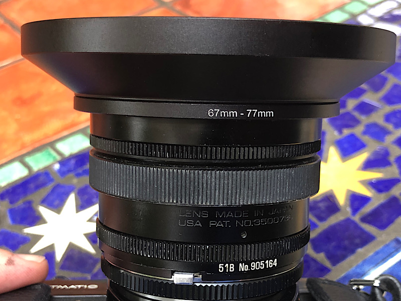

That's why I decided to attach a 67-to-77mm step-up ring to my Tamron 17mm -- it has a 67mm front with no thread. Now I can add on any 77mm filter and shade.
Not to mention very hard to find.
Which is exactly what I am putting together for mine. I ordered the step up ring and a 77mm lens hood on eBay, I’ll know in a week how that works out. The lens hood is on eBay for $75, but it hardly seems worth it, especially since I don’t have any 82mm filters. I’ll see how my $15 purchase works out and report here.
I would guess that an 82-77mm step-DOWN ring would not cause any vignetting. I do not get any with my 67-77mm step-UP ring. Please report back -- others might appreciate it.

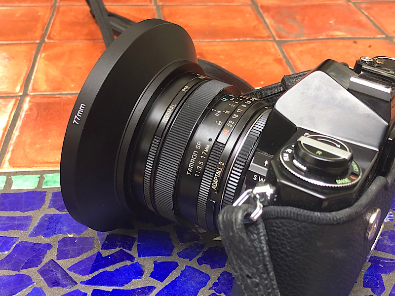

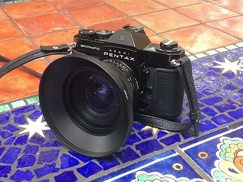

Okay, concerning the Tamron 51B 17mm f/3.5 lens hood adaptation, it works! Thank you, xkaes. $15 (including shipping!) on eBay for both the wide angle 77mm hood (lens cap included) and a twin pack of 67-77mm step up rings. Black silicone sparingly applied around the 67mm threads keeps it secure.
No vignetting. Great set up.
And good-lookin' to boot!

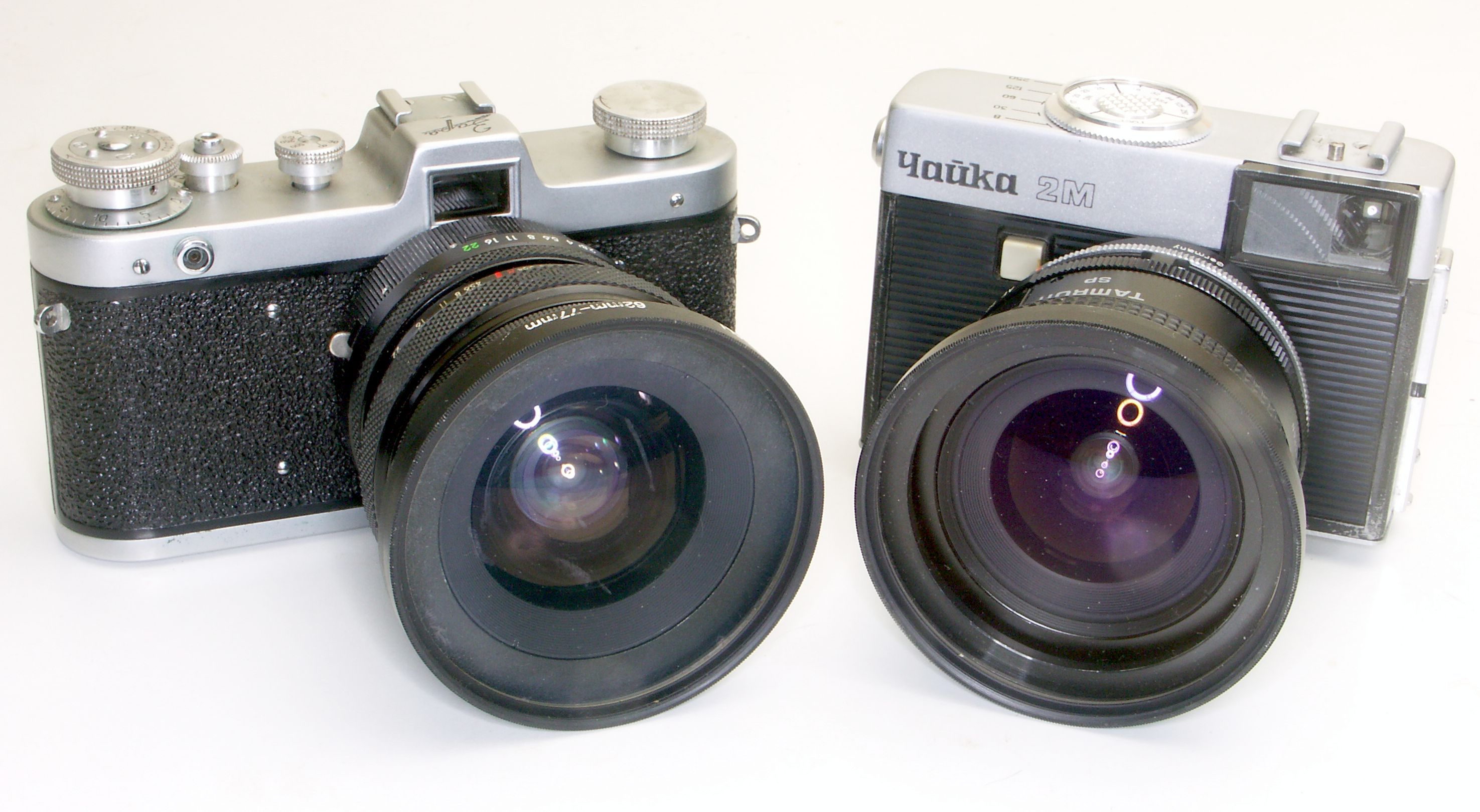

Here's my Tamron 17mm f3.5 (right) on a Chaika 2M half-frame and Sigma 18mm f2.8 on a Zapa full-frame -- both with step up rings to 77mm:

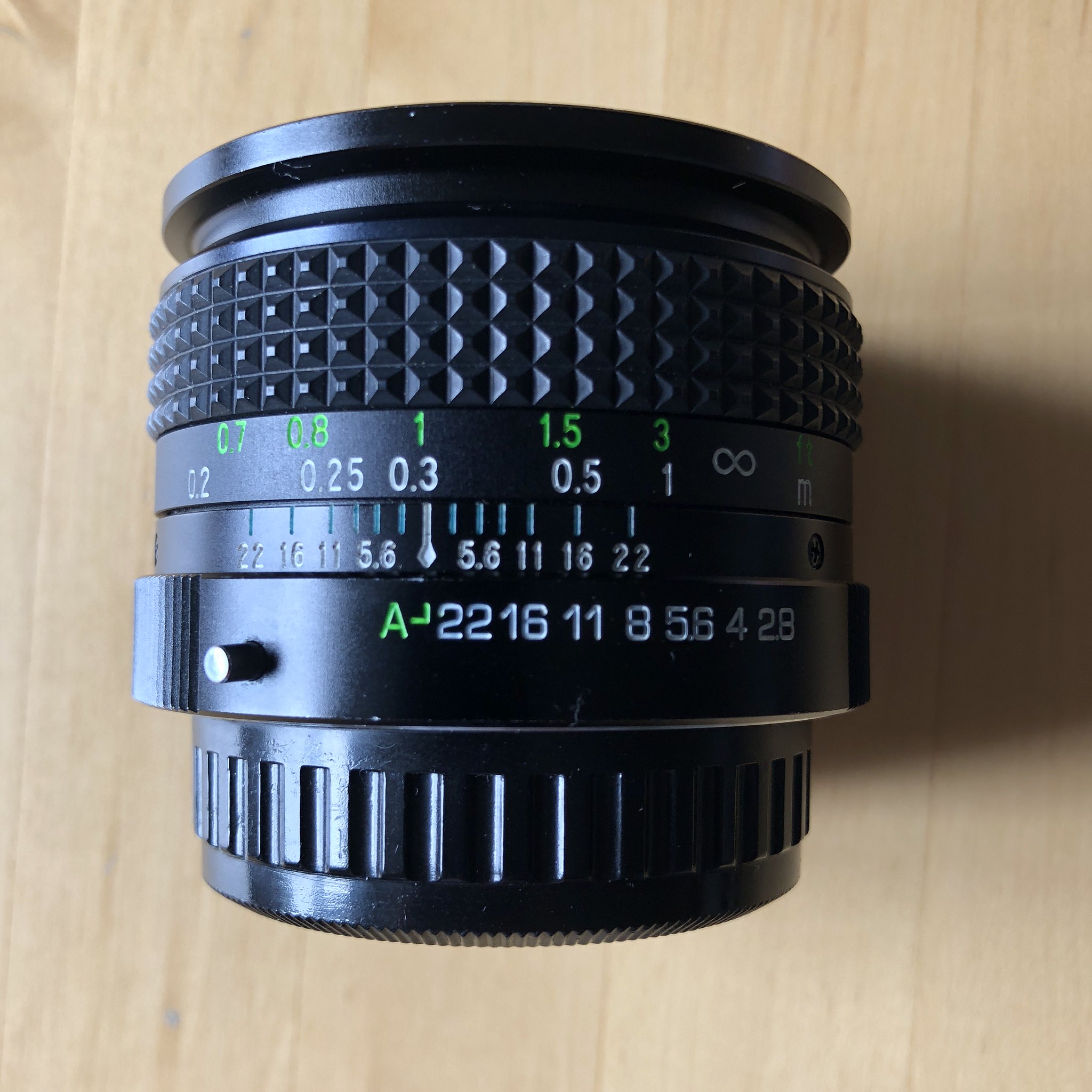

I have a Cambron 20mm 2.8 that I bought back in the 90s from KEH for my Yashica/Contax. I couldn't afford the Zeiss lens. Once stopped down a couple stops it is as good as anything. Of course the Cambron name was from that scheister New York camera store that I've forgotten the name of. I stlll have the lens. Never needed to get the Zeiss. I never could figure out who made the thing. I'm guessing Tokina but the couple times I looked I couldn't find anything that looked like it.
You're thinking of Cambridge Camera Company. Like Spiratone, they sold a lot of re-badged gear -- from not-so-good to great -- but always at a good price. For example, Spiratone sold rebadged Yashica/Tomioka and Sigma lenses. Figuring out where their lenses came from can be a challenge, but a side-by-side comparison is usually a give-away. Is this what yours looks like?
Except for the aperture ring it is just like that. Same colors and focusing ring. Tamioka? That would make sense since they made some great lenses.
The aperture ring would, of course, be different for different cameras. I don't know what this one is. Not Minolta. Canon???. Anyway it could have been Tomioka, of course, but Tokina comes to mind. They often had focusing grips that resembled Minolta Rokkor-X.
