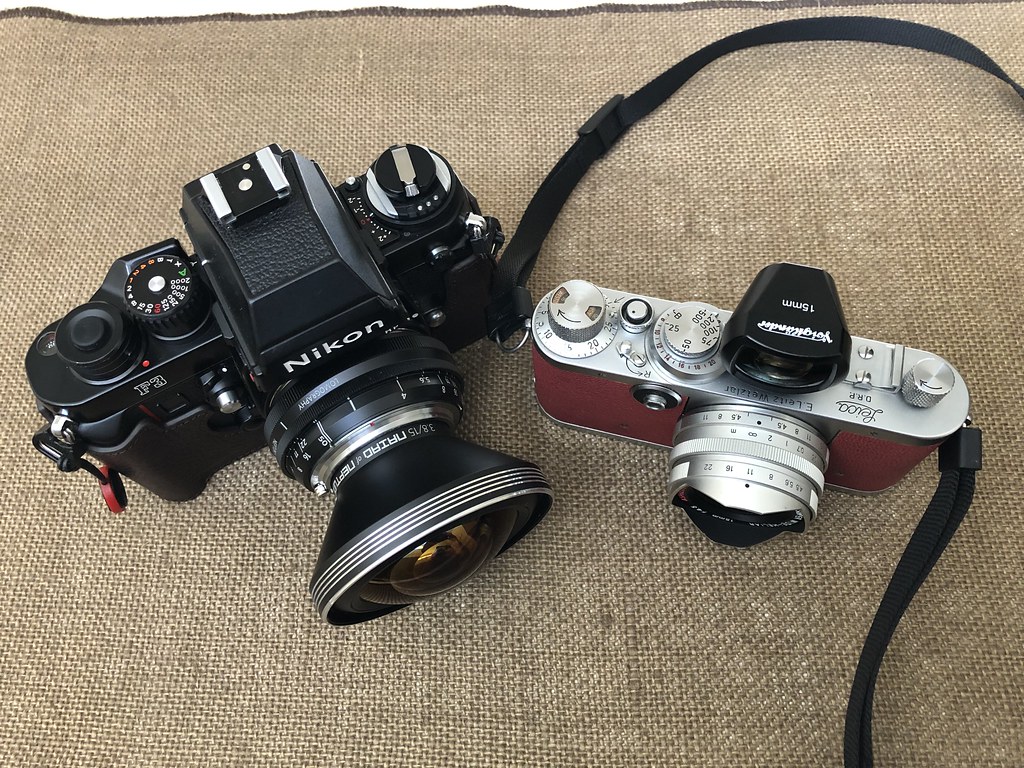

My two 15mm lenses. Replaced that crappy finder with Voigtlander’s much better metal version which has frame lines.

The Lomo Neptune series lenses - of which the 15mm is one - are surprisingly good optically but frankly a pain in the keester to use. So the only time I use them is for novelty and to remind me how much better modern gear is.
