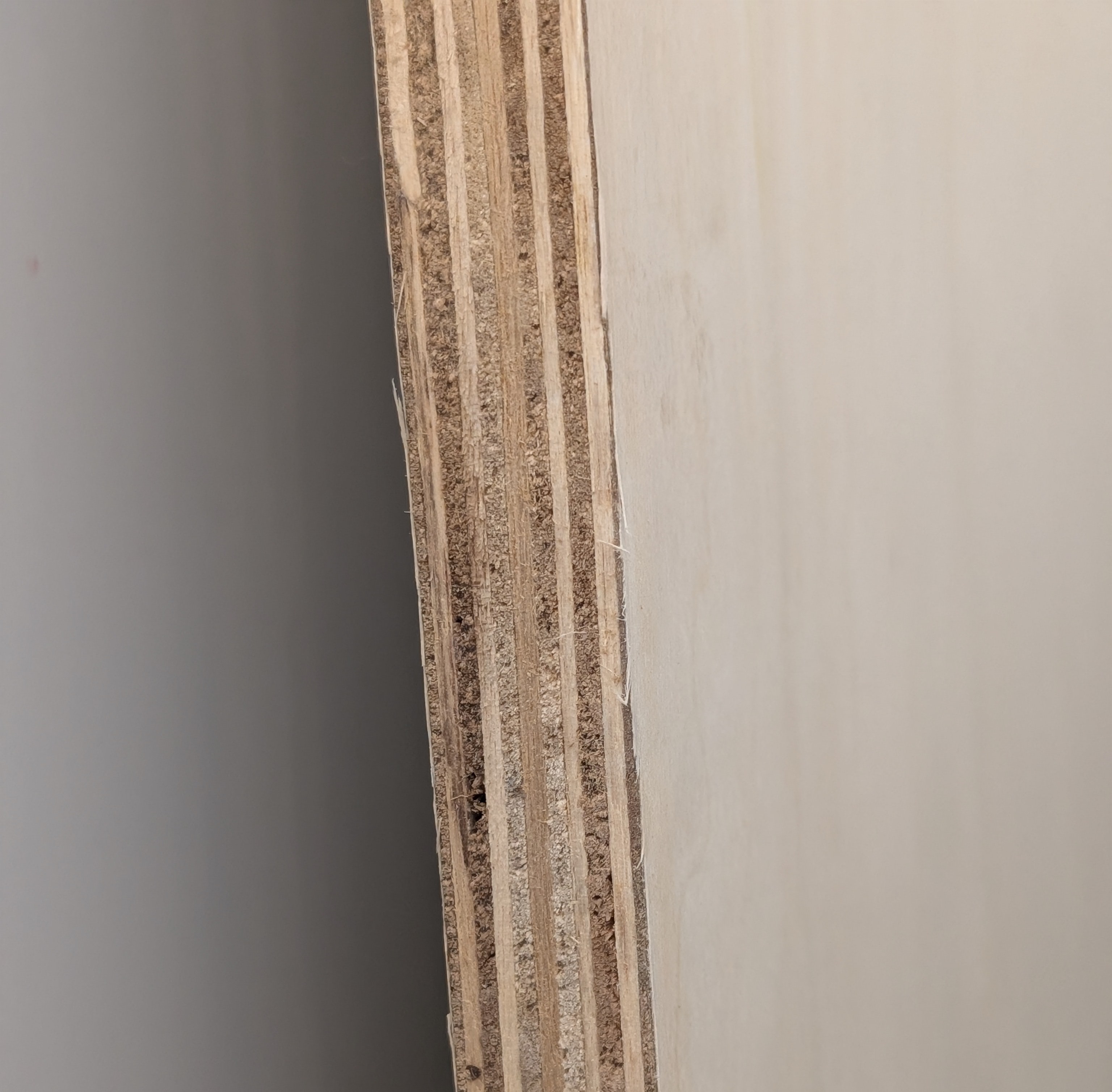

Looking closely at your plywood, I would want to be sure it does not get wet. period. So, when you say, "... I'm going to roll a layer or two over the entire surface of the plywood as a primer/encapsulation..." I hope you plan to cover both sides (top and bottom). With any kind of laminated panel, it is always a good idea to have symmetrical layers, top and bottom, (balanced) to prevent warping. And in a humid environment, wood can absorb water vapor through the back/bottom surface if it is not adequately sealed.
To be sure there are no tiny holes in the resin coating, I would suggest a thin layer of glass cloth (2oz-4oz/sq.yard) over all flat surfaces. Of course, the end grain at the edges of the panels would not be easy to cover with fiberglass cloth -- so I would feed the exposed edges as much thin resin as they can absorb. Or better yet, epoxy a thin hardwood strip over all exposed edgegrain to help protect the thin edges of the surface laminate.
Want an even better look at the edge?
Pictured: Just add water.
I would say that this is the antithesis of marine plywood, so...yeah, with the possible exception of particleboard, there's probably no worse option for a sink carcass.
In general I would agree with that assessment. In this case I don't know that any significant degree of deformation would be capable of occurring, but since the quantity of resin that I'll have to purchase to seal the inside of the sink is also enough to do the outside, it's a non-issue.
To be honest, I'm more concerned about delamination than actual deformation, but since my darkrooms are traditionally somewhat dry, I don't foresee that as an issue, either. There should be very little moisture or water contacting any surface other than the immediate interior.
A full layer of cloth isn't a bad idea, but I'm just not sure that it's going to add any significant degree of strength or waterproofing... especially if the most vulnerable areas - the exposed interior cores - are left uncovered. I think it wouldn't take much work to layer some chopped strand or bias-cut strips over those edges, but doing so would require a significant radius (1/4" to 3/8") to be routed into all of the exterior corners, and I'm not really sure that I want to do that: I don't really lean on my sink area, so easing those edges beyond what's necessary for the finish doesn't add much.
This being said: there's nothing wrong with adding the glass layer... I just don't know that it will improve the sink's moisture resistance when there are a minimum of four coats of finish on the surface: at least two full coats of resin and at least two full costs of finish, plus whatever additional material is needed on the exposed cores.
Not a bad thought, but at first blush it seems like lapping the glass layer would be a better method...but that brings in the necessity of routing, so I'll have to think on it. Not a bad idea, though; thank you.
