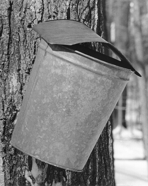

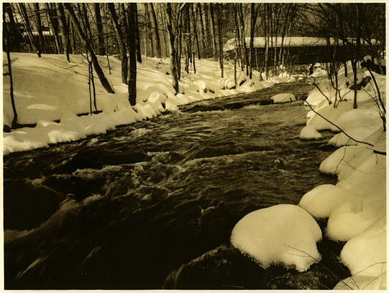

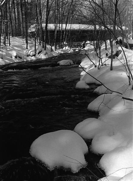

Both are printed on Ilford MGIV RC and developed in Polymax T developer. I toned them in Berg RST at 1:20 for 4 minutes.
For Jon's maple syrup bucket negative, I chose a longer, more rectangular horizontal crop. The main exposure was at the equivalent of grade 2 1/2, with a small "bump" at grade 5. I held back the snow for about 20% of the main exposure.
For Jon's river and covered bridge negative, I chose a more rectangular vertical crop. The main exposure was at the equivalent of grade 1 1/2, with a 25% "bump" at grade 5. I held back the brighter parts of the snow for about 20% of the main exposure.
In contrast to some of the other comments here, I've printed lots of other people's negatives over the years, and therefore I am used to the experience. Jon's negatives are quite rewarding to print, unlike some more "challenging" ones I've encountered. :wink:
Thanks for all the work you've done on this Jon.
Matt
I finally got a few hours in the darkroom to come up with a couple of prints that I'm happy(ish) with. When scanned they look lighter on my monitor and there appears to be a dust bunny living inside my scanner.. so please ignore the flecks.

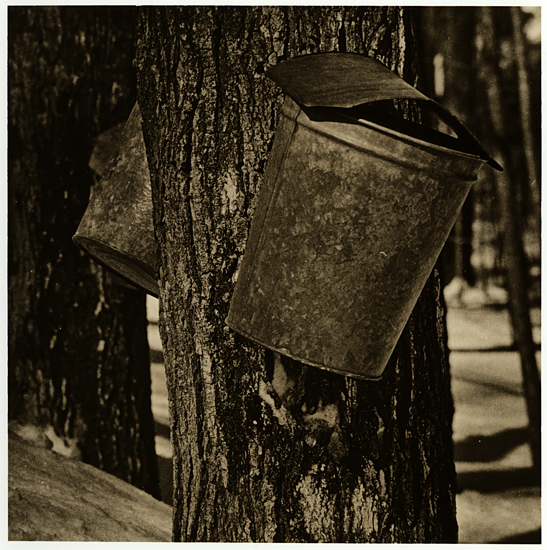

I did a slight crop on the sap buckets in one, developed in Ilford warmtone developer on Ilfords MGIV RC Pearl paper. The second sap bucket I've posted was an experiment.. it's developed in rodinal on the RC Pearl paper and toned/stained in green tea for 24 hours, but I have to admit I quite liked the effect.

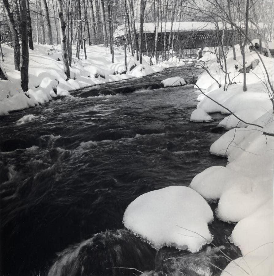

The river neg I chose to darken, I tried a few with detail in the water, but much preferred the dark moody look. Once again developed on the RC Pearl in warmtone developer.
Thanks again Jon for taking and sending the negatives and arranging the exchange and to everyone who took part, it's been fascinating watching the photo's appear.

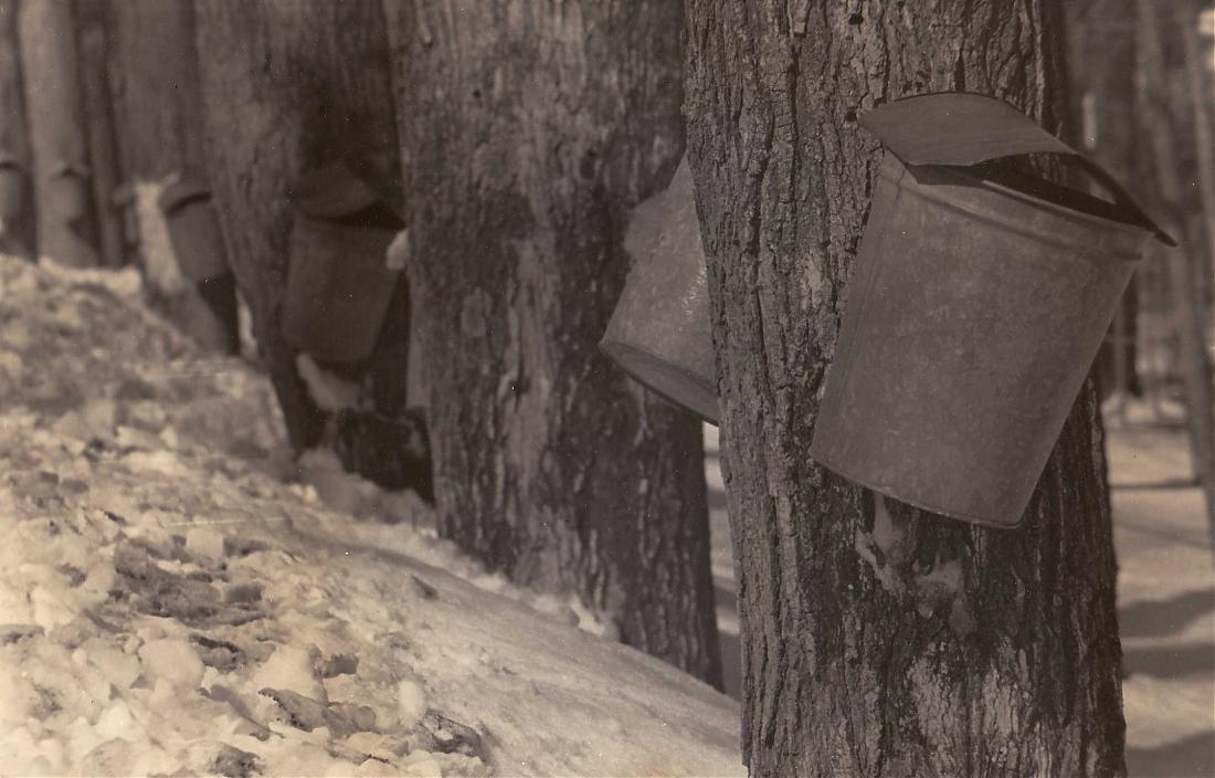

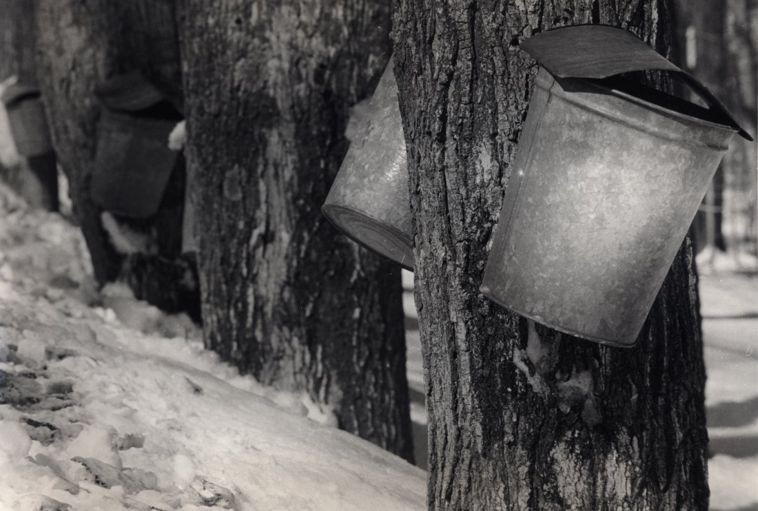

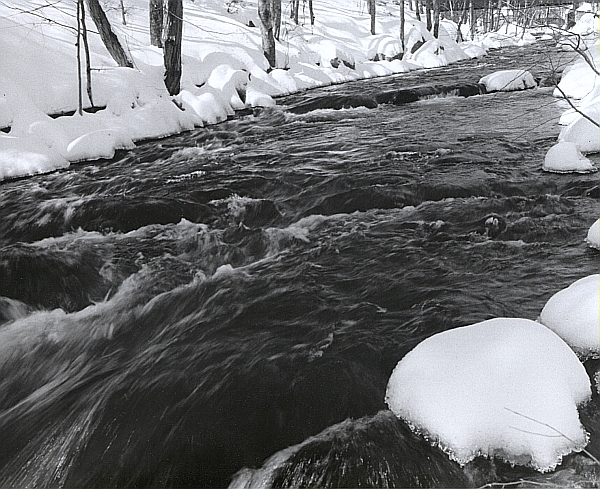

Well I finally was able to spend some time in the darkroom. I have printed both negatives and I'm reasonably pleased with them.
For the snow scene I chose to crop heavily to put prominence on the rushing water, I really liked that I was able to get the water to rush out of the bottom left side. I'm not really used to printing snow scenes and I was a bit concerned about the nearest blob of snow in the right foreground, it wasn't really creamy white. I then realised that that piece of snow was in shade, no matter what I did it would never be almost pure white, unless I underexposed it. I held the centre of the river 1/4 of a stop and the centre far left of the river 3/8 of a stop more.

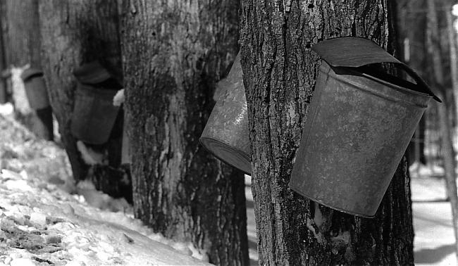

The bucket was interesting but I wished for a simple not too busy scene. I enlarged quite a bit and isolated the closest bucket. Unfortunately there were a few negative markings that due to the enlargement became a bit prominent. I thought about spotting, but at the moment my hands are still shaking too much, in about 8 weeks time the shaking should be quite diminished, according to my doctor.
I also did the same print with a steel etch screen overlaid, I thought this would be good and it is, but I couldn't get enough contrast for it to be really pleasing. This kind of screen over paper, requires a contrasty type negative to work well, the negs supplied were of a normal contrast and suited the subjects perfectly for normal printing. I'll include this steel etched print in the exchange as well.
Both of my bucket prints, are straight prints.
I printed mine some time back, but I've not scanned it. I've just been comparing it to those I'm seeing here. It's more like some, less like others. By the way, I think I like how Mick printed his better than I like mine. I like your water crop, Mick. It puts more emphasis on that beautiful water. In fact, when I looked at yours I said, "his water is more dramatic than mine somehow"... then I realized it's because you took out the distractions. Nice!
Janet Cull
Janet, many thanks for the compliment, the actual proof though, is when you hold the print in your hand.
I did think that the water really was the best part of the negative, so I worked on that.
Mick.
