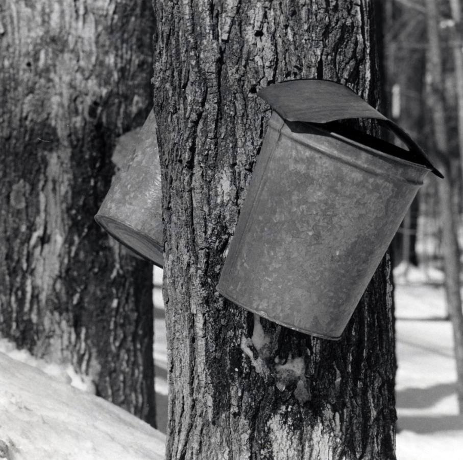

Ok, it's the 11th, so the cable release is back on the camera :tongue: I haven't heard from Sean about making a separate gallery area, so our choices seem to be post them in the thread or in our own galleries. I tried to post into the general "Member Organized Function" area, but it doesn't allow postings. I'll post mine here.
I made the first prints from the negatives after I had sent the initial group out, so I didn't have any more time to look at them than anyone else. The first night I just made a quick 8x10 'work print' of each - I often find it easier to look at cropping choices on a print rather than a negative.
This print is my third choice on the sap bucket negative. It is printed on Kentmere Fineprint FB glossy paper. I selenium toned it, which had more of an impact than selenium does on my more commonly used Ilford Multigrade.

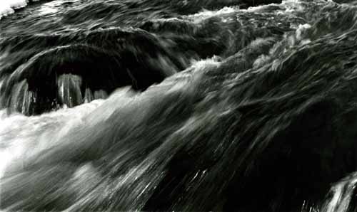

Well here is a print from the river neg. I have to say it was a lot harder to envision a picture from a neg I didn't shoot, then I thought it would be.
I cropped in on the water and a rock. Developed in Burke and James Cold Tone from the darkroom cookbook. On Agfa VC paper.

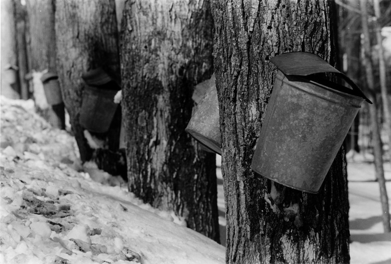

I liked them full frame. Printed on Ilford MG IV processed in Ilford cool tone dev

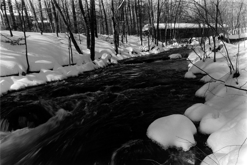

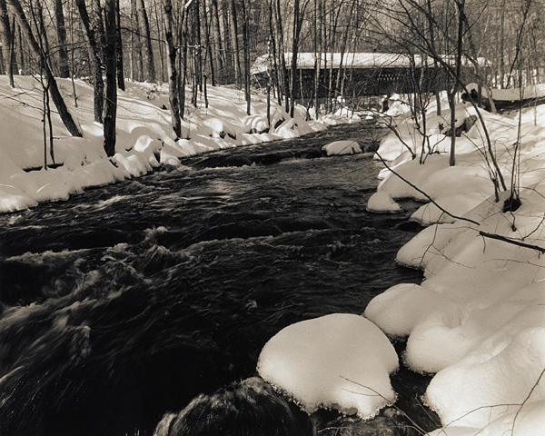

Here are the ones that I have so far. They are split-grade printed on Ilford MGIV in LPD 1:4. The one on the left was toned in selenium 1:9 for 3 minutes. I cropped the image to the ratio of 1x1.25. I cropped all off the left hand side. It's a pretty straight forward print.
In my opinion the image looks best printed in straight black and white, no color toning. I tried a slight sepia toning along with selenium for cold shadows and warm highlights but did not like the result, but I posted it below (right) anyway.

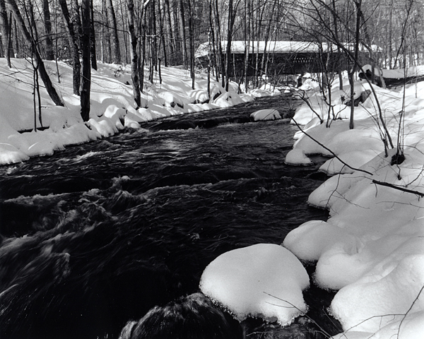

Finally managed to get a scan that approximates my print! :smile:
Printed on Ilford MG FB Warmtone, developed in Beer's #4.
From my initial contacts, I knew I wanted to print at a fairly hard grade to keep the sparkle in the snow, but I wanted a softer grade for the river to make the most of its tonal range. As the river doesn't have a nice clean border down the right-hand side, I decided to bleach the latent image, rather than try split grade printing. For the print posted, I gave a single exposure at grade 4, then bathed the print in a bath prepared using 5ml/l of my LIB stock (0.1% m/v Potassium Ferricyanide) for two minutes. I had no need to make any adjustment for speed-loss on bleaching.
In the straight print, the foreground snow, and whitetops on the river were pretty dull due to being in the shade, so I did some selective bleaching to enhance the highlights that were present.
To finish the print I wanted to tone with gold, to give the snow a nice cold blue tone, but I wanted to keep some warmth in the river. So I toned for 4½ minutes with selenium toner (1+9), washed, and finished with gold toner for ten minutes.
