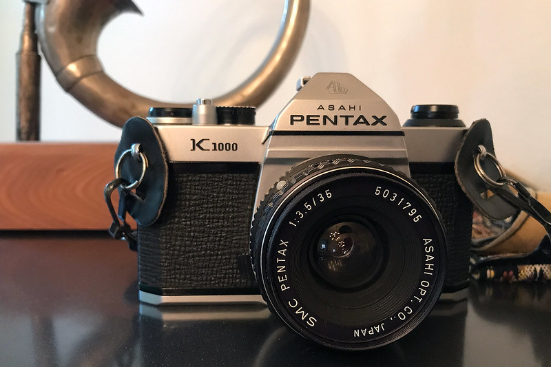

I'm finishing this thread with the good news. I received the camera from Lezot's a few days ago and all is well. They did a CLA on the 50mm lens and camera in four weeks and everything is spotless and functioning properly.
While waiting for the CLA I decided to get a "better lens" for this camera and decided to follow the advice from @Pioneer and got a slow 35mm lens. It arrived in a few days from Japan and is indistinguishable from a new lens. It cost less than a hundred dollars and the lens is a crackerjack. Outstanding value there.
I took the camera and Pioneer lens for a walk in Philly today and all is well. Good times. Thanks for all the advice!
