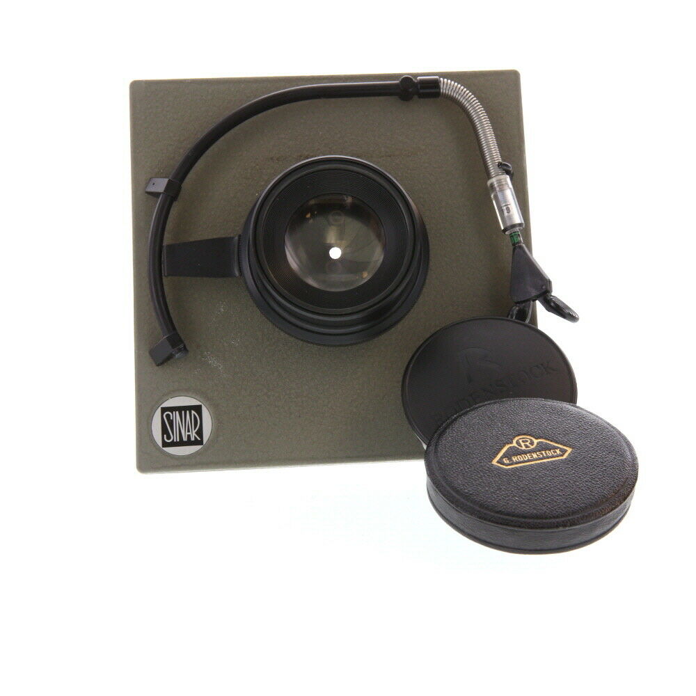

Darryl Roberts Member Allowing Ads Joined Jul 1, 2017 Messages 704 Location Atlanta, GA Format Large Format May 4, 2020 #1 Hi, What does the tubing do on this board? Shutter. Attachments 300mm sinar ronar.jpg 72.4 KB · Views: 97
Nokton48 Member Allowing Ads Joined Oct 8, 2006 Messages 3,129 Format Multi Format May 4, 2020 #2 Works the aperture setting manually, in conjunction with the Norma Automatic Shutter, to control the shutter time. This 300m Apo Ronar Board is direct-operating. They also made spring acting auto aperture models. Basically they offered most lenses in both ways. With this you can set the aperture while behind the camera. It was a big deal at the time and very fast and sure to operate. Speeds up operation.
OP OP Darryl Roberts Member Allowing Ads Joined Jul 1, 2017 Messages 704 Location Atlanta, GA Format Large Format May 4, 2020 #3 Thank you. So the shutter is separate?
Nokton48 Member Allowing Ads Joined Oct 8, 2006 Messages 3,129 Format Multi Format May 4, 2020 #4 Yes. Google Norma Mechanical Shutter, very useful to have. Then you can use any lens in a barrel
