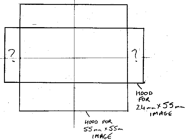

George,
As there is at least one other person interested, we may as well continue in public. I'm also interested to read other people's views on this subject, especially because I know the limitations of the classic, simple method and would like to learn how to refine it. I think that I understand how you do your calculations - I seem to be able to predict the square hood calcs to the nearest 0.1 mm, but I can only predict the rectangular calcs to about 5%. Even in the unlikely event that I have the calculations correct, it is your method and I'll keep my mouth shut.
Here's something that bothers me about using so little information to design a lens hood: You have to make an assumption about the relationship between the diameter of the front element and the field of view. Let's try another example to illustrate this:
Focal length: 52 mm
Front element diameter: 50 mm
Film dimensions: 24 mm x 55 mm
Hood length: 71 mm
What hood dimensions would that result in? I think that George's result would be something like 45.5 mm by 104.5 mm. Is that anywhere near correct? I'm assuming that you can select the hood length with your software, though I suspect that 71 mm might not be the length that you would recommend.

... In the original case the lens (a Zeiss Distagon) was being used for a full-frame (55 mm x 55 mm) image. The lens hood was calculated to be 71 mm long, with sides of 88 mm. The second calculation was for a central crop from that frame, 24 mm high and 55 mm wide. The lens hood, at the same distance from the front vertex, is now calculated to be 114 mm wide. Why isn't it still 88 mm wide? Because the assumption about the front element is not valid. Best,
Helen
It's for an entirely different reason than you think... and a very simple one! Nothing to do with your assumption (which is not mine). Heck, I have to shut up now... George

George,
If an opening of 88 mm x 88mm is adequate to pass all the image-forming rays heading towards a 55 mm x 55 mm image, why do enlargements (marked with a question mark in the sketch) need to be made to the opening to pass all the rays heading towards a smaller image? What rays pass through these enlargements, and why weren’t they necessary for the larger image format? I find those questions difficult to answer, and I would appreciate your assistance.
