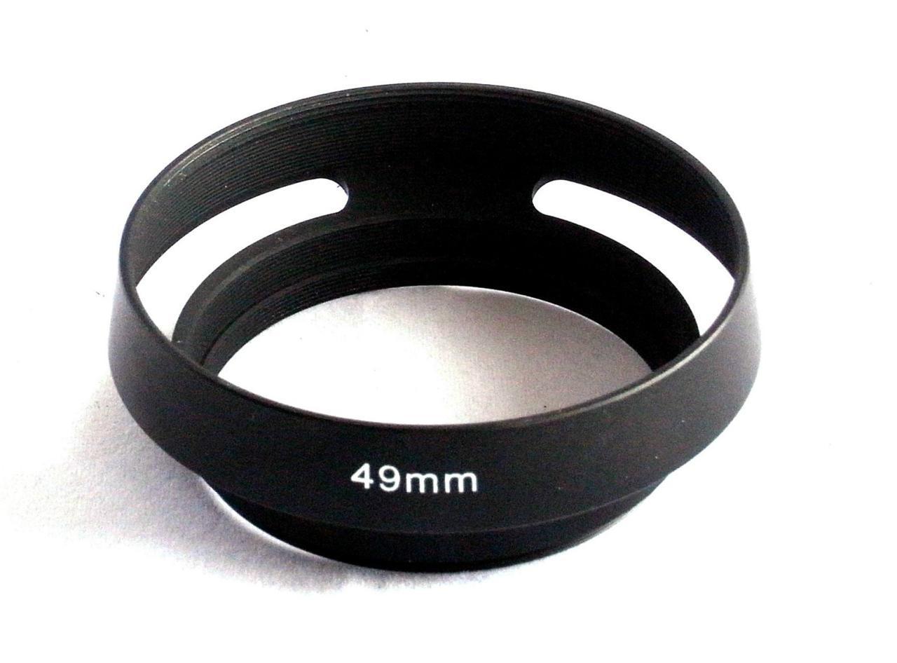

The vented one looks cool, but I'm afraid it would be too large and block too much of the rangefinder patch. Any benefits with including vents?

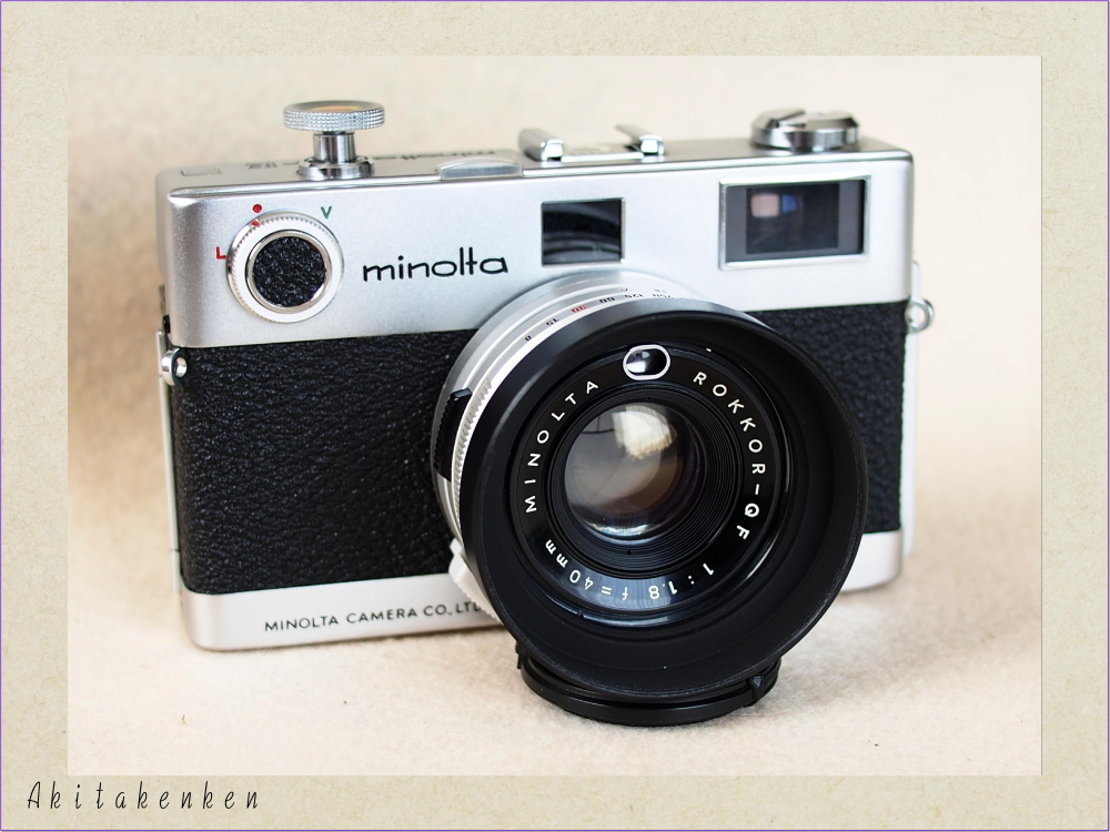

The last one is a simple hood that appears to be not too large, and may indeed compliment the camera well, as the one pictured below here:

The vented one is the one you want. Those are made for rangefinders. They're designed so that the outside circle is usually parallel to the view path from the window. That way they only block about as much as the thickness of the metal.

Of course with a rangefinder the problem of vignetting the finder remains. Here a vented design may be benefitial.

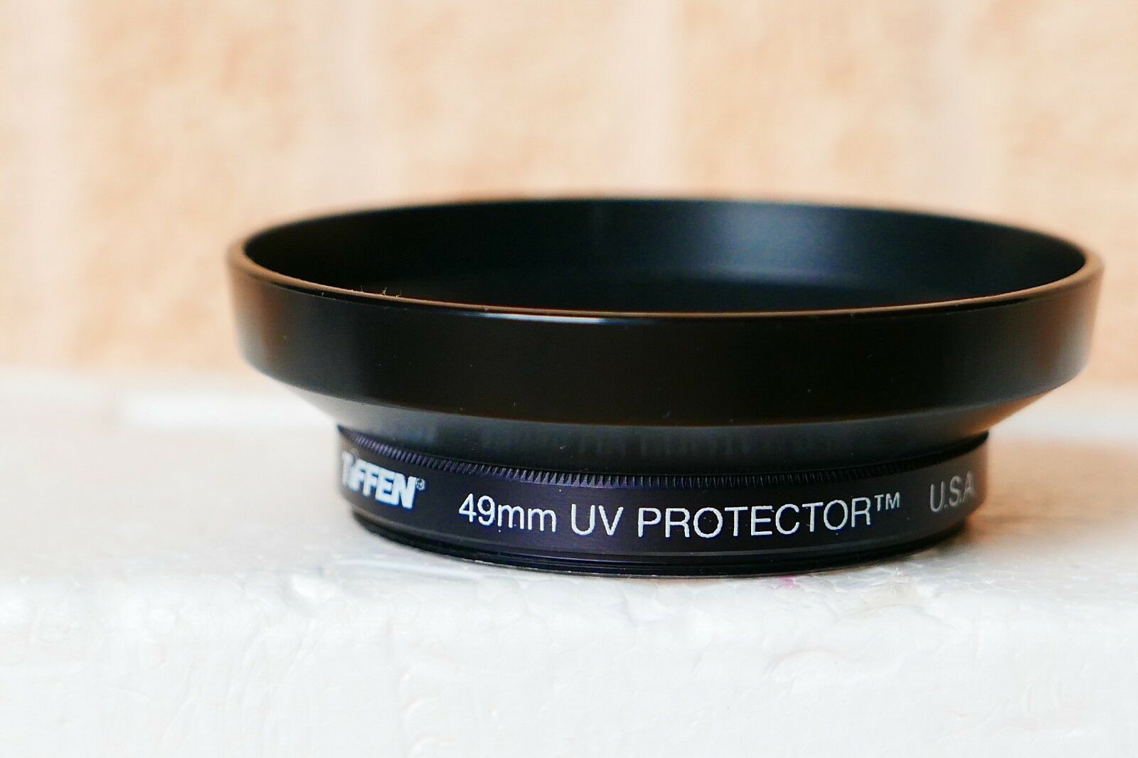

Look for one that is straight cylinder for 49mm thread, that's what original is. This one will most likely get in the rangefinder view.
Try this one
@Witold
Cool! Thanks!

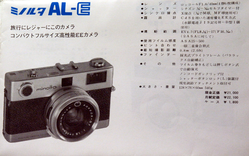

I wonder if this one would be quite similar in length to the original. Unfortunately, I'm unable to find a description of the factory hood's specific features, unless it's on here, but very unlikely.
I've attempted to locate an original Minolta AL-E manual, but there doesn't appear to be one available out there, even on butkus.org. I tried looking through a variety of Japanese web pages, however, I'm blocked from searching some of them because I'm currently on a school district computer.
Anyone know of a good website in English or Japanese that might have an original Minolta AL-E manual?
Thanks!
-Paul

All I can say is that my linked hood is similar in length to original and for me it would be worth trying for the price. The manual does NOT tell length / depth of hood, so just as well search google for orignal hood and look at images tab to eyeball comparison.
