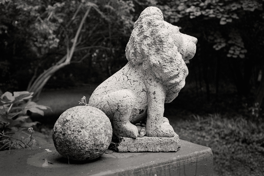

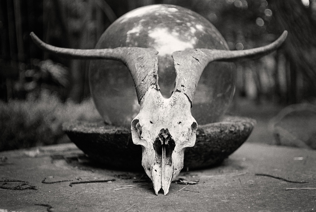

Here are the photos that started me down this rabbit hole. The first one (lion) was taken with the Schneider-Kreuznach Retina-Curtagon 35mm f/2.8, and the second one (skull) with the
Schneider-Kreuznach Retina-Xenar 50mm f/2.8. Both are from Ilford HP5+ negatives processed in stock D-76. I think what caught my eye is the way the out-of-focus areas are rendered, especially in those areas which are transitioning from sharp to not-sharp. The backgrounds have a little bit of a dreamy look, but perhaps that is due more to my light and depth-of-field than it is to the lenses(?)
