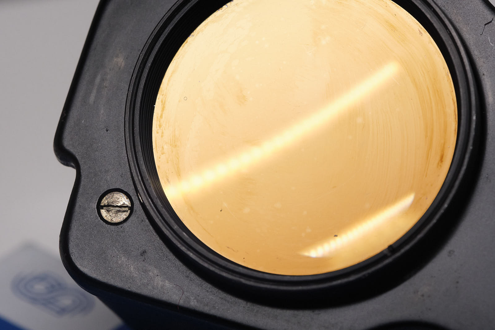

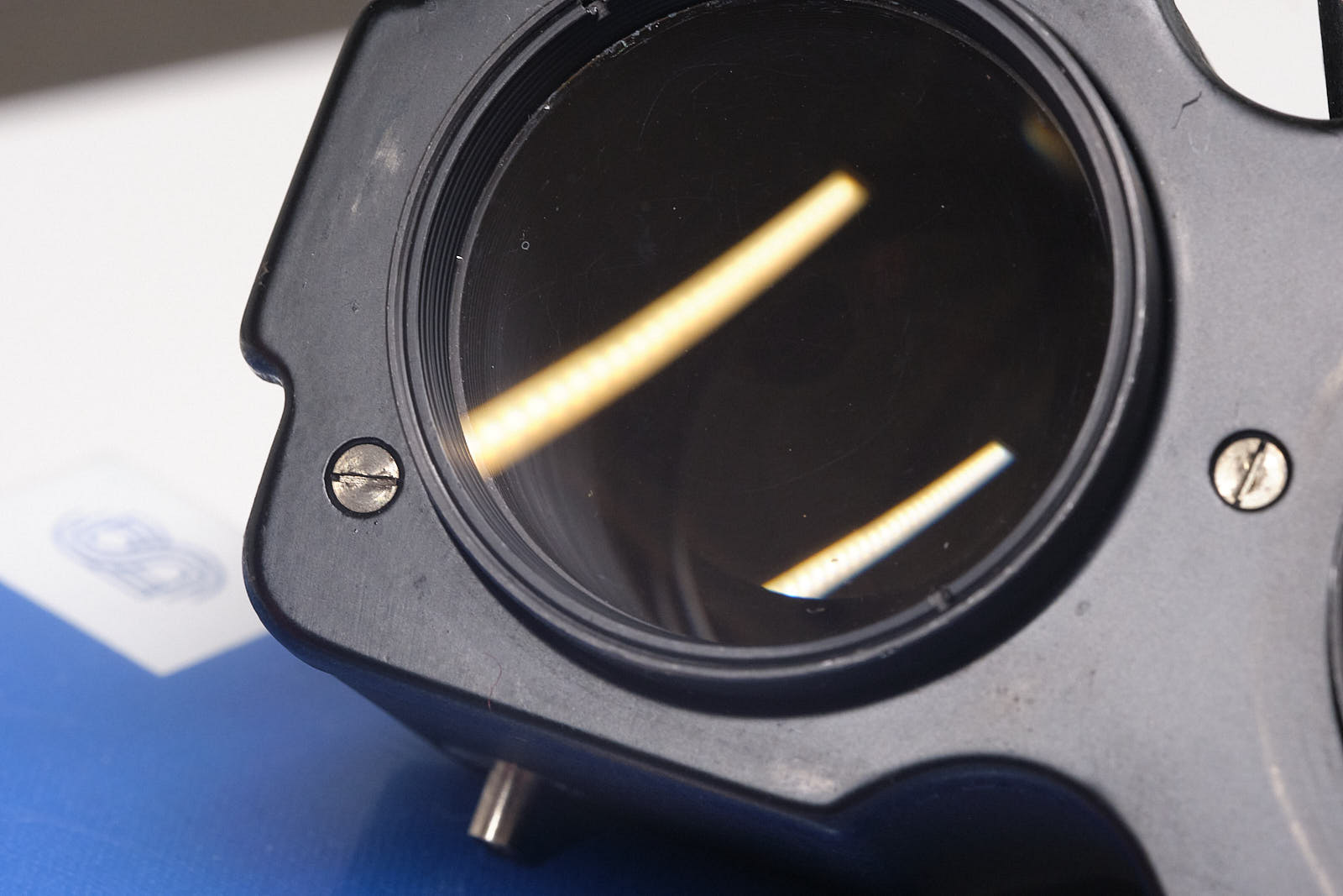

I know this topic has been brought up numerous times, but to this day I can't clean my lenses. I have 4 different cleaners and different type of cloth and I can always find an angle to look at the glass and see cleaning streaks. I clean again, they re-arrange or move around, but I can never get rid of them completely. Is it even possible?
Here's what I have:
And look at the results. At the first glance, the glass is pristine:
Look closer and it's kind of OK:
But then find a certain angle for the lamp light and THIS:
Am I hopeless? What am I doing wrong? As you can see in the first photo, I just succeeded at restoring the sticky shutter in this lens, I have to go back and nail down the cleaning now. The last photo is embarrassing. :smile:
Ihad my lenses professional cleaned by Nikon,put a filter on it and never cleaned them again!
Here's what I have:
have you washed yourhands thoroughly before touching your cleaning cloth?It's easy to transfer a little skin grease from the fingers to the cloth and from there to the lens.Then move from the inside to the outside in a circular motion.
