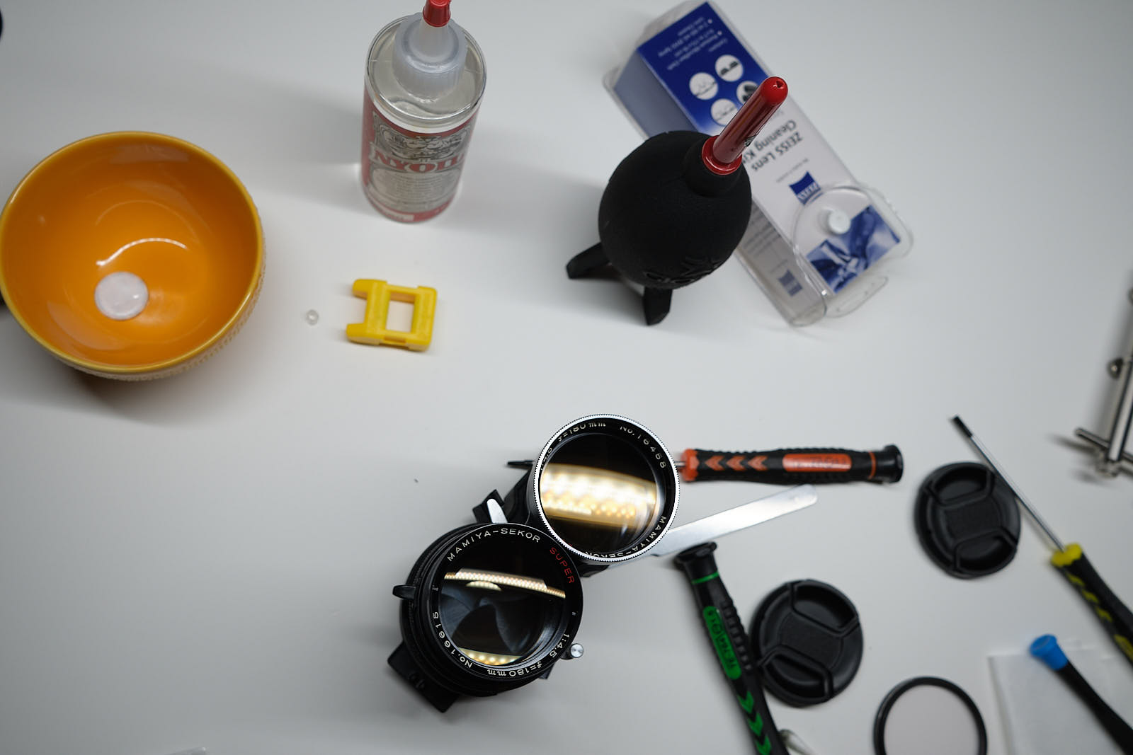

Here's what I have:

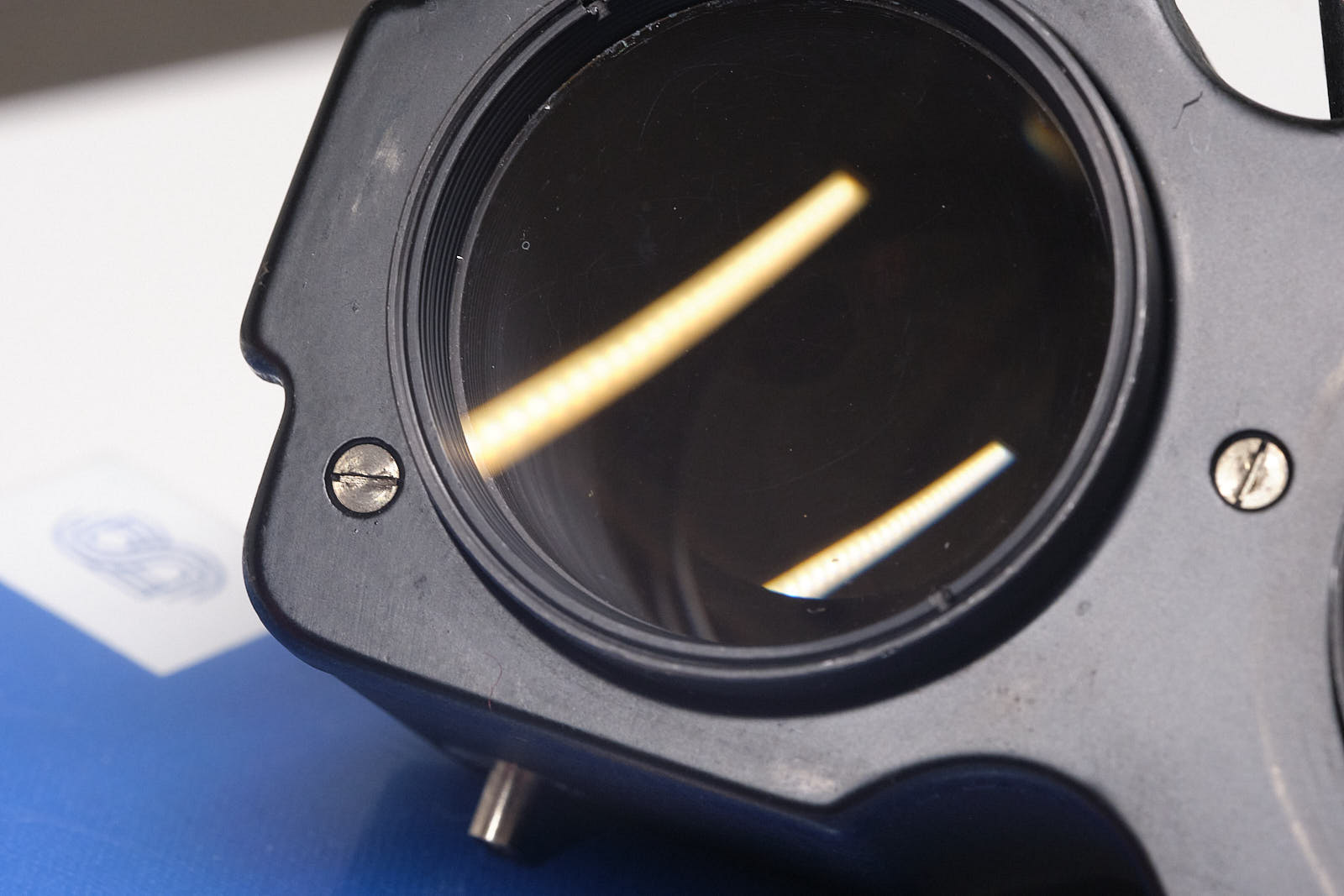

And look at the results. At the first glance, the glass is pristine:
Look closer and it's kind of OK:

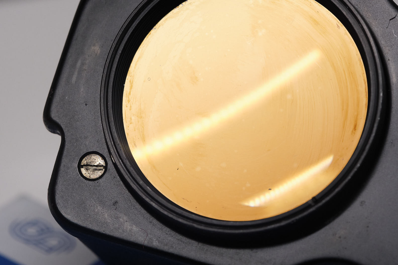

But then find a certain angle for the lamp light and THIS:
Am I hopeless? What am I doing wrong? As you can see in the first photo, I just succeeded at restoring the sticky shutter in this lens, I have to go back and nail down the cleaning now. The last photo is embarrassing. :smile:
What you're doing wrong is being obsessive. The mamiya lens is already perfect enough for shooting, those streaks won't do ANY effect on the picture. ANY.
ANY.
ANY.
Plus you might scratch the lens coatings if you're trying to clean it too much. Leave that 180/4.5 Super alone!!
But since you don't want streaks, i'll tell you where you are failing:
1. Cloth. Don't use cloth for cleaning lenses! Use lens tissue. Even smooth toilet paper will work better than cloth!
2. Cleaning fluid -- i get best success with glass cleaner. It is specifically designed not to leave any streaks, you know...
