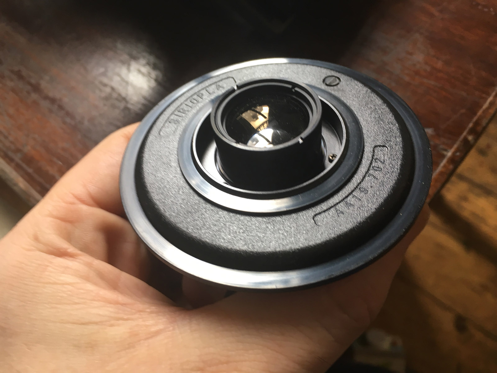

Show us the lens mount you already have.
I was thinking you would mount the existing mount to the enlarger, then mount the extension tube to the existing mount and then mount the lens to the other end of the tube.
Mike Chalmers
Mike Chalmers
Feb 23, 2019
179
London

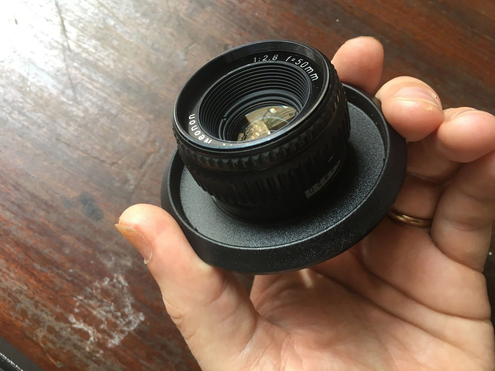

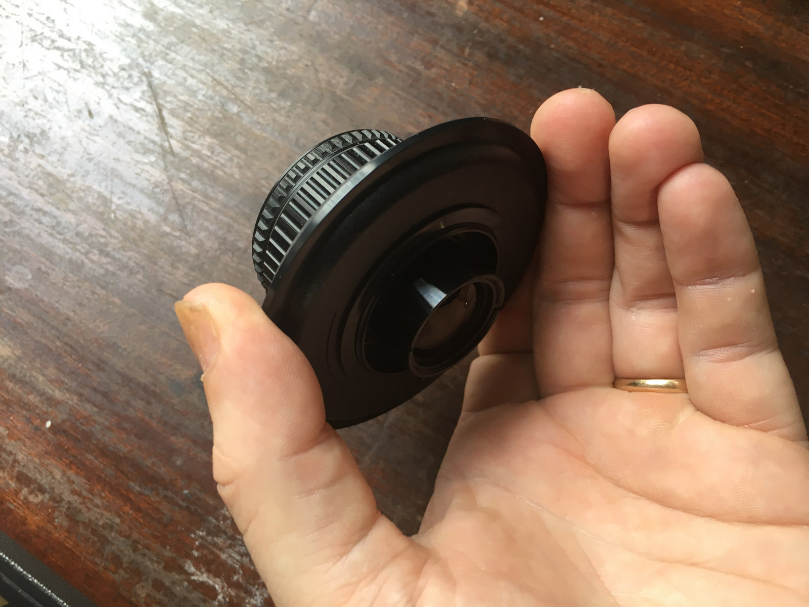

Here you go, boss.
This makes me think, as I think you said, the VEGATUB 39 will recess the lens upward, so it's high enough to keep it away from the negative because otherwise it would likely collide.
Can you tell is this lens mount (SIRIOPLA 39) uses a retaining ring? I'm not sure how to unmount the lens (as if I was going to swap the lens out), so any advice would be helpful as I don't want to start removing screws that I shouldn't. I'm wondering if it does use a retaining ring, if I can use it on with the 105mm (as both have 39mm thread) or if it's just a screw in anyway and no ring needed. It does not seem to want to unscrew and I don't want to force it and break something and looks like a retaining ring may be on the back.

The SIRIOTUB is for 50mm. The SIRIOPLA is for 80mm and up.
MattKing
Apr 24, 2005
52,906
Delta, BC Canada
As I understand it, the SIRIOPLA is for 80mm through 100mm, and the VEGATUB is designed for 105mm and up - but I'm always at least a bit confused when it comes to Durst parts.
Which means you (Mike Chalmers - the OP) have the 80mm lens on an incorrect mount - or at least a not-optimal mount.
That mount (the SIRIOPLA) may work with the 80mm lens if you limit the range of magnifications.
And the SIRIOPLA may work with the 105mm lens if you limit the range of magnifications.
By the way, just so the OP understands - while the "tub" in the SIRIOTUB goes into the head of the enlarger, and moves the lens closer to the negative, the "tub" in the VEGATUB extends away from the head of the enlarger, and moves the lens farther from the negative.
As for your question about the retaining ring, I can't tell whether the threaded ring on the mount shown is permanently part of the mount or whether it will come loose when you unscrew the lens. Try unscrewing the lens to find out.
Yeah, until - as Matt says - the 100mm and above range, which is what th VEGATUB is designed for.
I don't have an 80mm - in the pics is 50mm - and I have 105mm on the way.
I was wondering if I could get it to work at the range I want, negating the need for the VEGATUB.. The two sizes I most want for now are roughly 10" x 12" and 5" x 6". I'd like to see how this goes when the 105 arrives. However...
I can get the rear lens off, but still can't get the main lens part off. I don't want to force it as I can't help but use the aperture ring (s) when turning. It seems like it should just unscrew but I'm not managing so far.
Oops - sorry. I have been looking at too many photos of lens mounts. Does the enlarger work with a 35mm negative and that lens and mount?
Ha! No problem.

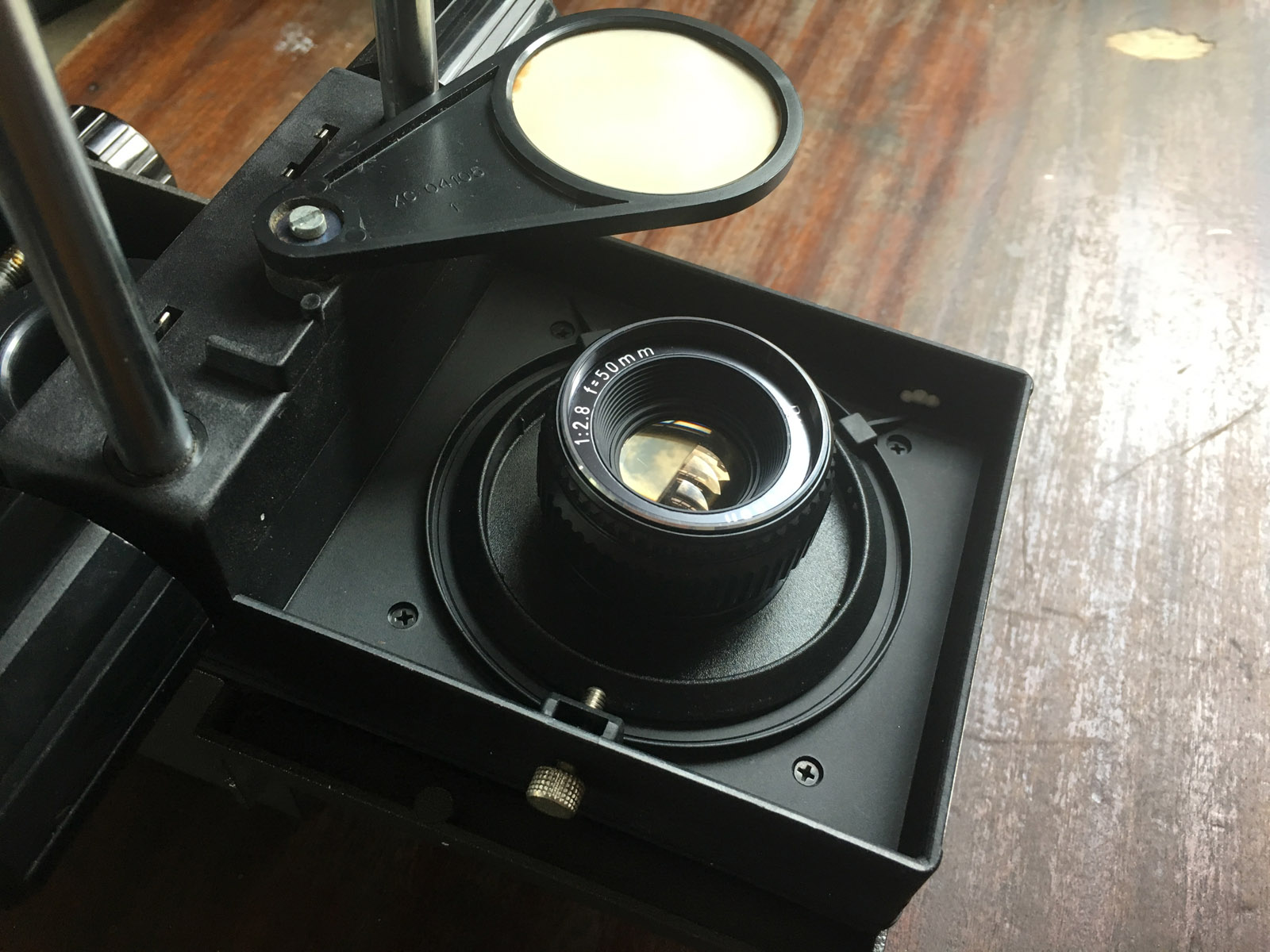

Yeah the SIRIOPLA and the 50mm I have is in a 35mm setup, which is how I bought it from a guy that made many prints. I've not printed anything myself, so I'm just assuming it works in this setup, but it would be crazy if it didn't.
When I got it I projected a 35mm through it onto the base board to check everything was working and all seemed fine and I focussed on the grain and did a timed exposure and all worked well so I don't know why it shouldn't.

See the photo I've uploaded below, which is a copy of one you uploaded earlier, to which I've added some cyan and red markings.
The screwhead I have circled in red may have been added to keep the lens from turning in the threads. Try taking it and any other similarly located screw out.
The black area I have marked in cyan may be the retaining ring, or it may be a part of the mount - I can't tell.
