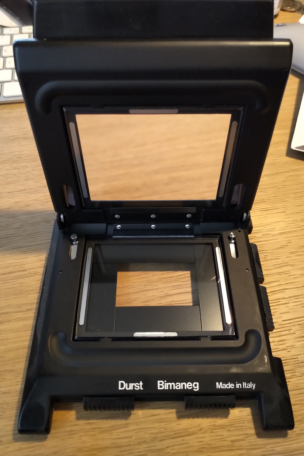

What kind of neg carrier do you have for 35mm? they are of 2 types: glass and glassless.
Glassless is fine for 35mm but you might run into film flatness issues with larger formats. I use my 6x9 glass carrier with all film formats I print. It's great but a dust magnet... there's no way around cleaning it as well as the neg with a can of compressed air prior to printing.
OH wow - yes I have glassless ones that came with the kit, but this looks ideal for using with all the formats I'll be using.. I'll look into this as I think it would be a big help for my kit.
By the way, let me know if you happen to be in Munich and let's have this beer!
Absolutely, same goes for London :smile:

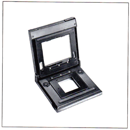

Durst nomenclature and accessory choice can be somewhat complex, but I would guess that if that carrier works with 6x9, it won't work in the OP's Durst M670.
My searches haven't led me to a link for a manual for the M670, but based on the manual for the M605, it looks like there is at least two different lens mounts -
SIRIOPLA for 80mm and SIRIOTUB for 50mm lenses - with a third mount for lenses 100mm and longer.
I'll have to look further into this, but thanks for the input. I do know that the M670 only allows up to 6x7. So maybe a DIY option would be worth a shot in the meantime..

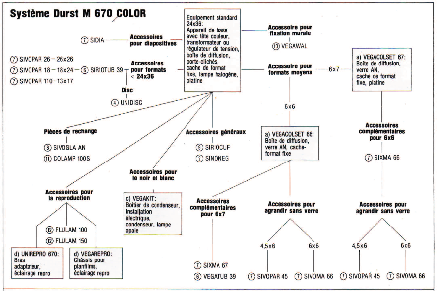

Yes definitely! It was not my intent to say he has to use the very same carrier - was just meant as an example. Sorry if my post was misleading.
Just trying to find an M670 user manual in English on the web, not much luck so far.
Here's one in French: http://durst.loremi.com/instruction/M670_FR.pdf
Man, is that obscure... and I am native French speaker! Apparently the glass carrier is called VEGACOLSET 67. It comes with an anti-newton glass and a few other accessories (such as a tube for the lens etc.). Mike, if you buy one, be sure that it is sold with all accessories unless you already have some. I don't feel like writing a full translation of the above text, but can provide you the important points if you wish. (also over the phone... we can discuss in pm)
That's funny I think we discovered that around the same time - I found an English manual: http://www.darkroomdave.com/wp-content/uploads/2019/06/durst-m670bw-m670color-operating-manual.pdf
