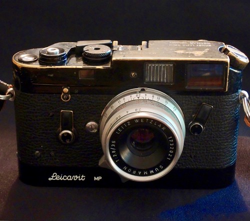

1968 M4 Tulip works fine. with and without the Leicavit
