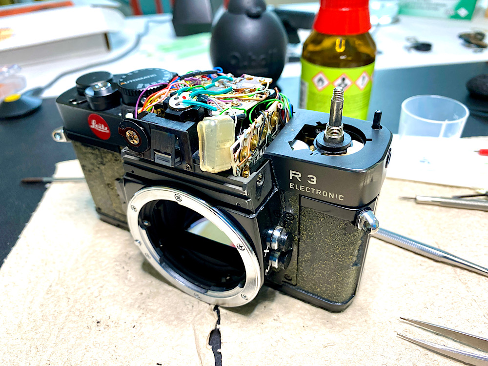

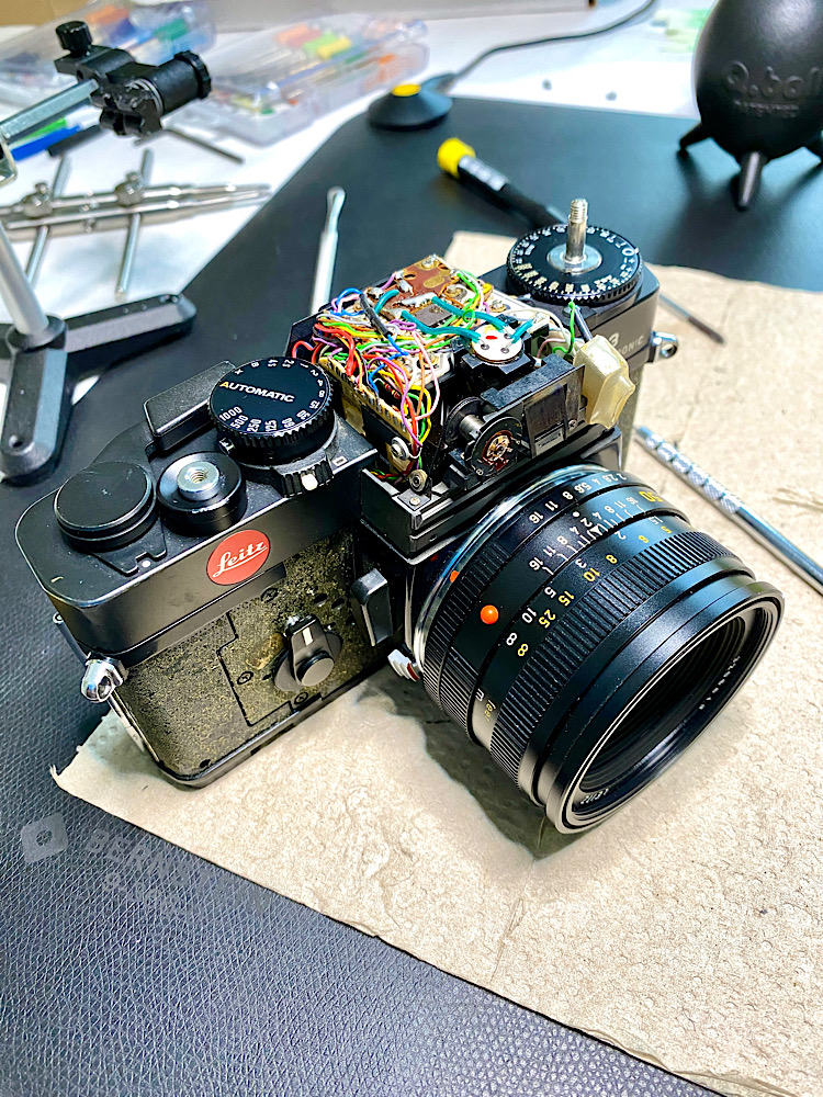

Disassembly to clean the mirror mechanism and the surrounding area
I made good progress with the disassembly.
And fortunately I was able to pull the mirror box far enough out of the housing without having to unsolder any cables.
The mirror mechanism is now accessible and I can clean and lubricate it.
The three upper housing parts must be removed.
Fixed to work

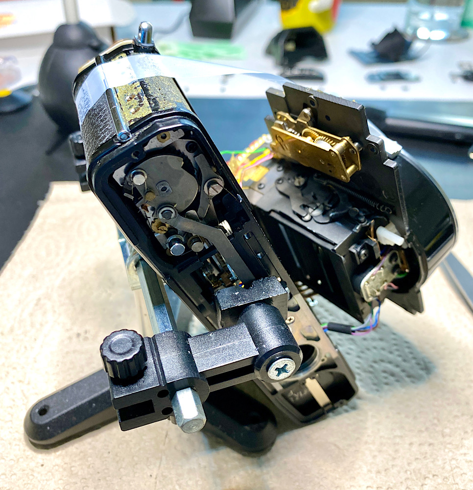

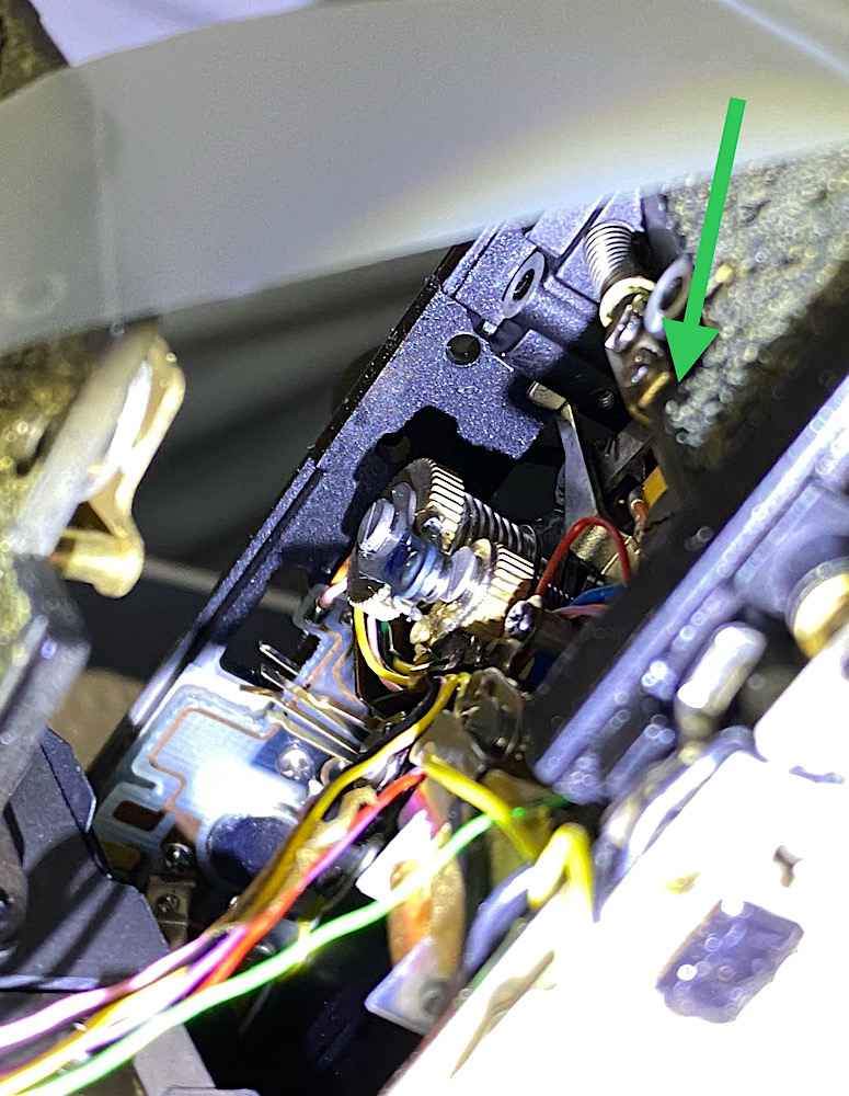

The mirror mechanism, which I tried to clean and oil from the outside with the syringe.
Everything looks dry. No oil or grease.
The arrow points up from the bottom to top for orientation.

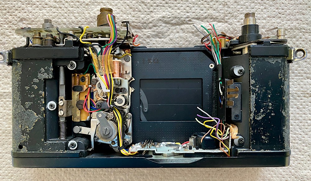

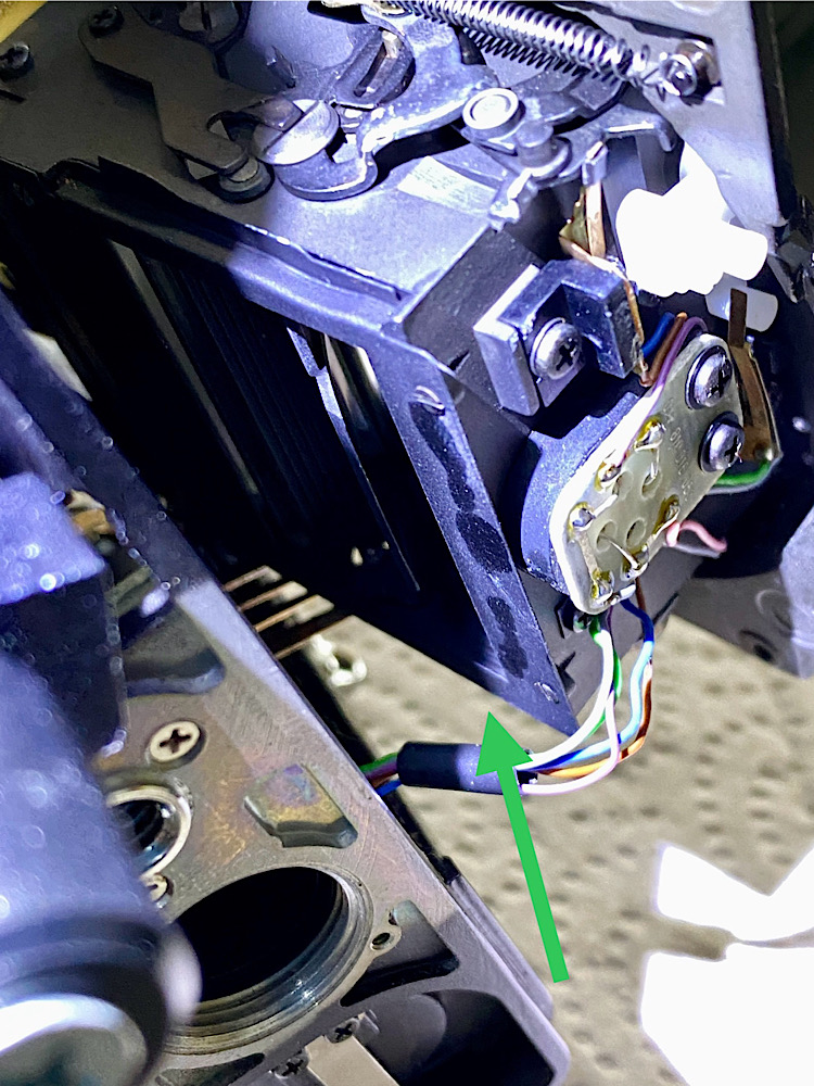

The oil I put in can be seen on the front shutter curtain, below the film window, on the bottom of the mirror box and on the bottom of the rear housing.
I'll clean that up as best I can with Zippo lighter fluid.
The arrows point up from the bottom to top for orientation.

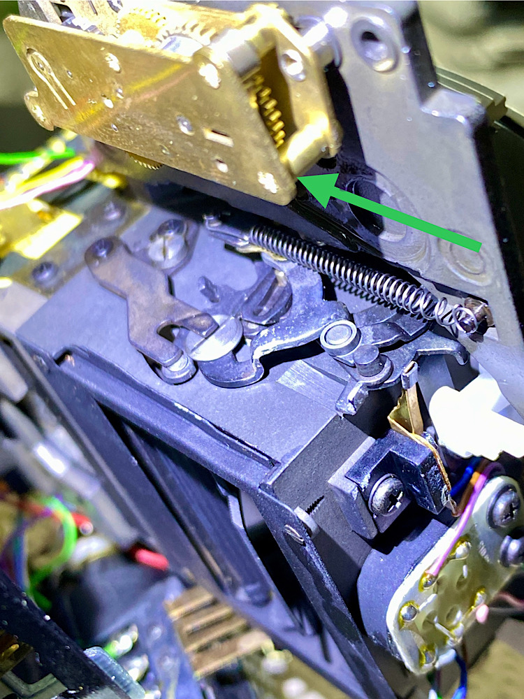

Oiling, assembly and testing
Since there is no longer any lubrication visible here and everything is dry, I use the oiler to apply some Nyoil to all accessible axes.
In my training R3 there were traces of grease there.
Leitz must have known what they were using to lubricate, I only use light oil and hope that it lasts. If not, that can be changed.

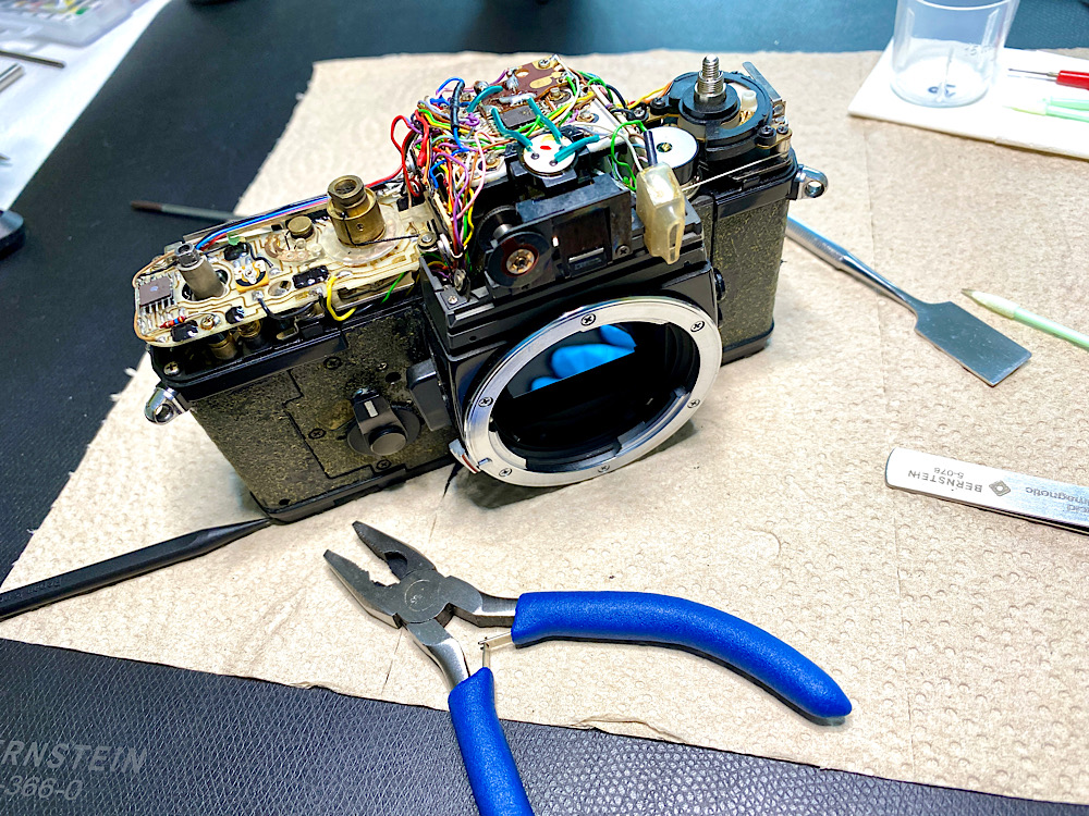

A first test to see if the camera triggers after installing the mirror box.
To do this, I cock the shutter and set the shutter times with the pliers, and trigger it with the spudger (plastic rod).
Everything is fine, the fixed shutter speeds sound plausible and the mirror now moves instantly without any delay 🙃
Attaching the two side top covers.
All controls are mounted.
Now, with a lens attached, I check aperture priority, both exposure metering modes, the metering memory and the combined ASA/exposure compensation.
Everything works 👍
The R3 is complete again 🙂

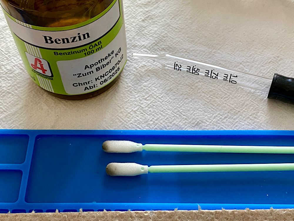

Overnight, the shutter blades that had been stuck together with oil came loose after I had dripped plenty of benzine onto them with a pipette.
Now the shutter and mirror are working again, with only a few interruptions.

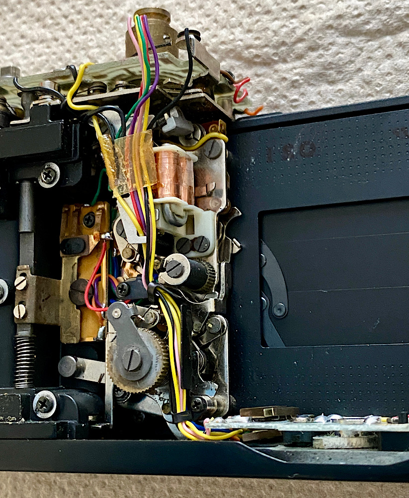

So I'm continuing with benzine and wiping the traces of oil off the blades after each movement. Until nothing more comes out. That will probably take a few days.
The alternative is to remove the shutter with its mechanism attached to the side.
To do that, I would also have to remove the circuit board in the top left of the picture and the coupling with the winding lever:
A laborious adventure that I really want to avoid 😌
