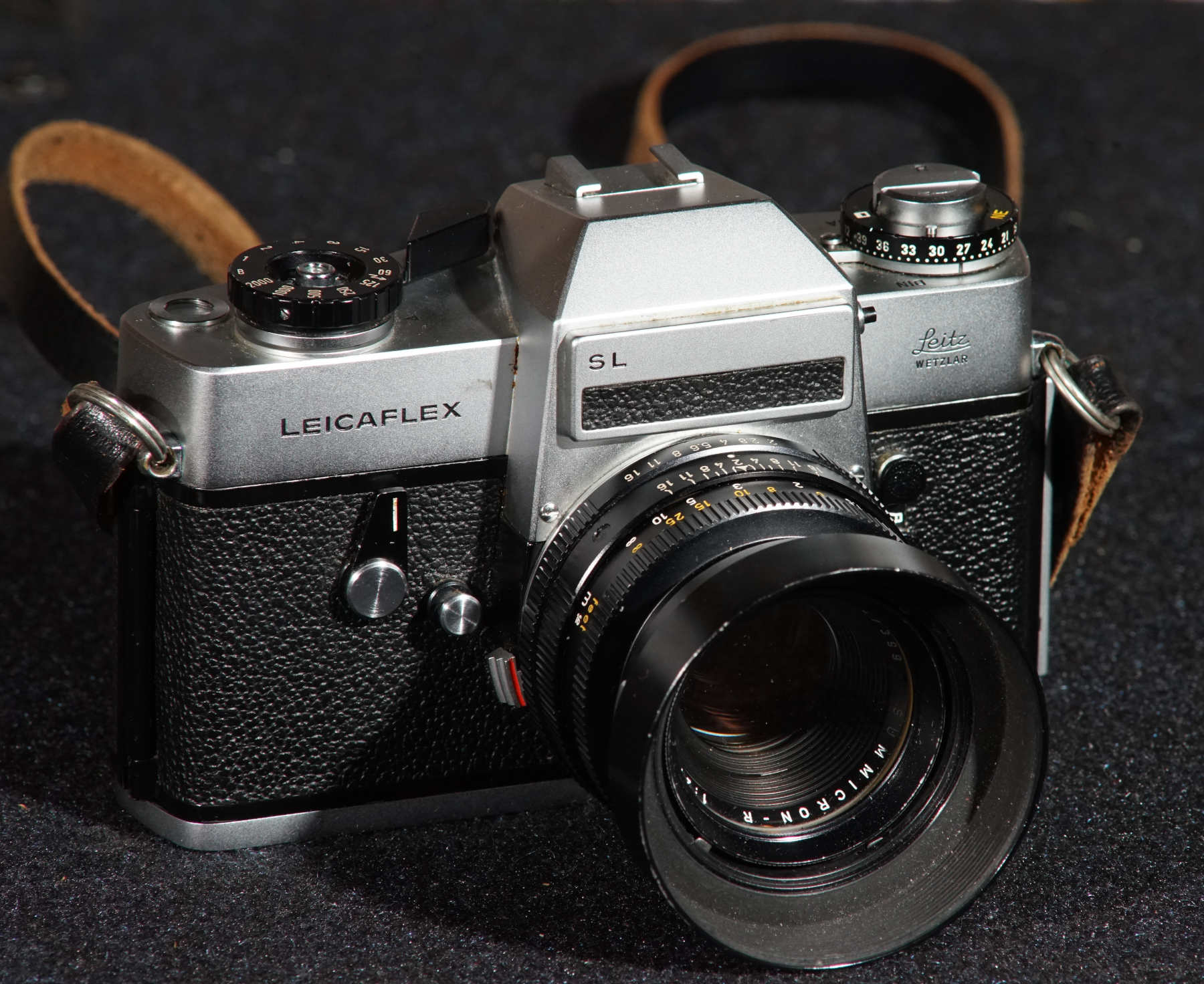

Though Contax RTS II are my main SLR cameras I'm very fond of this 1971 Leicaflex SL I found last year. It still needs a CLA and a repair of one battery contact.
  • But it's a pleasure to take pictures with this pure mechanical tool: massive and solid.
  • It gets extremely comfortable when I have to change lenses very quickly: even a bit easier and faster than with Contax/Yashica bayonet lenses - and much more easy and faster than with Canon FD lenses.

My SL2 will take 1,2, or 3 cam lenses. For metering I believe you need 3 cam. 3 Cam is all I have since I also have a R7. The SL has a slightly narrower throat and will not that the gorgeous 24mm. Maybe some other exotic lenses but I don't remember. They won't work with ROM lenses since some ROM lenses have no cams. An advantage to the SL2/SL bodies is that they are strictly mechanical and can be worked on by any decent repair person.

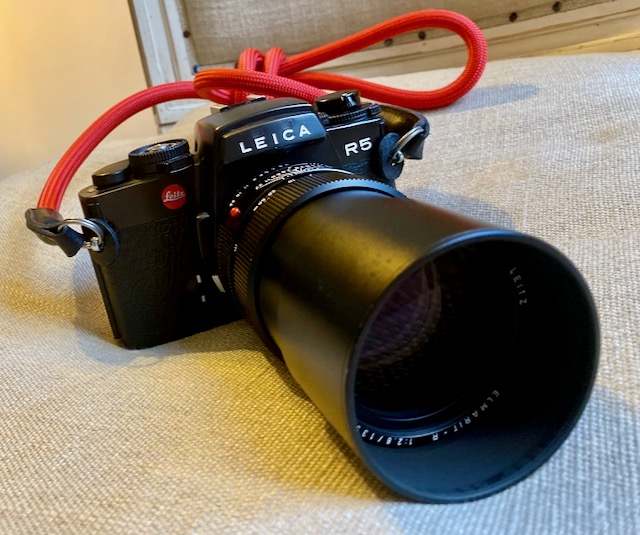

Any tips how I could tighten the 135mm/2.8 Elmarit-R's lens hood?
