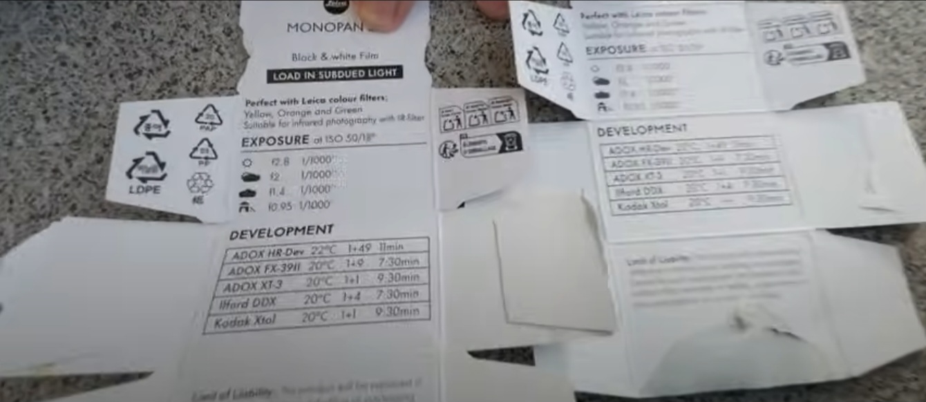

The datasheet for Monopan 50 basically confirms it.
Comparing it to HR-50's datasheet, the spectral sensitization curves are identical, as are the suggested developers and their times, down to agitation instructions.

Sounds indeed like Adox HR-50, see the rec. developers, too:

Saw that there was a video about it of a channel called Jamie & The Jam shooting it if anyones interested:
And a screenshot showing some of the dev times inside of the box:
So, f/0.95, f/1.4, f/2 and f/2.8 get the same shutter speed 1/1000. (I know Leica film cameras are topped at 1/1000) but that is over 2 stop difference, so you either over expose massively or underexpose massively. I dont know how HR50 holds that but that will make the photos very contrasty or washed out. For perfect cat pictures :smile:
