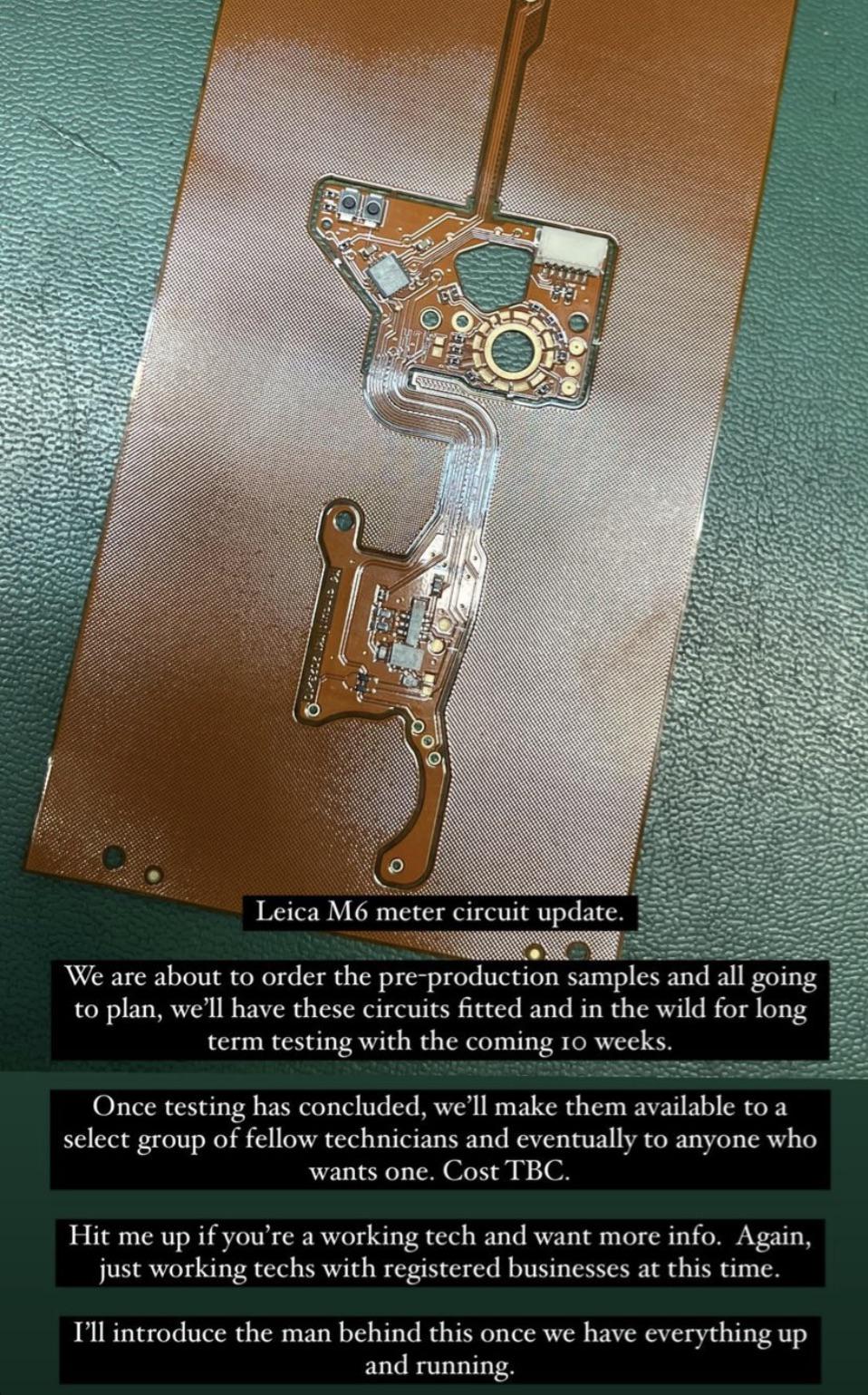

I don't think that's been in question. The specific question is whether the original M6 meters can be repaired. 'Last I knew, they could not.
I have the schematics here for that meter as well as a sample board to see if it can be fixed by "other means", but the circuitry appears to be either some kind of custom analog chipset or it is made with standard parts whose identifiers have been removed. So ... no joy on that front..

Ok, original meter circuit board can now be replaced and not repaired. Same as broken glass can't be repaired but must be replaced.

This is the part that I was unclear on. I had not heard that replacement boards for the original meters were available, only for the later meters, and those boards would not work in the original M6.
Who is sourcing the replacement meter boards for original M6s? Leica or someone else? Pricing?

Original classic M6 meter can be replaced (Amsterdam Camera Repairs is doing the replacements and supplying replacement boards to 3rd party repair shops). Meters in M6 TTL can not be repaired. 2022 M6 is currently in production and can be serviced by Leica.
Funny thing... A couple of years before ACR came up with the replacement M6 circuit boards, Cameraworks-UK were previewing similar project, but went silent on this until November 2024 when they published on their FB page that they are woking on a solution and that they should roll out replacement service in 2025. They also posted a picture of the circuit board (with ACR logo).
