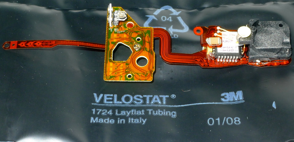

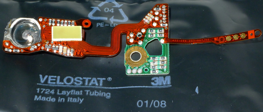

Y2kTLCrepair
Jul 5, 2025
8
North Carolina
"the old Non-TTL and TTL Leica M6 versions can't be repaired, due to the lack of spare parts of the light meter" Yashica
AND
"can the M6 non-TTL meter be repaired?" Arthutwg
Well, some of us still have *the main printed flexible circuit assembly in stock (a small LED fpc & the photocell unit completes the metering system). -
BUT, these 'parts' are rarely needed❗
The only reasons I ever needed to replace the classic M6 meter circuit (M6TTL but for the factory, was never available), was for either massive battery leakage corrosion, incompetent tampering or water damage (The flex is basically military spec ; very reliable).
Plus, the M6 classic meter can easily be calibrated (Not so for the M6TTL, but no worries, it never requires adjustment).💎
Apart from those physical issues, MOST every metering problem is caused by the film door ASA dial Variable Resistor (not the three gold contacts on the inside door).

Could you kindly explain a little further? The film door dial has always seemed to me a weak point in the design. If it becomes faulty, what is the usual cause; and is it repairable, or replaceable?

"what is the usual cause; and is it repairable"? snusmumriken
Cause?
When pushing the ASA center disc, the contacts become exposed to the outside elements (salty, dirty, dusty, sticky, wet fingers etc.).
This introduces sporadic connection/shorting to the Main flex inside the camera body (Meter issues ; i.e. Only one LED lights up or LED flickering etc.).
Repairable yes, unless destroyed by impact or water damage etc. the film door when carefully disassembled (Remove door from body, remove the four travel limit screws holding down the pressure plate and finally the small screws securing the plastic VR holder). The fairly heavy spring pushing back on the BRUSH disc (the one your finger pushes when one changes the ASA setting), is then loose. Now, without removing the three wires, the disc, Brush and VR surfaces can then be cleaned of contamination (using Naphtha light solvent). After-which a thin film of *DeoxIT FaderLube (Green) should be applied (Contact Electrolube for VR's).
*DeoxIT SHIELD (Blue) can also be substituted (2nd choice).
