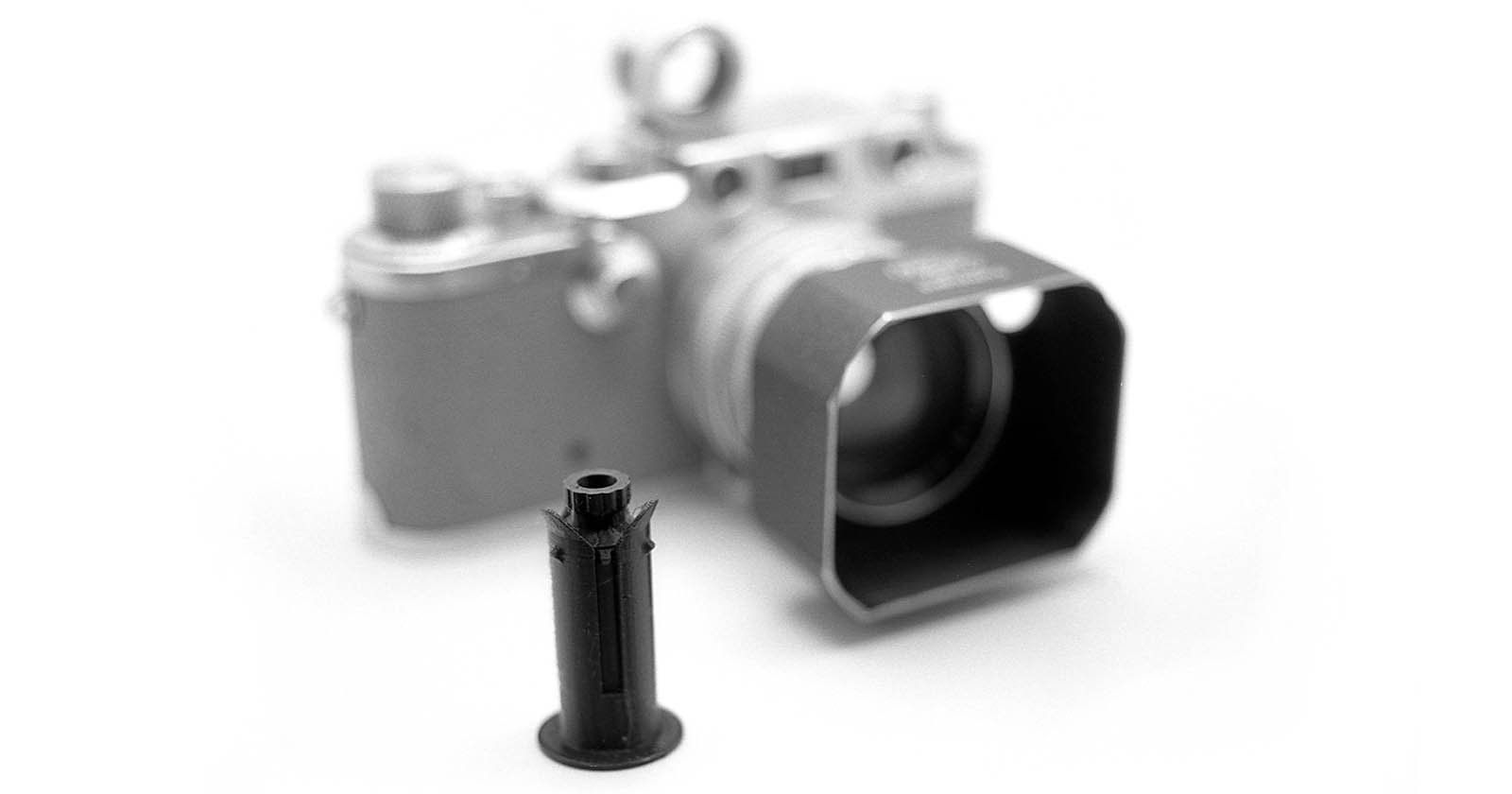

I bought the Ausegeknipst quickload spool for my Leica IIIC and Barnack copies and from testing loading it multiple times, you can load it without having to cut the film leader. Yeah I know some can do it without cutting....but for travel and not worrying about carrying a pair of scissors on a plane, I'll be using that spool.

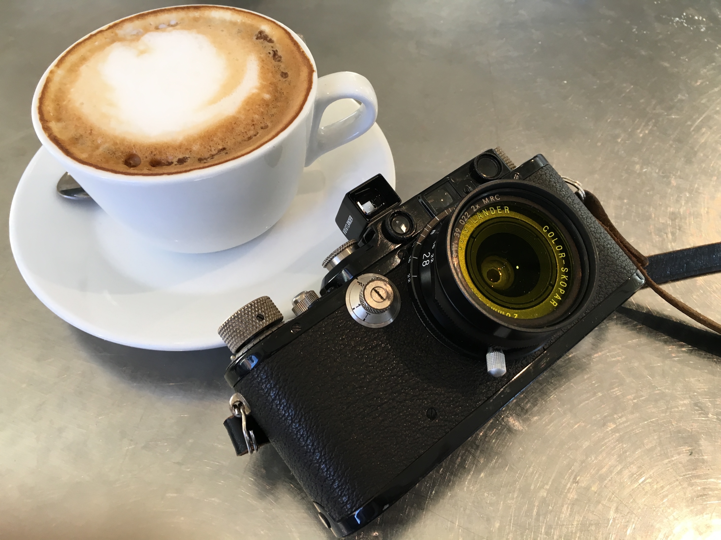

My absolutely favorite combo, and thus my street shooter, is the IIIf with a 21mm Color-Skopar and TT Artisan finder. That finder is big and bright and frames the scene close enough. Combined with almost no need to focus moment-to-moment, it's a great little setup.
