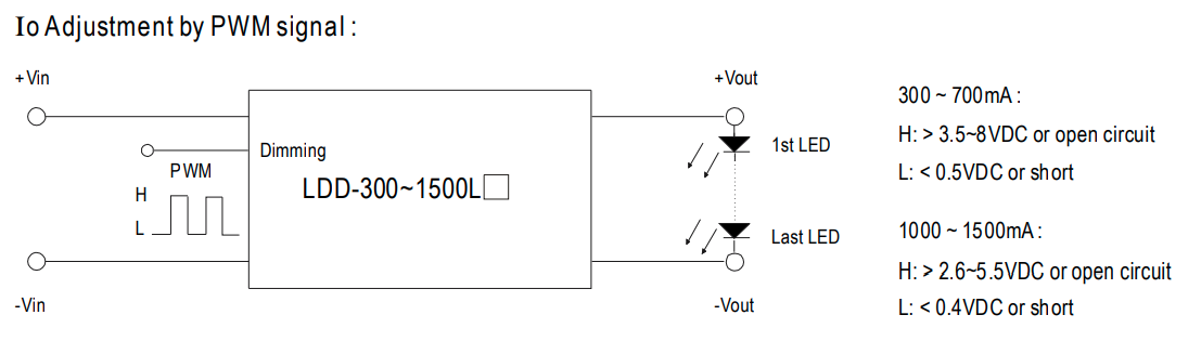

From the datasheet:
So for the 700mA product, the HIGH level on the pwm pin must be between 3.5V and 8V. The 3.3V output of a Pico will likely be a borderline case that may or may not work, and is therefore not recommended. Use a logic level translator (google it; ready to go modules are plentiful), or DIY a voltage translator with one (inverting) or two (non-inverting) MOSFETs and a couple of resistors. You'll also need a 5V logic supply that you can easily make by feeding the LED supply voltage to an appropriate stepdown converter or linear regulator that is rated for the intended input voltage.

From the datasheet:

From the datasheet:

The LLD-700H (and the rest of the LDD-xxxH series) accepts a pwm signal between 2.5 and 6VDC. They also take a higher input voltage so you can drive more LEDs.
Another option is the LDH-45A/B-700 step up driver. It also accepts a low voltage PWM signal.

Interesting, I was under the impression that the only difference between the L and H series was the higher input voltage. This is getting very close to solving all of my problems.
