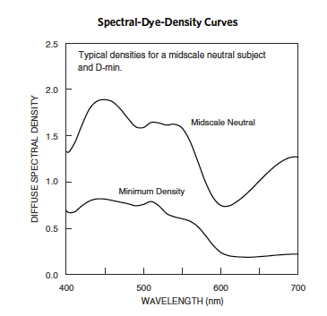

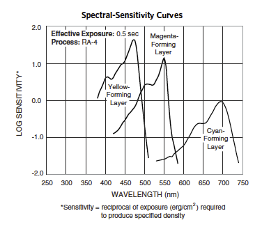

I've attached the Spectral Dye Density curves for Portra 400 and the Spectral Sensitivity curves for Endura.
I'm probably reading things wrong, but the dye peaks for the film look to be about 450nm, 520-540nm, and 690nm. Where as the paper looks to be most sensitive at 475nm, 550nm and 695nm.
They are obviously close, but I would have thought they would be a bit closer. As far as choosing the correct LEDs goes, it looks to me that getting 450nm Royal Blue would be better than a 475 Blue, simply because it will have less overlap with the green (maybe allowing better blue/green separation in the prints). The green choice seems to be fixed around 530nm, and the red around 625 (which seems too low to be ideal, but upping the brightness should allow it to expose the cyan forming layer).

Photo Engineer
Apr 19, 2005
29,018
Rochester, NY
First, you subtract the color mask density from the dye density and then you subtract the 50M and 50Y CC filter densities from the color paper. This will give you what the paper "sees" when it "looks" at the film. This assumes white light printing. Once you do that, the spectra look quite different.
So, just looking at those curves can be misleading. Particularly since they are on drastically different scales for the wavelength. The paper curves also do not show the blue sensitivity of the R and G layers which further alters that data.

Photo Engineer
Apr 19, 2005
29,018
Rochester, NY
If you look at the color paper, you will see peak sensitivity at 700 nm, and you will see a "hole" to the left which is where the WR13 allows passage of light for the use of a safelight. These two facts are not accidental!
PE
I had forgotten about the orange mask. It makes sense now is adding into making the curves look lumpier than than I expected. I am guessing the orange mask is what is showing up on the minimum density plot and needs to be subtracted from the midscale neutral plot.
Wouldn't subtracting out the 50M and 50Y from the paper be superfluous? I thought the initial filter pack was there to remove the orange mask. Or is there an additional mask density for the paper too?
Photo Engineer
Apr 19, 2005
29,018
Rochester, NY
The paper wedge spectrogram is "doctored" to eliminate the blue sensitivity of the red and green layers. If you actually saw this in color, the bottom of the yellow would be almost black.
By adding the CC filters, the curves are modified and the speeds of the B and G are decreased. This results in equal speed in all layers and so the heights of the curves are equal. As it is, the blue has an ISO speed of nearly 100 while the red is only about 25. When done, the paper is about 25 due to the mask and the filter pack.
See my other post on peak sensitivity of the layers.
