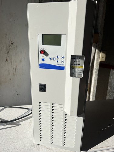

This is overkill, lots of used circulation bathes on Ebay, 200 bucks.
