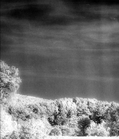

Just wanted to update the thread because it appears my problem is solved. I attached a scan of a section of a print with the subtle but noticeable vertical streaking in the sky.
Evidently the problem is defective paper. After 23 print/test runs trying different ideas and techniques, my problem disappeared immediately after I decided to cut the print out of the mural roll 90 degrees to the way I had been cutting it. In other words the inconsistent density is apparently in the emulsion, running in lines the length of the roll. In that case the streaks must still be in my 90 degree corrected prints, but they’re not noticeable because of the streaky cloud formations (see attachment).
Maybe there’s another explanation I haven’t thought of, but I think I’ve ruled everything else out. Are emulsion coating issues very common (or could X-raying of imported paper do this)?
Thanks, and hope the thread helps out others trying large prints – it’s great fun and really not hard to do even in my 6x11 darkroom!

Your problem was hard to diagnose from the earlier posts, but I think you nailed it here. It is probably a coating defect. But I hasten to add that it is rare with Kodak, Ilford and Fuji products. From posts here it is more common among the 2nd and 3rd tier manufacturers. Examples of this kind of defect have been posted here by myself and others from some of those 2nd and 3rd tier manufacturers.
You appear to have a valid complaint.

...my problem disappeared immediately after I decided to cut the print out of the mural roll 90 degrees to the way I had been cutting it...
That's what I already suggested, no...? (in my first post on the subject)
Yes Sparky, and you were right! I was reluctant to blame it on the paper and not my technique... There's a lot of bumbling and fumbling involved learning how to handle curly mural paper in a small darkroom. I uttered a few choice phrases from time to time for sure.
After several darkroom sessions and about 10 yards of paper working out this problem, I really got a lot of practice and worked some bugs out, thanks to all the APUG'ers who chimed in. Scrolling in a tray or trough is much preferable to see-sawing with a roller weight to hold the paper in the trough. That's too much like exercise for me. Someday I hope to post up an article/pictures/video on what I've learned to help others with smaller darkrooms get started. All size prints are cool but hey, why shouldn't a good photograph have the same presence and scale as the average painting if you feel like it?
