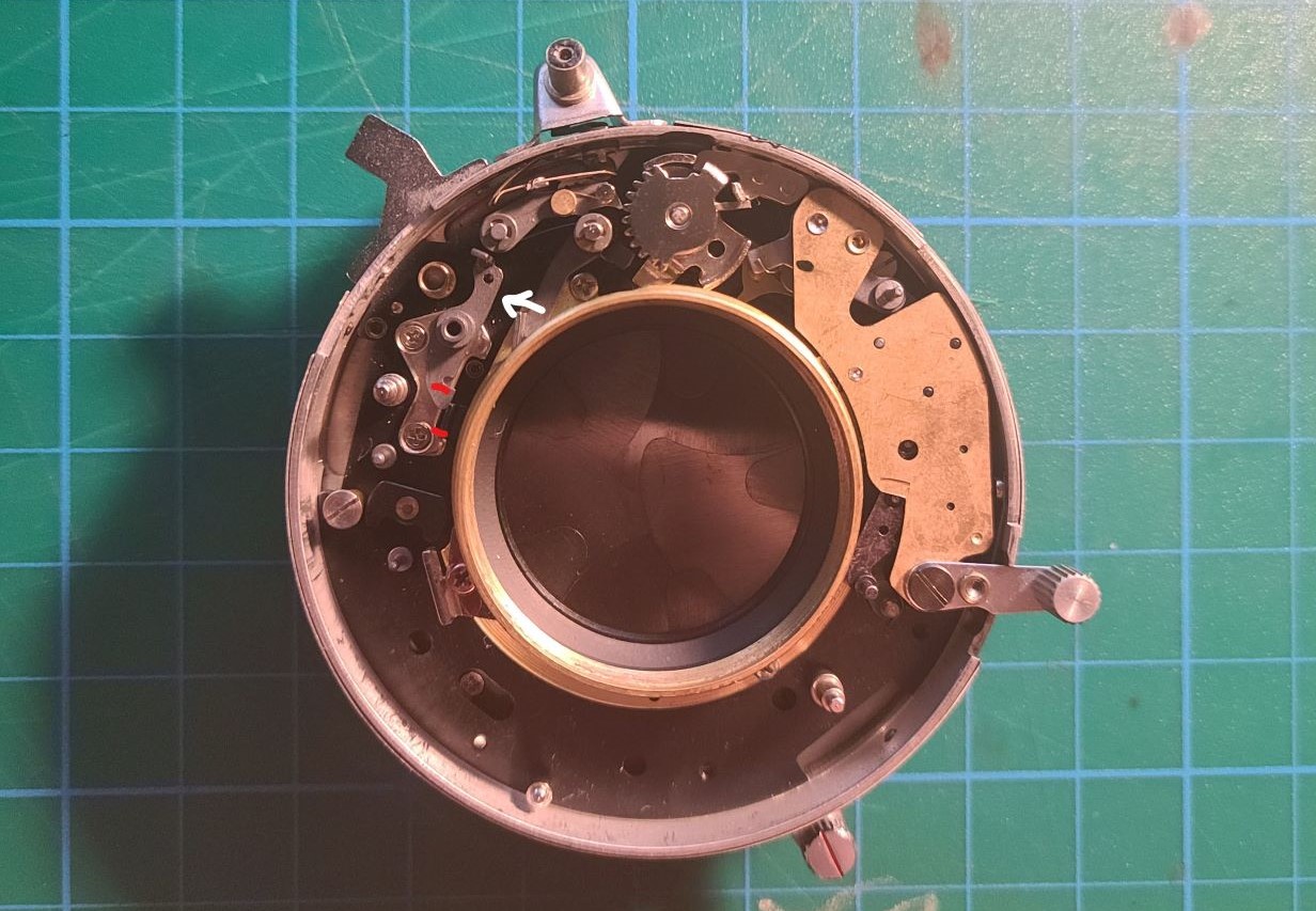

Hello everyone

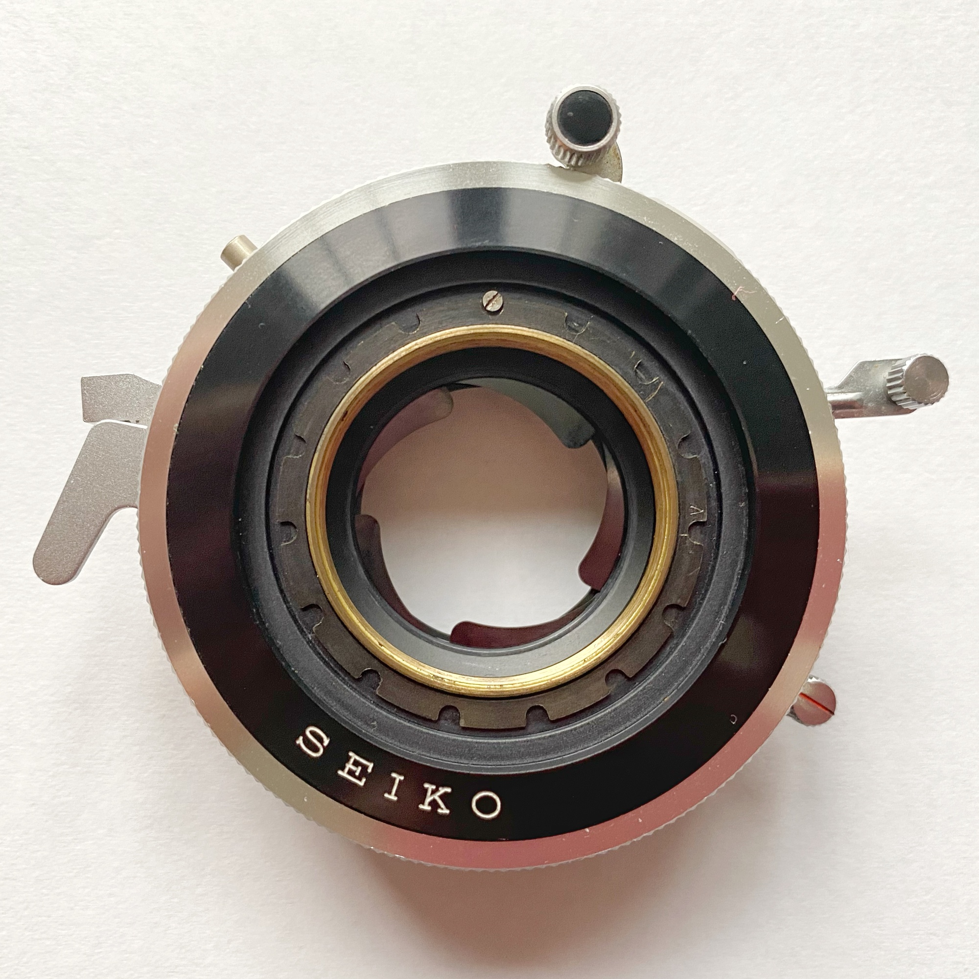

I have receently got a Seiko shutter labelled "LS 25" that was listed as poor condition and I was wondering if anyone was familiar with it. The diaphram does not open when I try to fire it, so I'm taking some time to dissassemble, clean, and lubricate it. I'm running into trouble because unlike compur shutters, not much is written about Seiko repairs.
From here does anyone know what assembly comes off next?

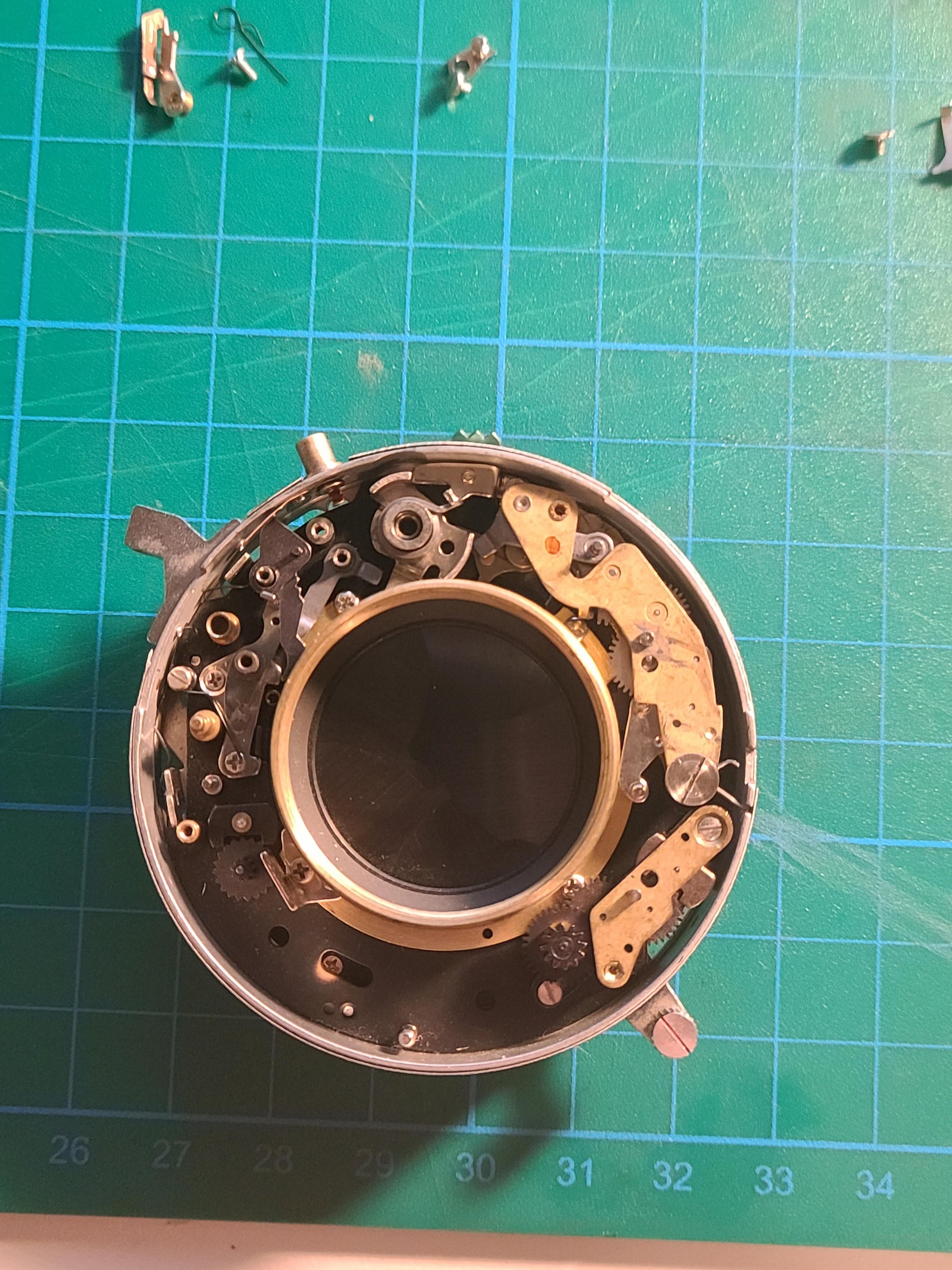

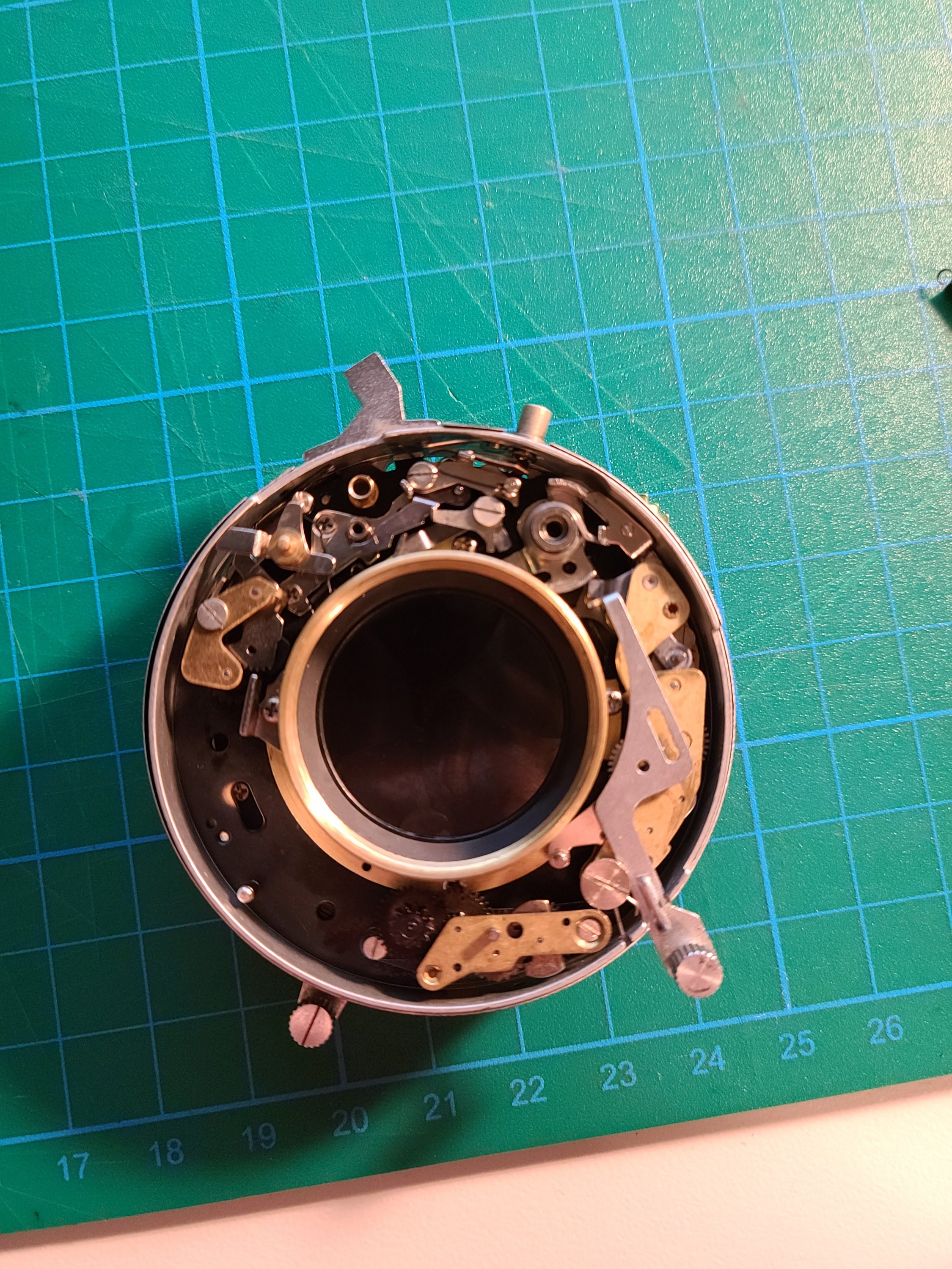

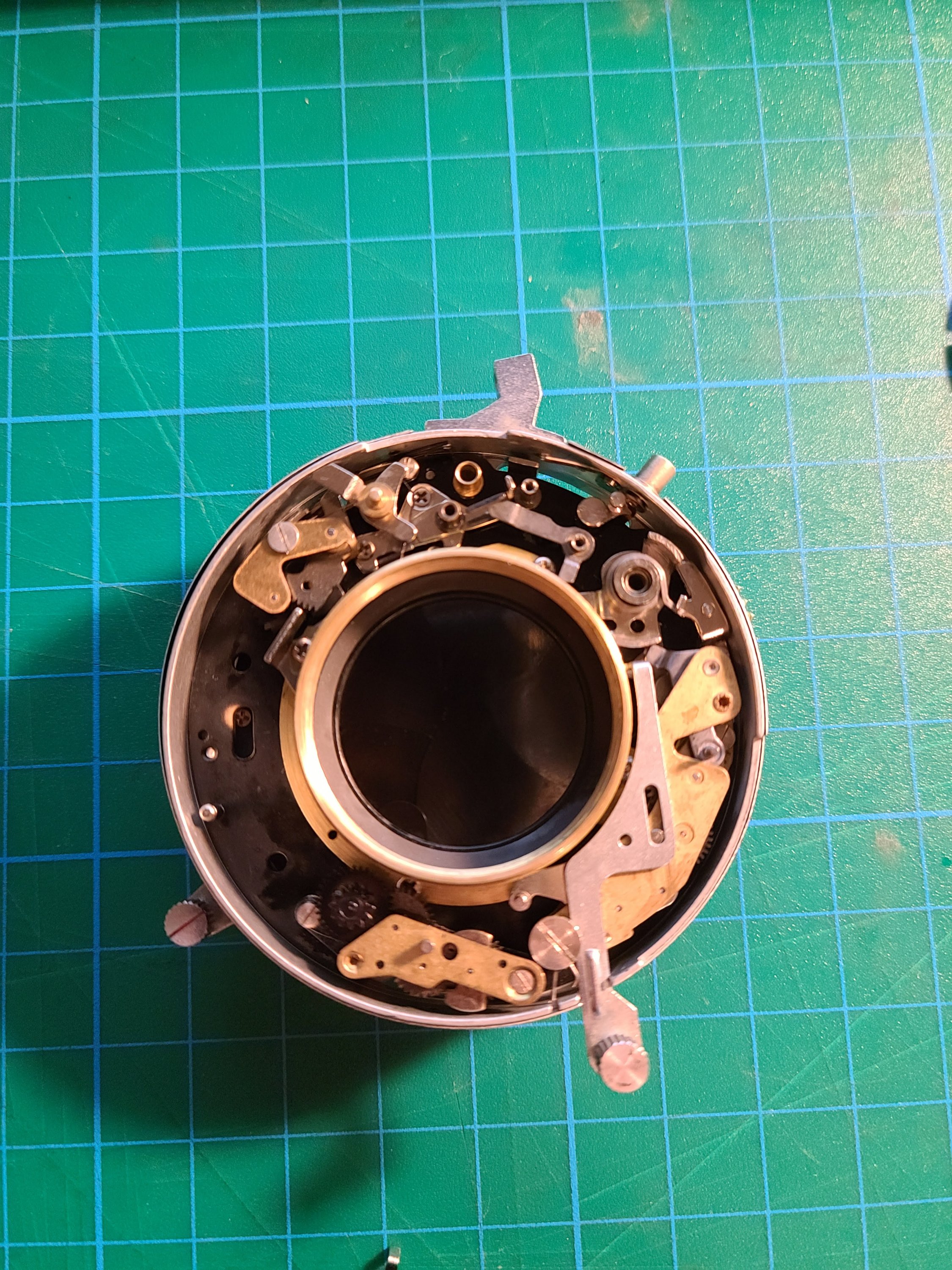

I have. The Mamiya related guide helped me through the issues with the diapragm opening problem but the issue with bulb remains. I can't seem to find where any sort of bulb lever interfaces with either the cocking ring or the cam ring.

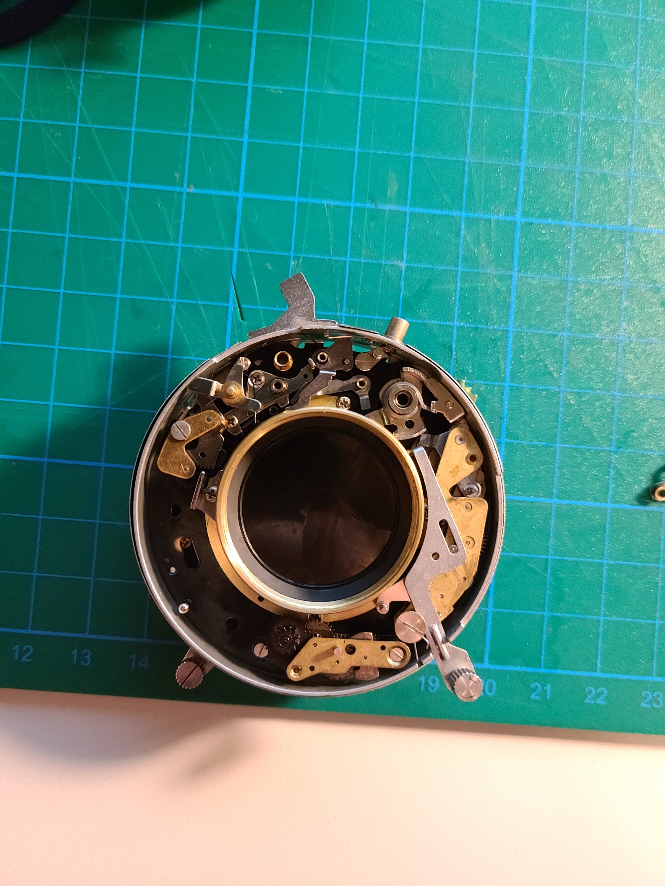

Here are some images of the shutter fully assembled without the cam ring, with the cam ring, and with the cam ring set to B.
I just can't find the bulb lever (or mechanism)

The shutter speed cam ring has a cutout that allows the bulb lever (which is held inward toward the shutter by the shutter release lever) to move toward the outside of the shutter housing when set to B. Your third photo shows the correct setup for B operation. If you are not getting B then you have an issue with the lever underneath the B lever (likely a spring problem) and it is not latching the blade opening ring. The B lever is making contact with the top right of the shutter release lever.

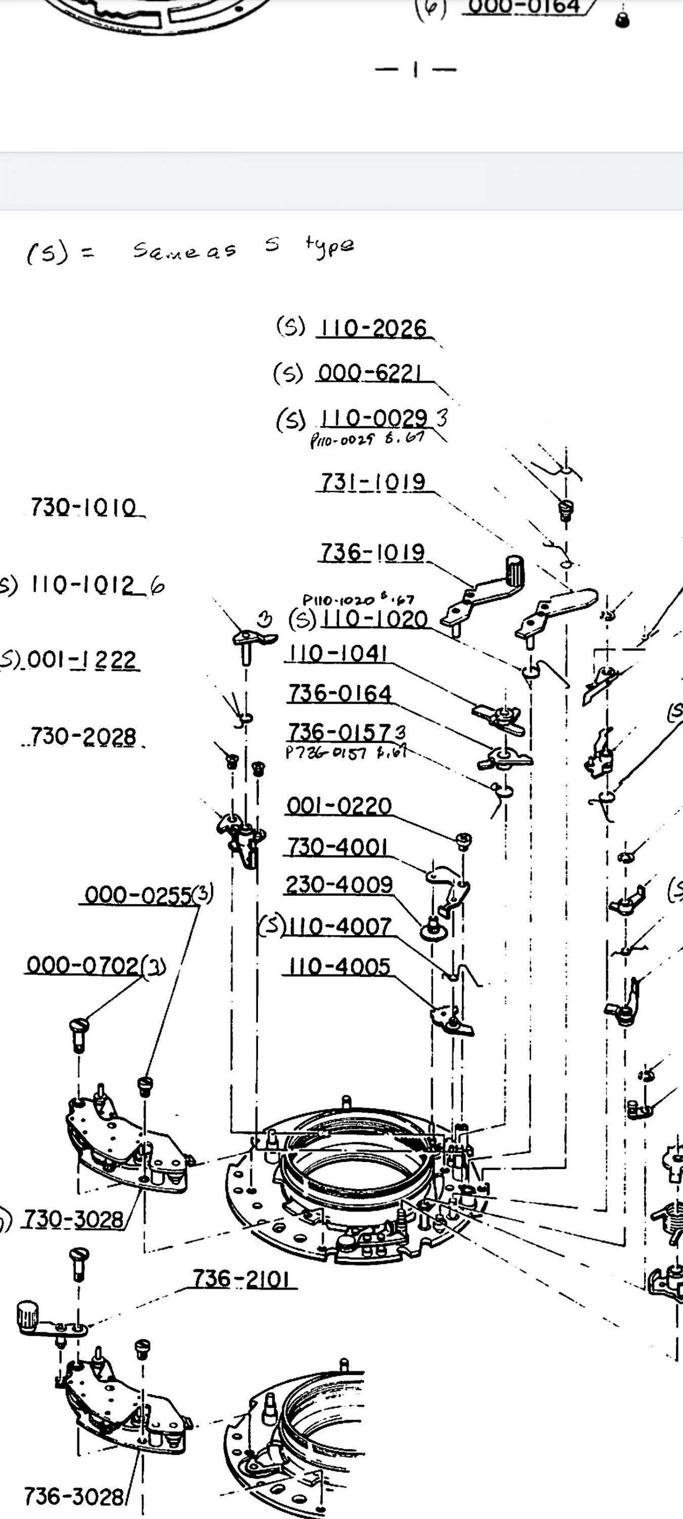

Hmmmm. If the B lever is part #736-0164 there may be a problem because I don't have it! Here's the shutter cocked sans the cam ring.
If the part I mentioned is the B lever then I have a second shutter I recieved with the lens that does have it and I can work from there.

Part 736-0164 is not the B contact lever. You do have the lever in place, I can see it in all your photos. It is making contact with the upper part of the shutter release lever (this is the lever that you press to release the shutter). It is part 730-4514.
Forgive me if I'm wrong but part 730-4514 is to the right of the release lever. 110-1041 looks to be at top left of the shutter release lever. I may be getting this confused though as this is only the second shutter I've worked on

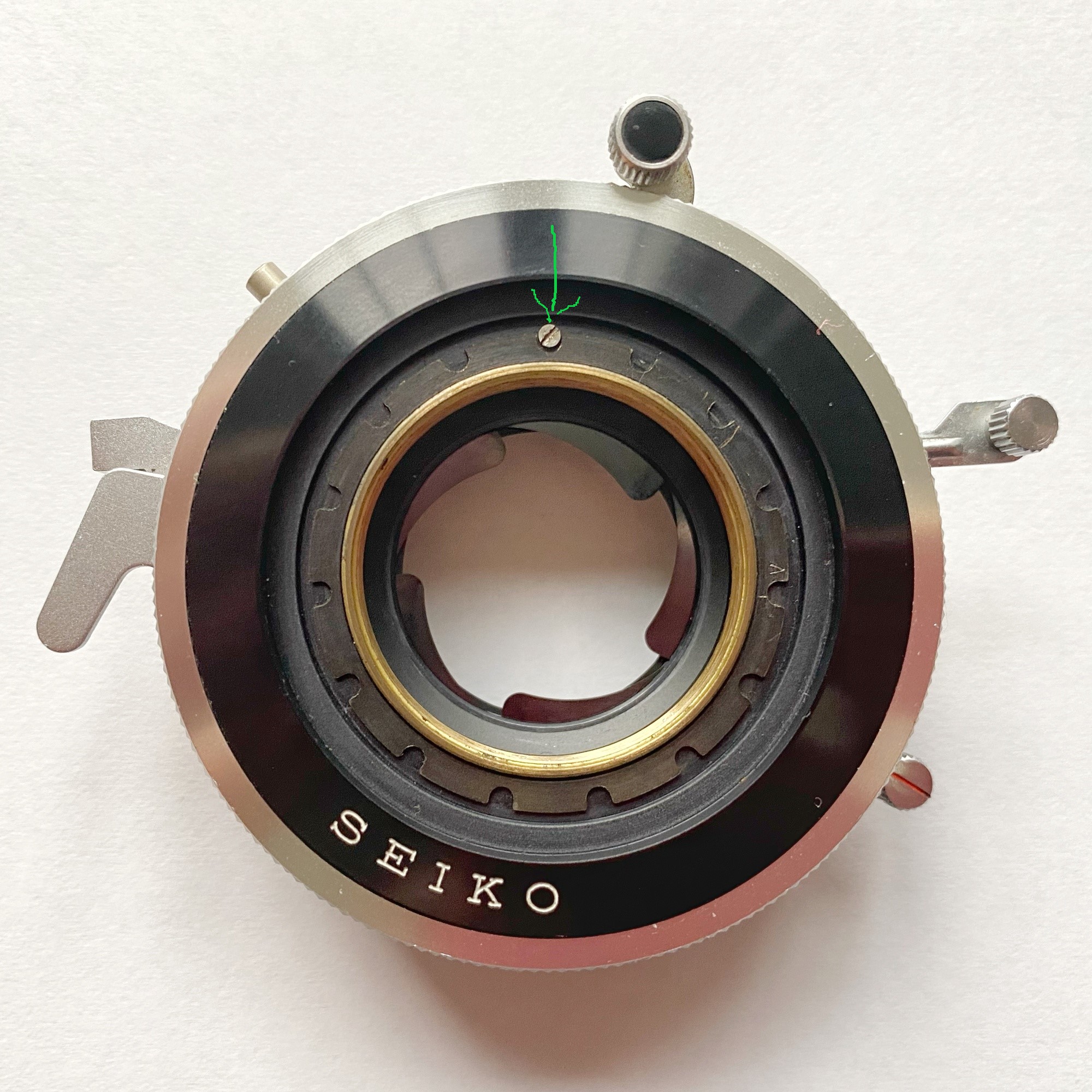

seikoshutter_edited.jpeg remove the screw at the green arrow , its about 1 mm long. Unscrew the ring counting the number of turns to remove it, record for future reference. Several notches have scratches so this ring has been off before. If too loose the speed ring will have up down movement and might allow a pin from the mechanism to come out of its slot, too tight will make the speed setting hard to turn and the shutter hard to cock.
With the notched ring removed the black cover will lift off then the speed ring will lift off. Set the speed ring to B or T before removing and note its reference to the cocking or trip lever. Once the speed ring is off take another picture of the shutter and post it here. Do not turn the shutter face down as a part or screw may fall out.

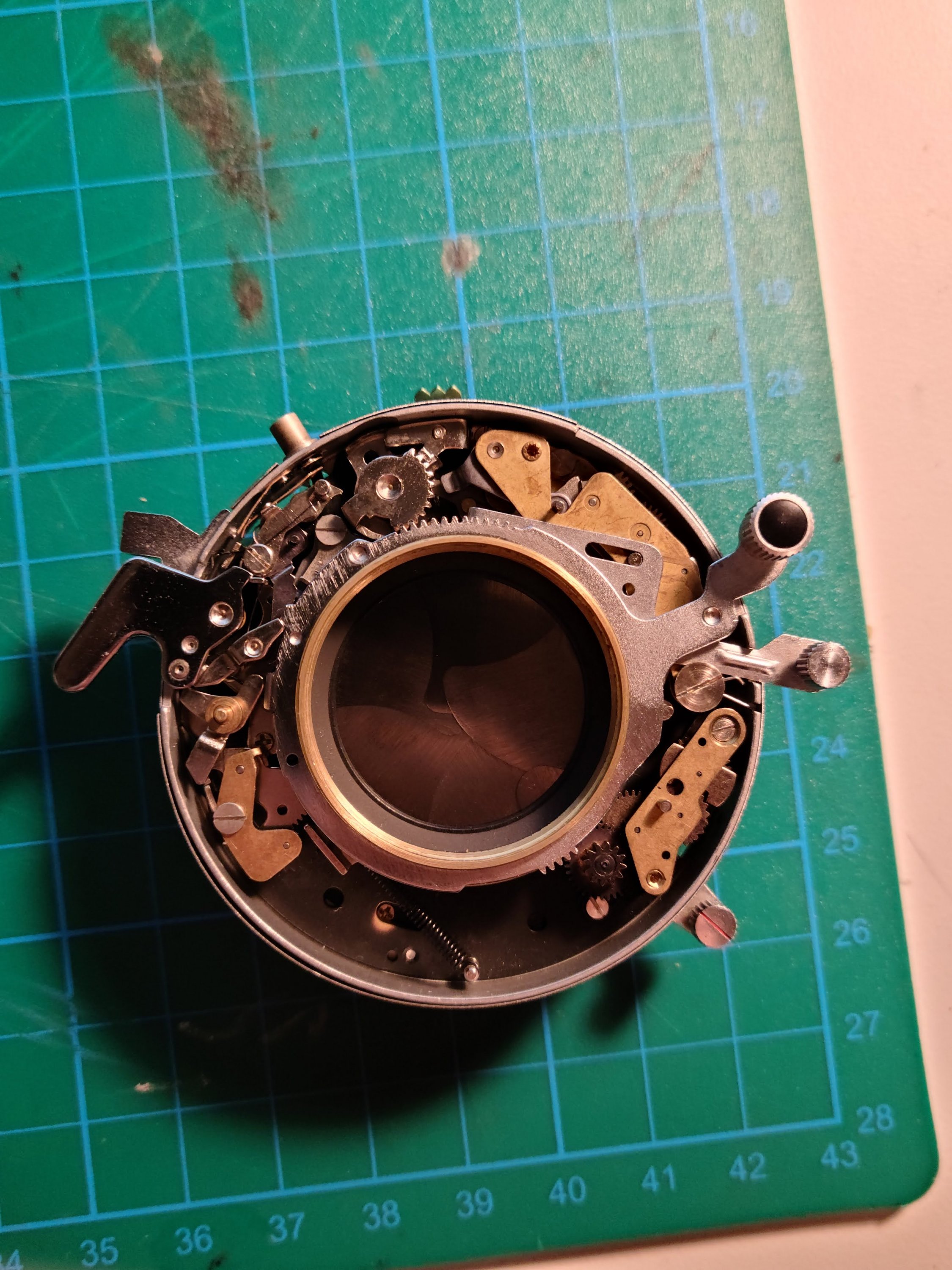

I started rebuilding the other Seiko 0 I got with the lens and it's pretty different on the inside. There's no flash sync so it's very empty inside and easier to work on IMO. I now see how B is enaged. Part 730-2028 is rotated counterclockwise and latches on to the blade actuating ring. I'm not sure if it's spring pressure from 110-1012 that rotates it or from being pushed by 730-2010. perhaps if someone knows they could clarify.
