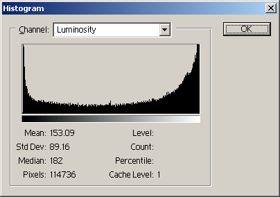

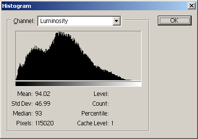

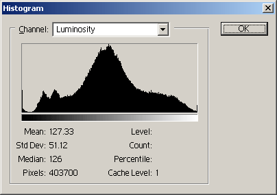

Andy, a histogram shows a ratio and spread of the "colours" in an image. From it you can see if your scanner is doing a reasonable job.
Here's a couple of examples from different images. I tried writing explanations for each but I think they we more confusing than helpful. Maybe someone can nominate a site with a good explantion. www.scantips.com used to be a good read for these things (I haven't looked at that site for ages)
