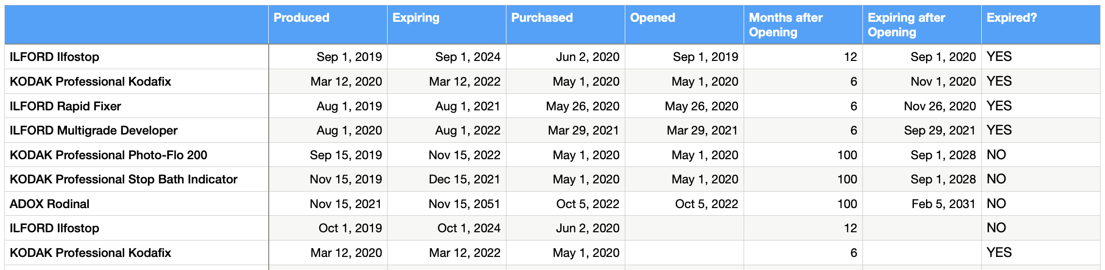

I made this table with the chemistry I currently have. I couldn't find info for Kodak Photo-flo and Indicator Stop Bath, but I read they can be stored for a really long time, so I put 100 months, just for the formula.
Basically, most of my chemistry has already expired, but I don't see it affects my negatives. Do you think I should refresh it with the new one, or am I good with this?
Last two are not opened, so that's why there's no date in the Opened column.
Ilford and Kodak are quite conservative in their lifetimes of (un-)opened (half-)full bottles.
