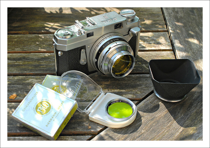

My pleasure. If you are looking for Konica accessories, look for Konifilter & Konihood (The size of the push-on cap/hood is 36.5mm I believe).
I use B+W filters 35.5mm and a nice rectangular metal lens hood by Ihaggee (screw-in 35.5mm).
I also have a B+W push-on hood and a push-on cap by Heliopan (not in the photo) - both have 37mm.

A great camera to use, the cocking system is a delight, shutter release is sweet, large rangefinder window & bright, incredible lens. What's not to love? Original KONIHOOD and its leather case with a 35.5 mm filter on the lens.
