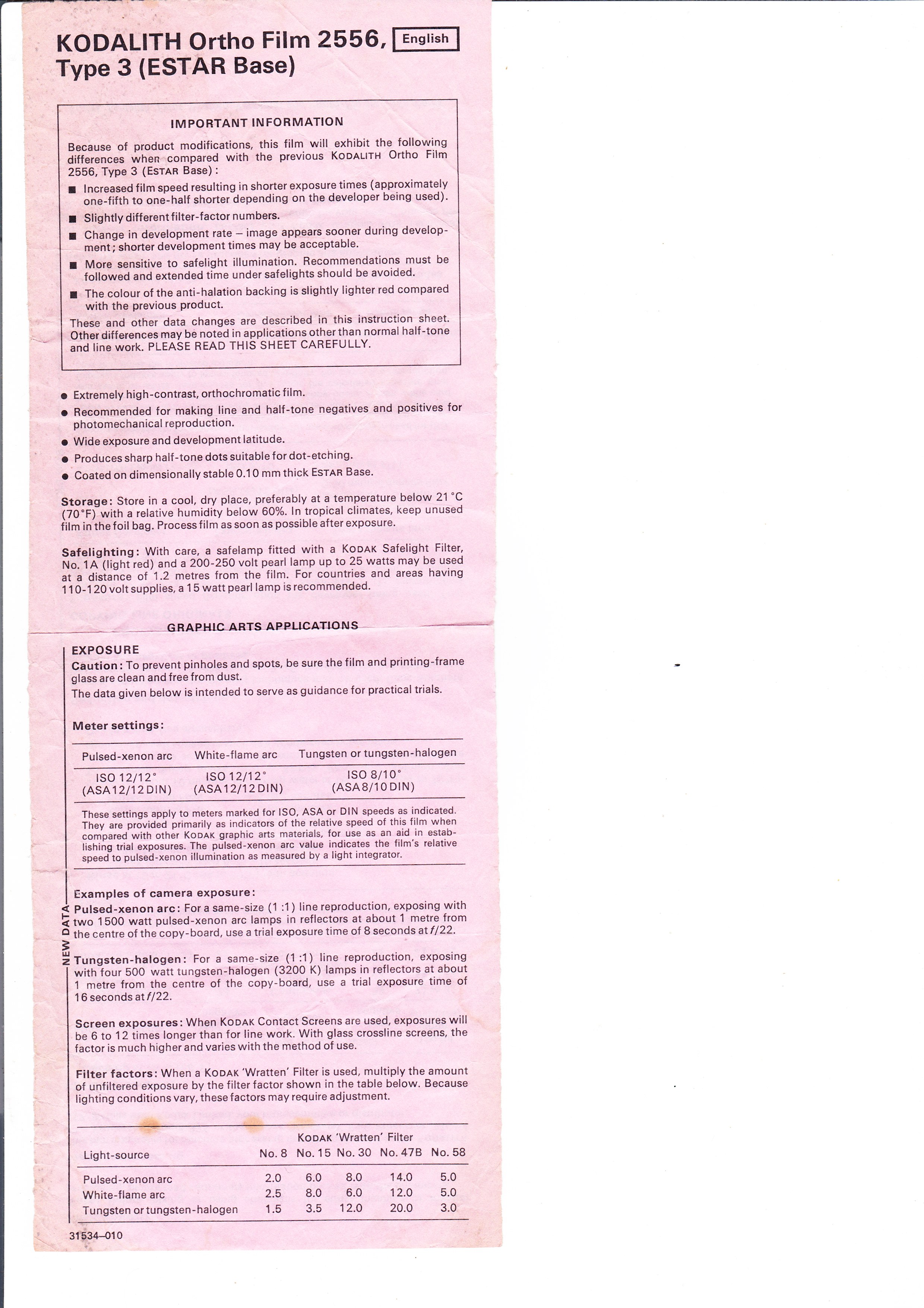

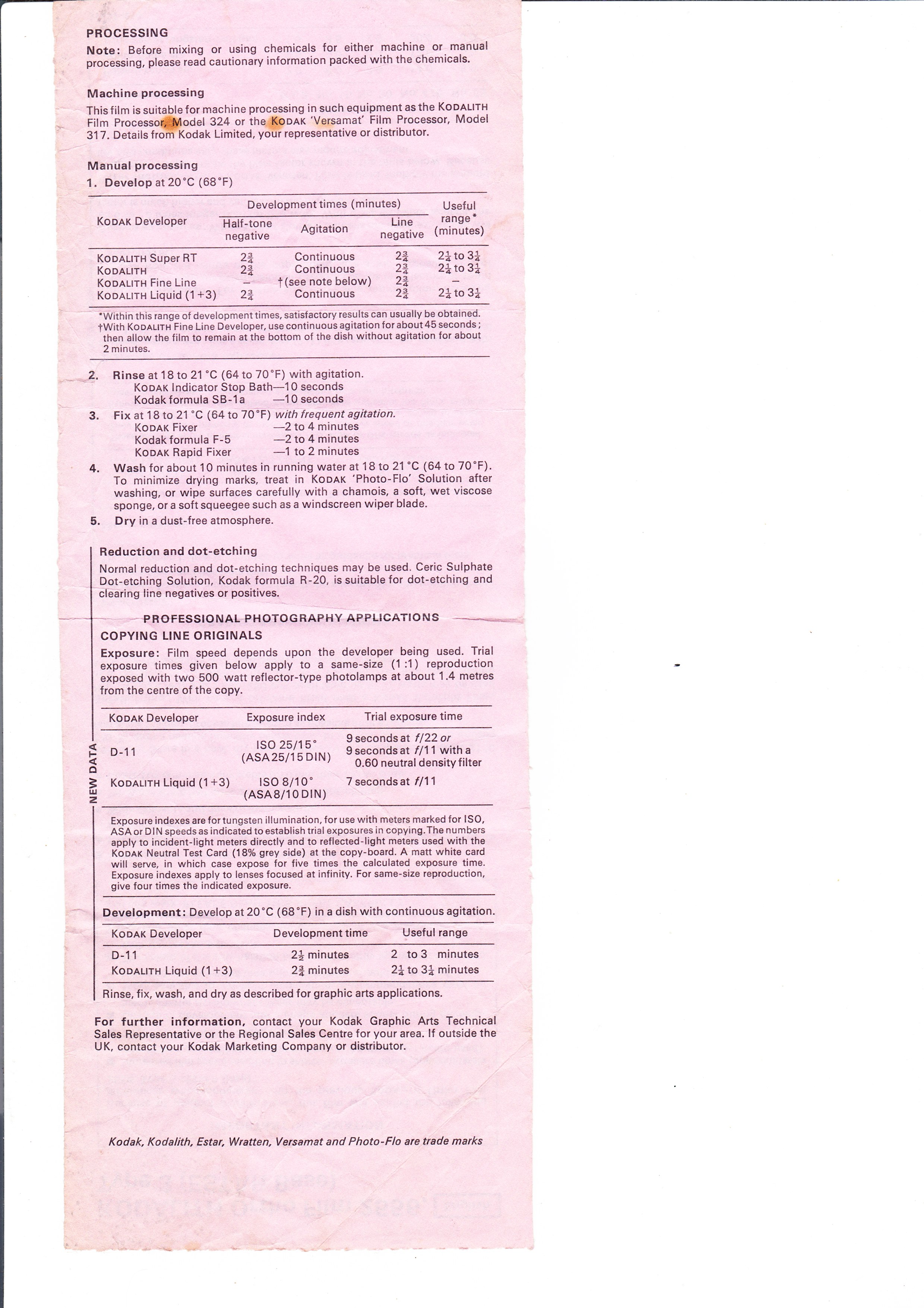

I dabbled with lith. film in the early 1990s.
I have just trawled through my old folders of leaflets etc. and found this Kodak instruction sheet. This one dates to 1992 when I had a few lith. photos printed in photo magazines.
Read the Modification..."IMPORTANT INFORMATION" in the first box. It refers to increased film speed.
I used the Kodak Super RT developer, it was expensive even then.
Hope the leaflet is of some use.

Thanks for the leaflet scans. Are there any more pages?

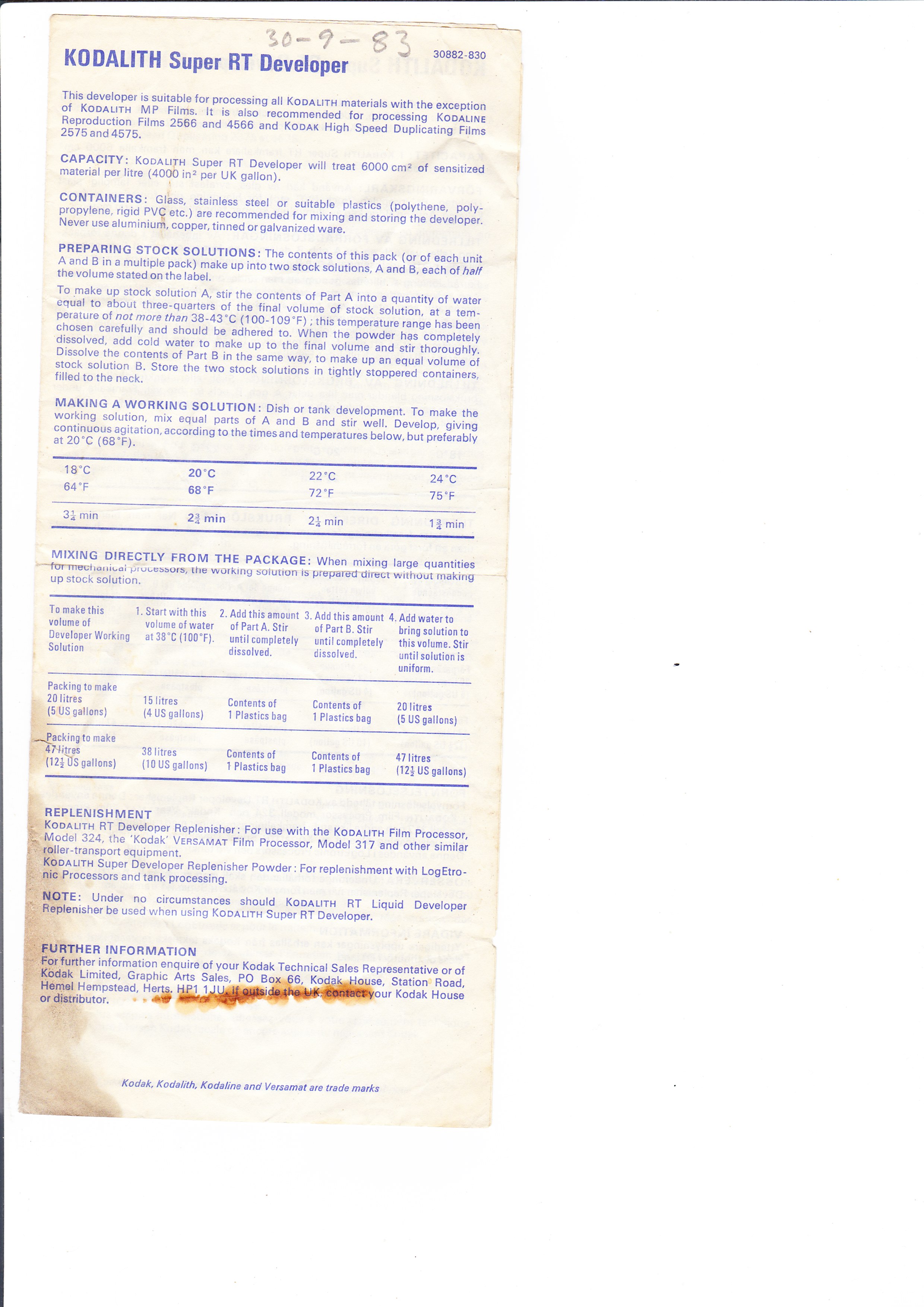

Sorry henryyjjames the other pages of the leaflet are the German and French versions.
However I have found the leaflet for the developer I used.
If the date I wrote on it is correct, I was making lith. negatives a lot earlier than I thought.
It may be of use to someone in the future.
