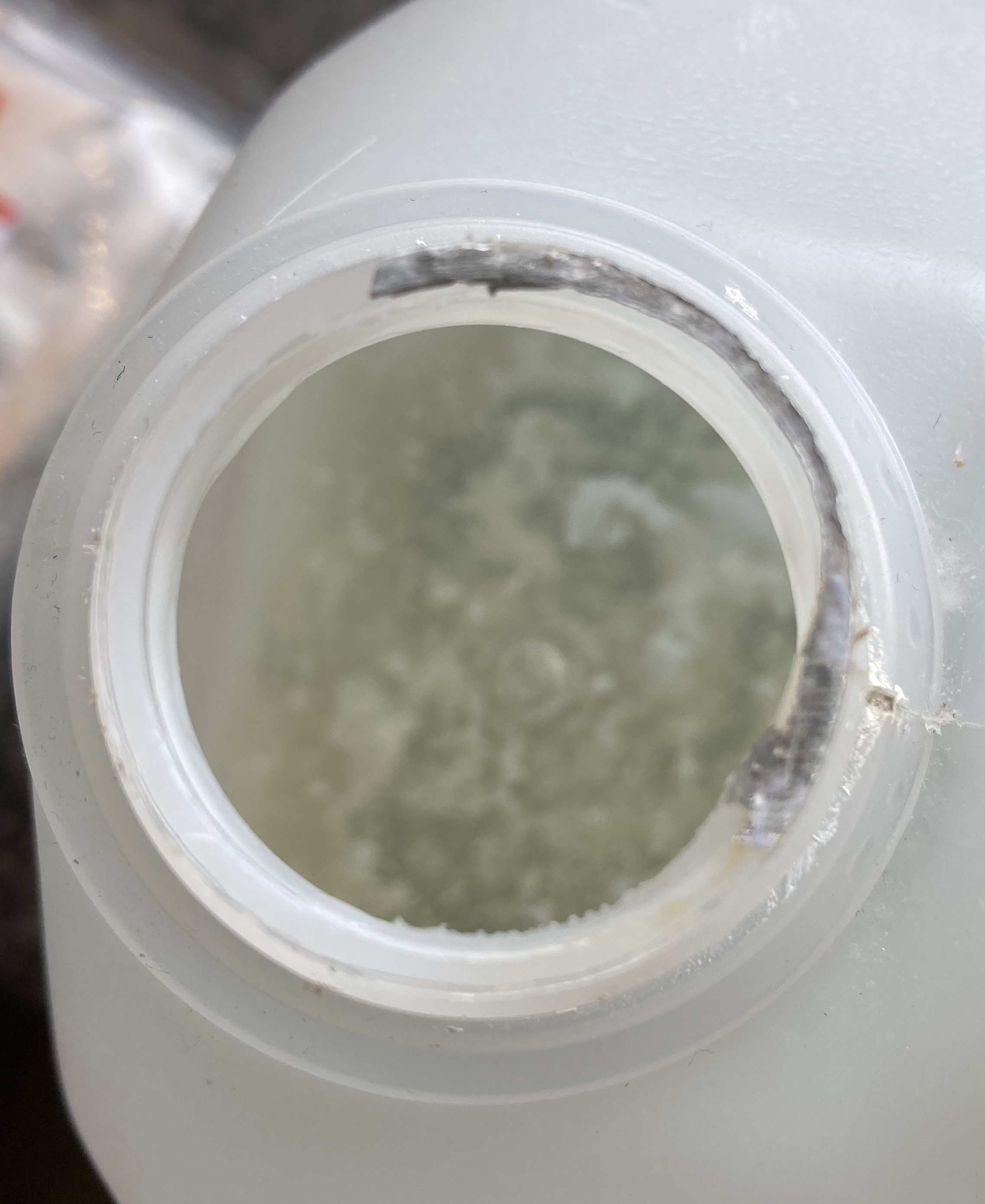

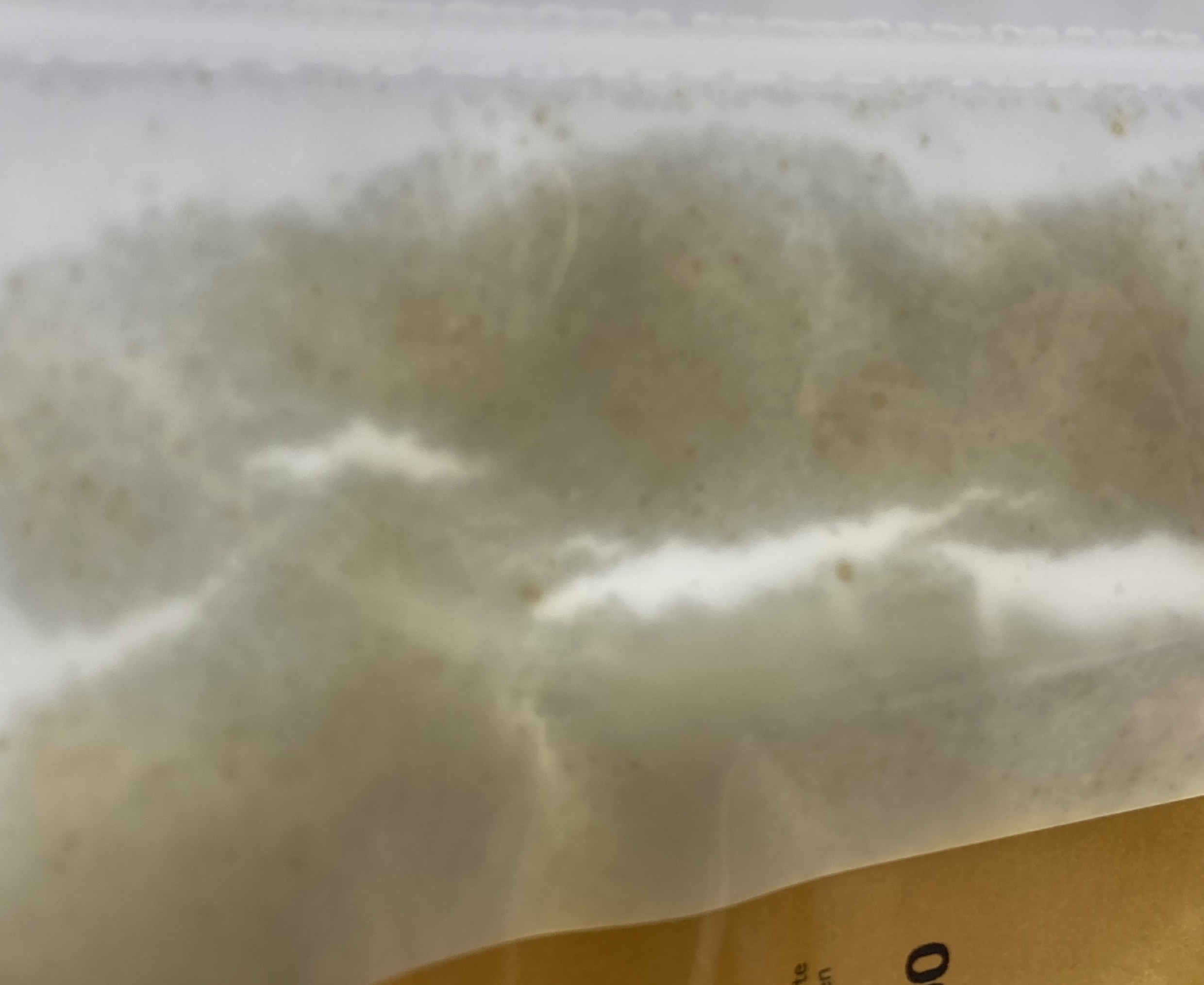

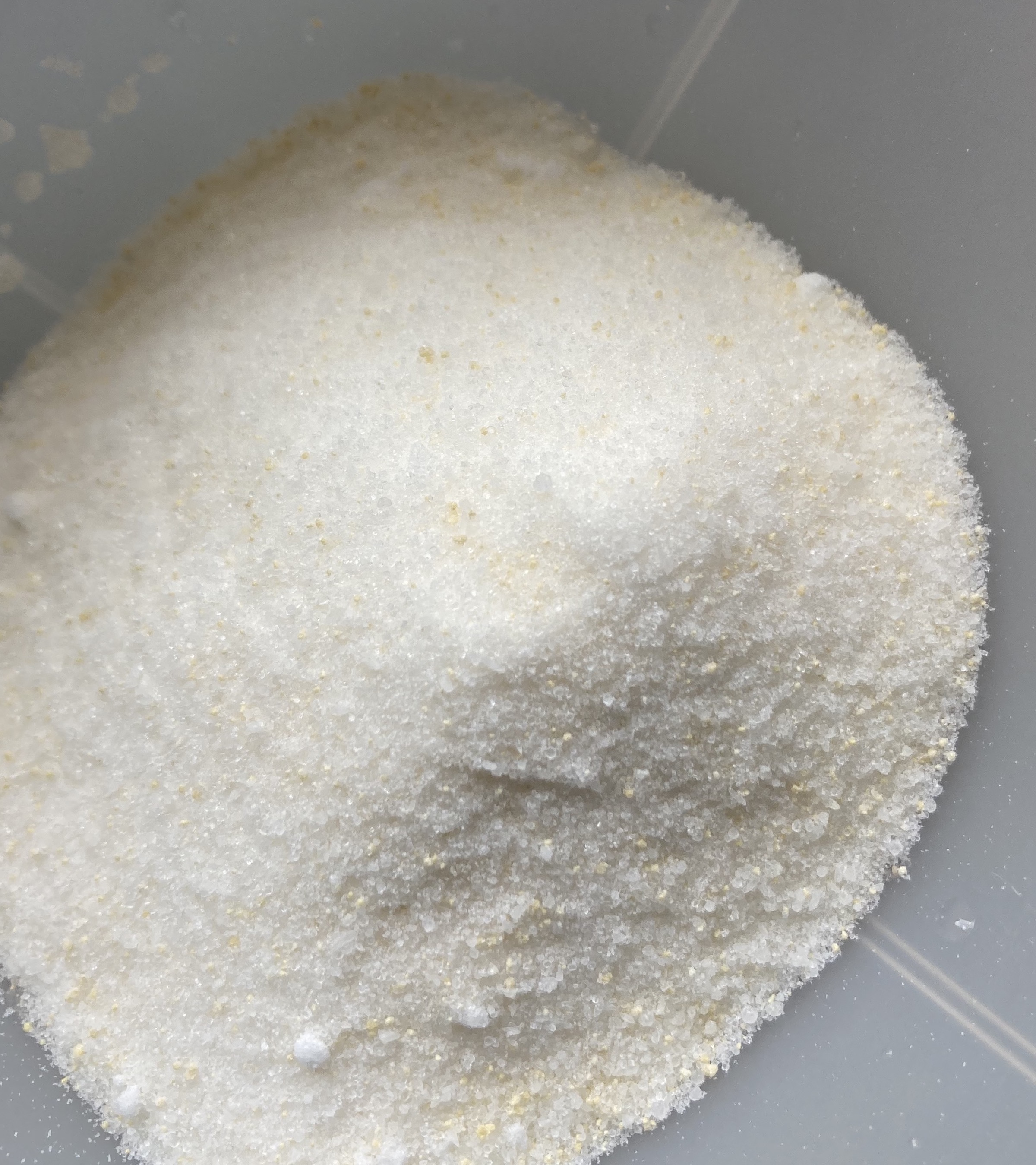

I finally decided to just mix up my bad XTOL and see what happens. I gave up waiting on Sino Promise and bought some ADOX XT-3 which I will use tomorrow in place of this definitely bad batch. Thought you all might be interested... there is definitely something wrong with the batch of XTOL they reported publicly.
The following pics are Kodak XTOL to be clear
This is what the part A looked like in the bag. Note the clumps and brownish color:
That's not normal. This is what it looked like out of the bag:
I was not able to get it to fully dissolve. Just wouldn't. Whatever happened to it to cause that tan clumping also won't dissolve.
After a few weeks sitting, mixed up, this is what I found (sadly it was blurry and I didn't notice until after I dumped it):
Looked like mold floating in there. Never seen that much of it before, though!
What temperature did you mix it at?

I’ve mixed many many batches of this. Assume that I did it properly :smile:. It doesn’t normally look like that, it normally dissolves just fine, and it doesn’t look moldy like that after a few weeks. My suspicion is that there is already mold in the packet. Since @Andrew O'Neill has a pack that is fine from this batch it must not be all of them.
My bad Xtol bag (weak, undissolved particles) looked just perfect: shining white powder.
