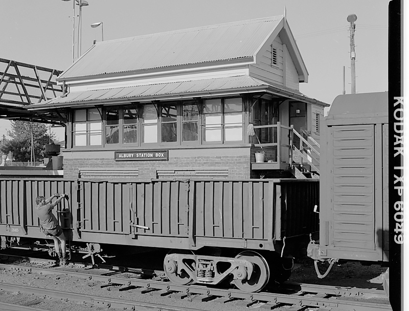

I'm not sure what I "don't get". Tri-X Professional 320 (TXP) was available in 120 for many years but has not been available in 120 for a decade or two. Just to be clear. In the 1980's Kodak produced, in 120 format, TX (400) and TXP (320) If you don't believe me have a look at AA's book "The Negative where he talks about 35mm TX and 120 Tri-X Prof. The 120 TXP was, as far as I could tell, the same emulsion as TXP on sheet film. TXP on sheet films was obviously on a thicker base. My observations for 120 TXP are perfectly applicable to TXP in sheet films as I believe they had identical characteristic curves.
That being said, the way Kodak have changed TX over the years I wouldn't be surprised if they have changed TXP which would mean it's a very different film to what it was 20 years ago.
Attached is a scan of a 120 neg on TXP film. This neg has been printed to 11' x 14" with no discernible grain.

markbau, well, your 11x14 pic looks pretty grainless to me, even in the lighter sky areas but of course it is a scan and I suppose you can do anything with a scan :D
pentaxuser
markbau
Apr 16, 2009
869
Australia
Analog
pentaxuser
I just posted this scan to show that TXP was once available on 120m film. Apart from a curve adjustment, nothing was "enhanced"
