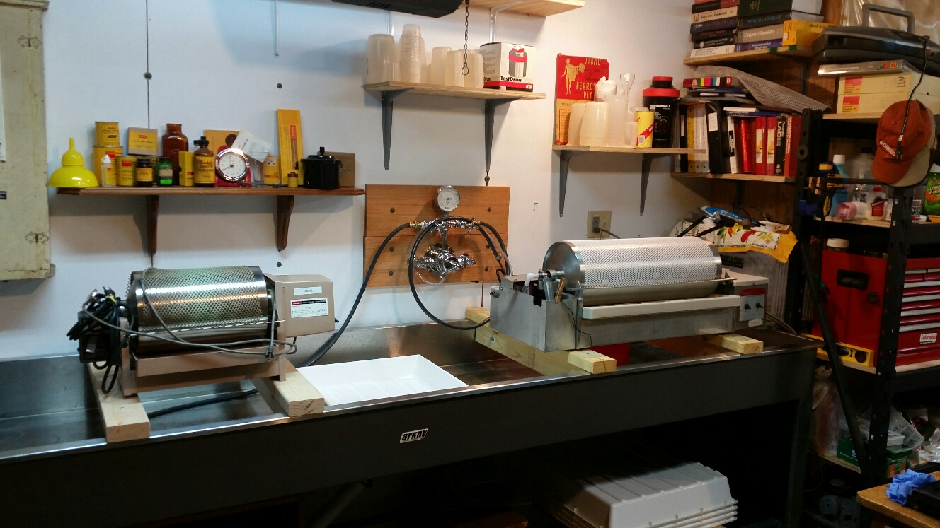

View attachment 215044 View attachment 215045
Fantastic someone is using these, I loved working on the K16 I think this exact unit drove in the love of printing ...Very nice to see.

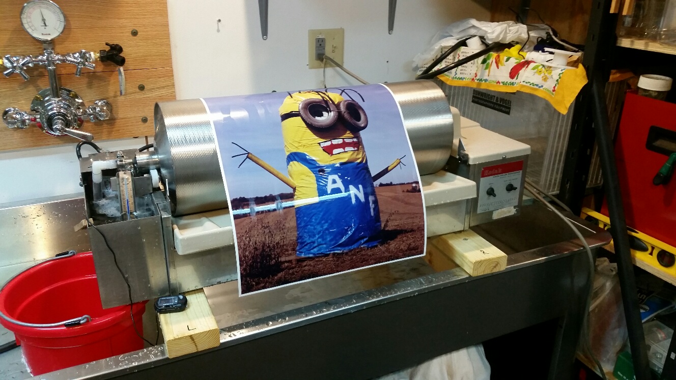

If you ever want to sell the unit on the left , please do not hesitate to call me , I think it would be a super cool unit to have in my space.

I got my Heath Color Canoes - 8x10 and 11x14 in 1969, I think, and my H11-L in 1970. I still have both, and occasionally use both, just for fun. I get good results with the Color Canoes, but learning to use them was a bit like developing a good golf swing. It takes regular practice to get consistently good results. I can easily waste a print or two, trying to get my "mojo" back. If my thumbs aren't right on the center-line dimples, the canoe will tip to one side, and one edge won't get wet. Doubling the volume of solutions used can help with this. (2 oz -> 4 oz per 8x10).
The H11-L consistently gives a good first print, but if I'm running a single 8x10, I can't reduce the volume of solutions for the smaller print size. I still need the full 4 oz. whether it's an 8x10 or 11x14. I have two nets for the H11-L, so I can use one while the other dries. The second net was a really good purchase decision.
bentbikr
The recommended dosing for the model 11 is 4 us fl. oz. 120 mL. This was based on CP-5 chemistry and fiber Ektacolor professional paper. I use 90-100 mL with RA-4. I buy RA4 Developer and Blix in 10 liter batches, very inexpensive . After I do a final wash on the machine of 1 1/2 - 2 minutes, the blanket is clean, I put it into the pre-soak tray ready for the next print . I run at 100F, 45s Dev, 30s stop bath , 45s Blix , 1 1/2 min. minimum wash, squeegee then run through an Ilfospeed dryer that dries a 8x10 in about 10 seconds.
I use Thomas safelights with the DUC color filters, after your eyes adjust you can see the machine. I've never had a problem with fogging the prints. I am careful but I 3 of these safelights going. Indirectly bouncing the light of the ceiling.
Way faster than tubes. Only thing better is deep tanks and you need to be printing a lot more (unless you have a slot setup) I have heaters so temperature is steady, no water wasted. It's a fun and archaic experience. I hope color printing stays around for a long time, but I wouldn't bet on it.
Best Regards Mike
PS my canoes are the Honeywell Nikor rocking print trays, similar to the Color Canoe, not quite as dramatic of a curve.
