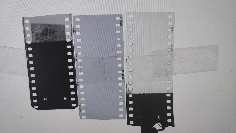

I wish they'd shift their B&W films to Estar, with the more-transparent base (at least, in my observations).
I've heard arguments over acetate vs. polyester and base fog, but when you put any of the films together (B&W only), the differences are stark. I don't know if they intentionally add more fog to TMAX to keep the contrast under control, or maybe that's a limitation of the emulsion?
Any of the Aviphot film bases make TMAX appear murky, when compared side to side (and I hypo-clear and rinse all of the pink out!).
Left-to-Right: TMAX 400, Kentmere 400, ADOX HR-50
Most Black and white films are made on A GREY acetate base. this acts are part (or in some cases ALL) af the Anti-halo system.
Typically one of the other methods is to use an Anti-Halo dye, eithers directly under the emusion (typically called out as "AHU") or on teh back of the film. the Dye is designed to become colour less, or dissolve during processing. The T-max I have used seems to have an AHU dye as well as a grey base. In my days doing Microfilming all of the film I recall seeing for that purpose was made with AHU technology..
Many colur negative films use a silver AHU layer, which is cleared when the film goes through the Bleach. That has also been used in some B&W reversal films, and those cannot be develped as a negative, again the silver layer is cleared by the bleach step.
Kodak's Ultimate Anti-Halo solution is the REM-Jet used in the ECN, ECN-2 and Kodachrome process. But that requires that the process have special steps to remove the rem jet without contaminating the Image.
120 film quite often uses the dye on base method, and that is why some 120 films turn the developer Bright Green or Purple. I recall that EFKE 35mm film also had the dye on the base.
rest assured that NO one delibratly fogs film for Anti-halo purposes, for one thing the fog would only apper after development when the Anti-Halo effect was no longer needed.

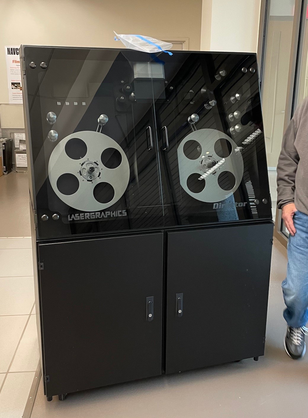

No doubt. We installed a 10K Director from Lasergraphics Director last year and it's stupid over-kill for archival footage.
This has devolved into an ego game of "numbers"; bragging rights to resolution, which makes no sense.
When you get above 4K, you are essentially storing very expensive noise.
Now some wags are hawking a "Multi-Spectral" Scanner that scans in all wavelengths of light, including infrared. All the fan boys are salivating over this idiotic machine that takes 400MB and 2 minutes per frame to work it's "Magic".
That's 6.3 terabytes per 1000 feet of film, which is 10 minutes running time at 24fps.
