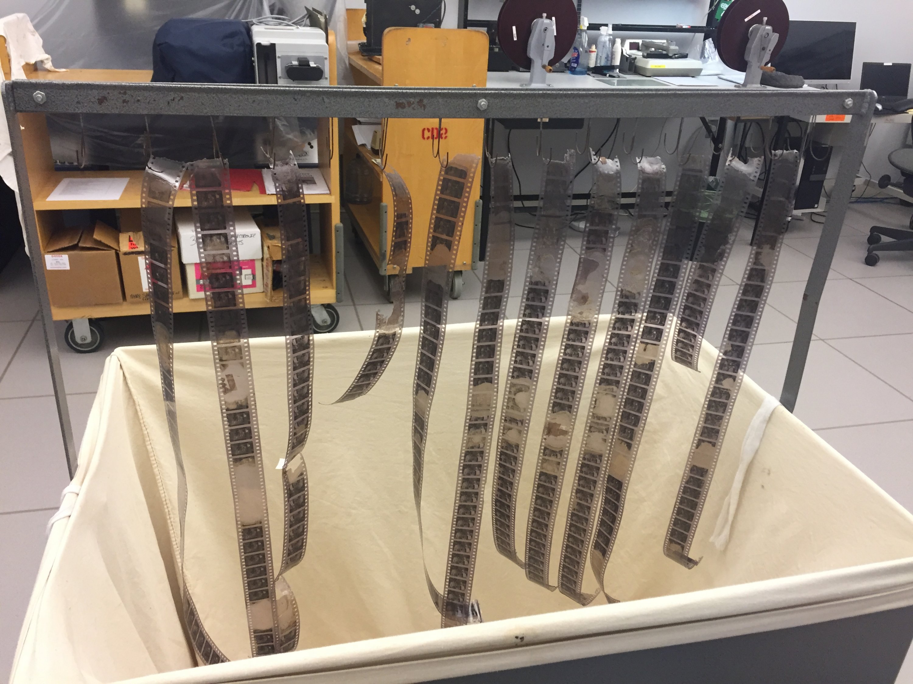

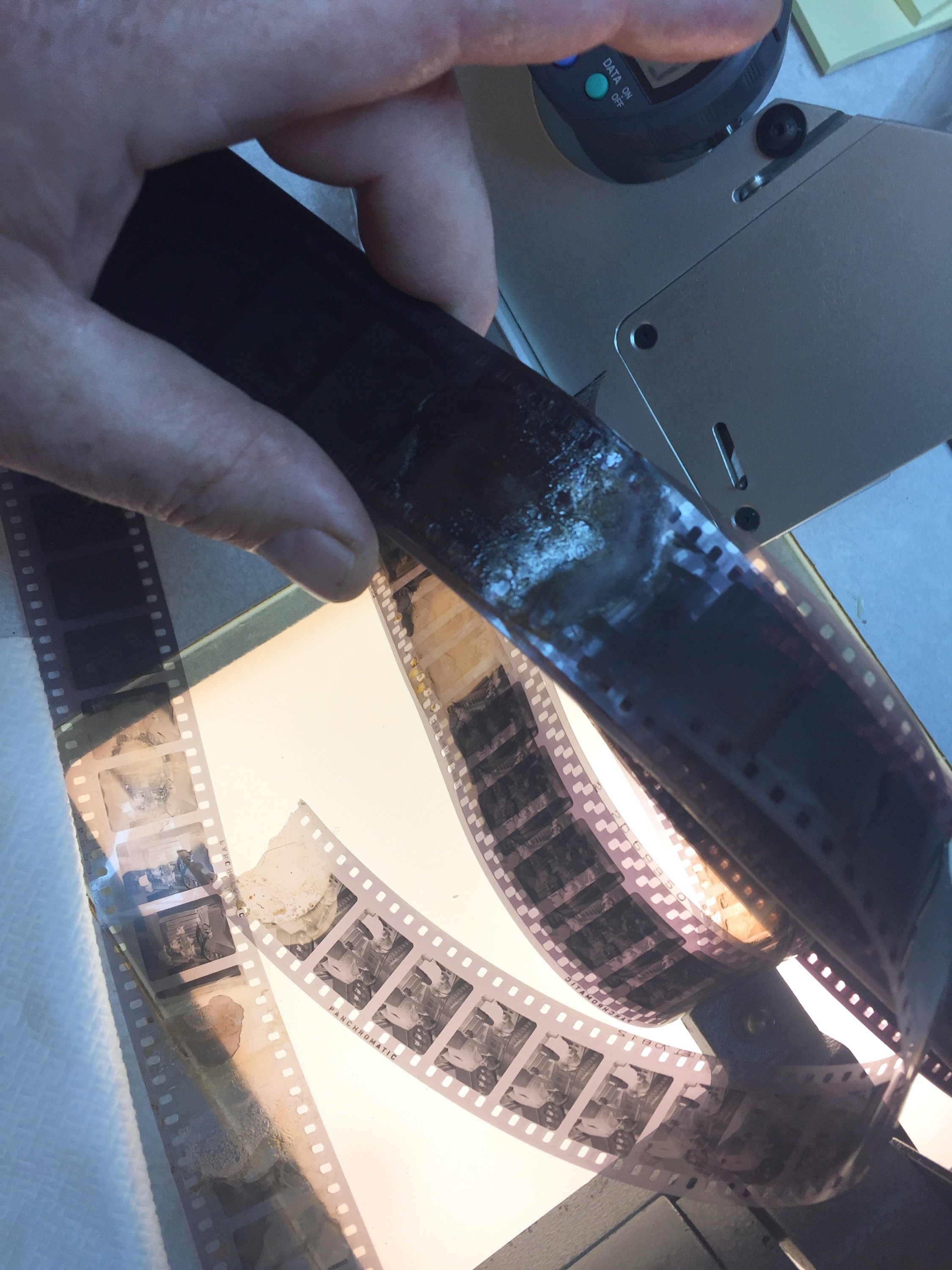

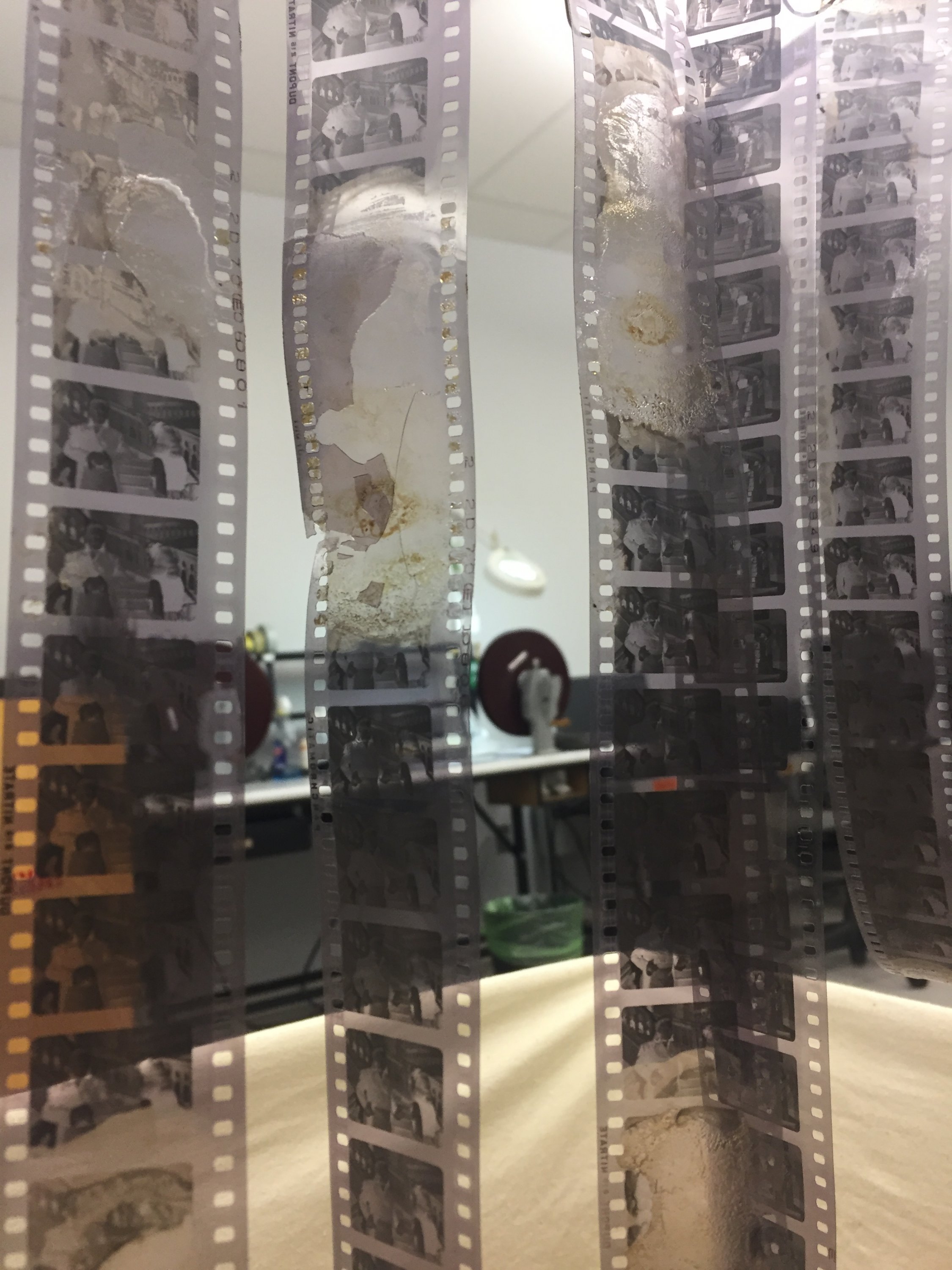

No matter the base, it has been my experience that the emulsion goes bad and takes the base with it.
Here is a sample of 1946 Dupont Nitrate Original Camera Negative film that was inter-cut with Eastman Dupe Negative stock of the same vintage (for opticals). I was able to pry it apart and wash the decaying emulsion off of the base in spots to stabilize the sections for copying. The image was gone on those spots anyway, so it mattered not that I took the emulsion off, but the base below it was usually in good enough shape to repair and run on a scanner or printer.
Nitrate rot has the lovely smell of chlorine bleach and rotting flesh, so imagine the fun seen here!
