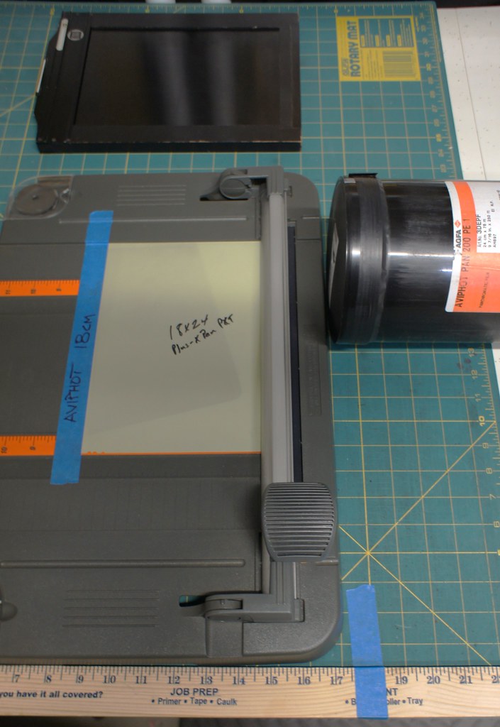

Per Jim's request, here is the breakdown.....
A 5x7 sheet final cost 35 cents each. I can get 600 5x7s from a 350 foot roll.
A 4x5 sheet final cost 20 cents each. I can get 1,050 4x5s from a 350 foot roll.
SONY DSC by Nokton48, on Flickr
This is the Fiskar Cutter Jim Galli directed me to. Bought cheaply on Ebay, got four new 45mm blades at the local fabric store. Great cutter! I see why he likes it! Here is my cutting setup, set up for cutting 18x24cm sheets from the huge roll of 24cm Agfa Aviphot. Same emulsion as Rollei 400s, basically. Identical if not the same. Has some slight Infared effect that is very pleasing. I've been shooting this film as Rollei 400s in fresh 70mm, and I like it. Between the Mammo Film, Agfa Aviphot, and Fuji HRU I am all set for 8x10 size shoots. Something I can do in winter times. I have eight 18x24cm original olde wooden Sinar Film Holders that are perfect for shooting this stuff. If I contact print on 8x10 paper, it makes a nice wide black border that I like.
Of course I have to spin the plastic cylinder of film so it is oriented for easy cutting. I will set up some wooden stops to hold the biggie roll so it doesn't slide around in the dark. That's about it for now
The Fiskar's blade goes into 45 pivot mode so no way to scratch the film. Good design
FWIW I simply put the spool in an 11X14 tray a few inches away and it just friction rolls against the edge of the tray. 18X24 is brilliant. The 24 is already done, just roll out 18cm and cut
