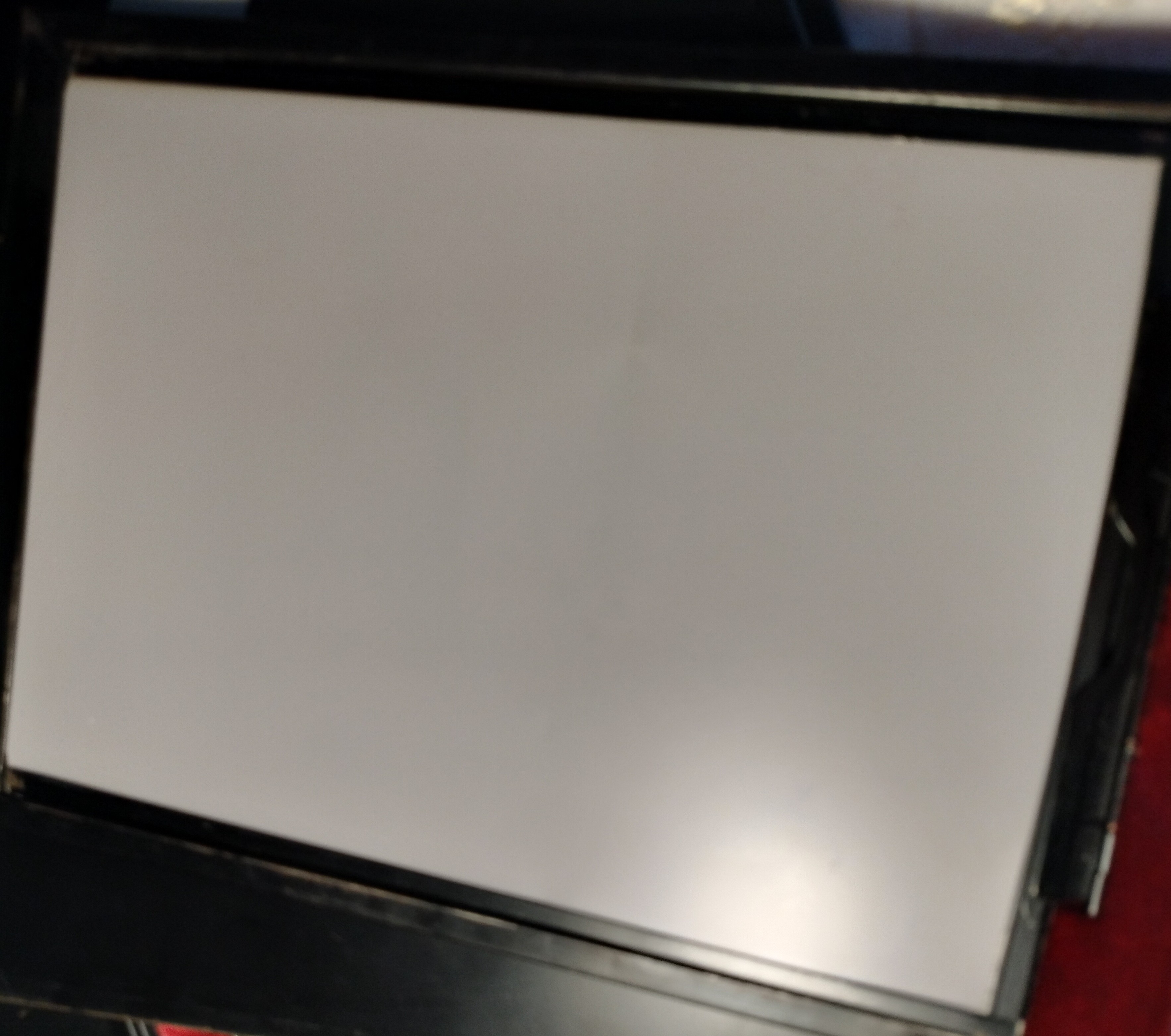

My finest film holders in 4x5" are these Linhof Film and Plate Holders. They appear to hold very tightly the slightly thinner base 2402 Plus-X Aero cut down sheets. Indeed very tightly and completely uber flat. I used these holders a lot shooting landscapes long ago, and these holders are deluxe in every way. And each has a lever, to eject the sheet partially out, when unloading. Yay. No scraping up the sheets fishing them out of the holders. I use a scrap 4x5 sheet to set up a masking tape stop which I can easily find in the dark.

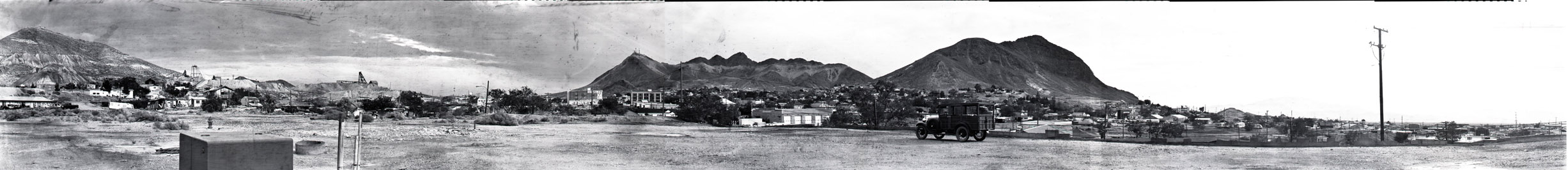

Here's an image done on 3404 Plus X which is the same as yours but thinner substrate so they can cram 1000 feet on a roll. This is 5" with the perf's. I don't treat it any different than ordinary Plus X. Shoot it at 125. This image was the first test with a new to me Cirkut camera so it's pretty rough and reddy. Developed in a 4' long piece of 2" sewer pipe. Pyrocat HD. Nice sharp image if I can clean up the other damage. Developed last Saturday so this is real time. Would love to trade someone or buy some that doesn't have the perforations. Not helping anything in the Cirkut camera. 3404 is 3 mil. Very thin stuff.

"Here's an image done on 3404 Plus X which is the same as yours but thinner substrate so they can cram 1000 feet on a roll. This is 5" with the perf's. I don't treat it any different than ordinary Plus X. Shoot it at 125. This image was the first test with a new to me Cirkut camera so it's pretty rough and reddy. Developed in a 4' long piece of 2" sewer pipe. Pyrocat HD. Nice sharp image if I can clean up the other damage. Developed last Saturday so this is real time. Would love to trade someone or buy some that doesn't have the perforations. Not helping anything in the Cirkut camera. 3404 is 3 mil. Very thin stuff."

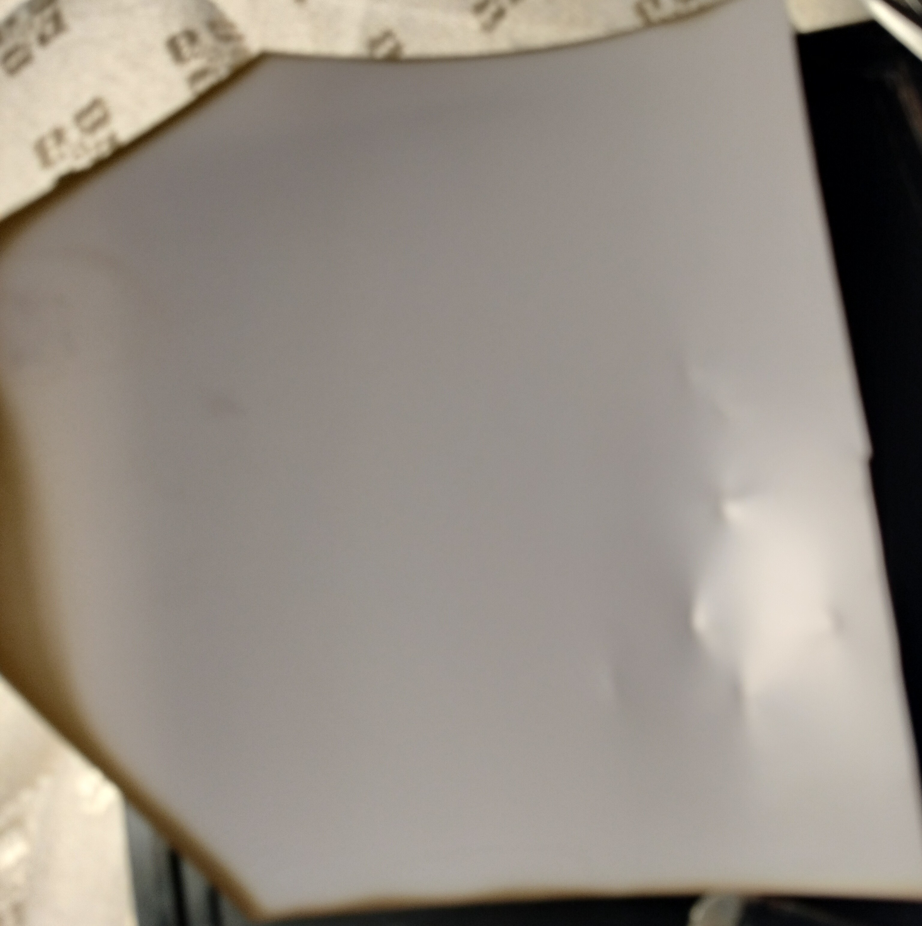

Fits perfectly. And look. NO PERFORATIONS. It's the 2401 expired in 1970. I got it for $60 350 foot roll

Same coloration as my 2402. Next I'm testing D23 1:1 as that worked great previously for me with 70mm 2402. Just sulphite and metol. Soft working this can be a contrasty emulsion
